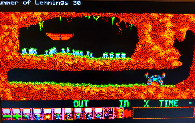

This is what it looks like on the Amiga:
Edited 2026-08-20 01:48 by Martin H.

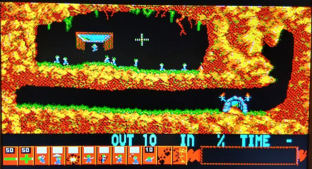

This is what it might look like
'no comment

Hi Martin,
The new HUD is a major improvement.

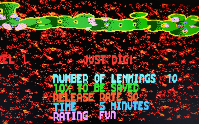

In normal gameplay, an info card appears before each level, describing the level. That is precisely when there would be enough time to reload the elements and tilemap for the next level. In the game itself, the rules for the individual Lemming types, which the programme processes, are only ever needed up to the next step.
So, for example, if a ‘Walker’ realises it no longer has any ground beneath it, it would fall (this is entered as the object type for this sprite, and the y-position is used to determine, upon ‘impact’, whether the Lemming survives or might even have a parachute). etc.

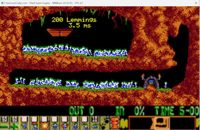

Nice, You’ve used the full-colour PNGs
Here is a little Video of the Pico Demo
I don’t have CMM2, but with a few minor tweaks, your script will also run in mmb4windows
'MMB4W

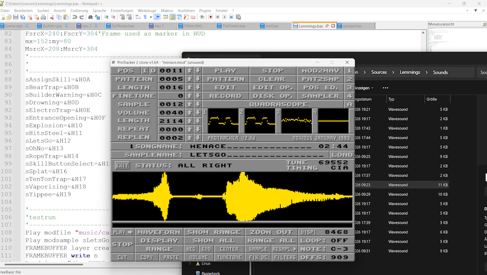

I’ve summarised the music here and added the sound effects
'                     SoundFX Samplenumbers in MOD
sAssignSkill=&H0A
sBearTrap=&H0B
sBuilderWarning=&H0C
sDrowning=&H0D
sElectroTrap=&H0E
sEntranceOpening=&H0F
sExplosion=&H10
sh*tsSteel=&H11
sLetsGo=&H12
sOhNo=&H13
sRopeTrap=&H14
sSkillButtonSelect=&H15
sSplat=&H16
sTenTonTrap=&H17
sVaporizing=&H18
sYippee=&H19
It was a durty job, but someone’s got to do it
Music.zip
EXCEPTIONS
sfx.mod no music, only the SFX
awesome.mod,beastI.mod,beastII.mod and intro.mod just Music no SFX

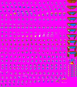

In addition, the animations for entering and exiting have been added to the sprite sheet
Martin
Edited 2026-08-28 05:12 by Martin H.

Here is the summary, i.e. the mapping of the individual sprite types to the coordinates on the source image
Sourscoordinates:
lem,0=xrright,lem,1=yright
lem,2=xlleft,lem,3=yleft
lem,4=Number of Animationframes

Posted: 01:51pm 02 Sep 2026
Even though it looks almost the same as before, the game now uses the Lemmings’ actual controls.
Mouse control also has been added
Some of the Lemmings type functions are already built in.
(For more details, have a look at the Sub move_lms )
Lemmings.0.2.0.zip
That’s the basic framework of how the game might work.
For the different levels, I’m looking at the NES and Sega Master System versions, as both systems use tile-based backgrounds – which is what could be done on the Pico using tilemap.
framebuffer F is no longer used, as the display output is fast enough. You can use the mouse crosshairs to determine how long the flickering lasts. On the Pico 2 (252 MHz), the slight flickering stops at around the level of the entrance.
Martin
Edited 2026-09-03 00:16 by Martin H.

Posts: 6195
Posted: 07:06pm 03 Sep 2026
Hi Martin,
Looks amazing...You are a wizzard !!! Now I have to get my Aegon VGA unit out, since ti has mouse support.
Playing it atm on Mixtels PicoGameVGA unit.
I'll take a closer look on what you did this weekend probably (with the Aegon unit).
Volhout..
Edited 2026-09-04 05:50 by Volhout
Posts: 6195
Posted: 07:06am 04 Sep 2026
Hi Martin,
Some early feedback.
1/ You are using 2 variables (snum and lmax) for the maximum number of lemmings. This confuses, because you can spawn lemmings(lmax) that never get animated (snum).
2/ You have a loop time of 50ms (set by tt). Despite reserving room for 80 lemmings, with 30 lemmings you run out of time already. Maybe I should dive into the code deeper to see where we can save time.
But you already defined the full framework for the game. So it should not get any worse than this. Every lemming is displayed, and every lemming went through its behaviour rule check. So regardless the lemming type added, this should stay roughly the same (except when they start digging, and scenery must be adapted as well).
I still have to check with a unit that has a mouse.
Edited 2026-09-04 17:10 by Volhout
