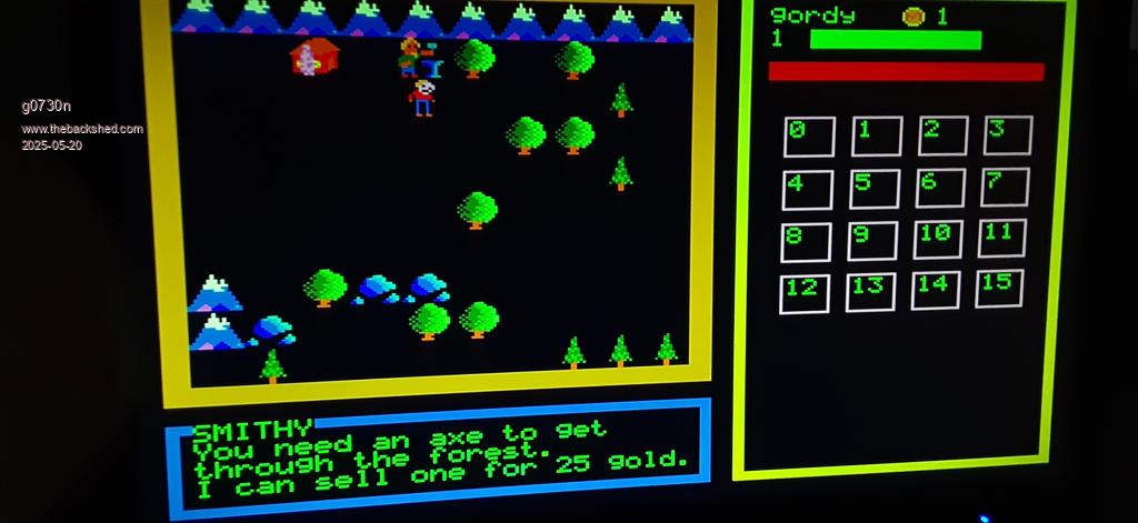

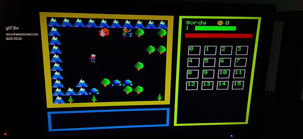

G0730n,
What is that game you are showing on the VGA monitor 1 page back. With the house, and coloured blocks.?

volhout, the case I printed has some venting, and I intentionally added some slits right next to sensor to allow air to flow over it. Seems to be about the same as without a case so I think its working  Also the game on first page was the beginning stages of the game I am working on now. In that photo thats about all there was just collision with blocks and move with keyboard. I will take a photo quick of what It's looking like now.

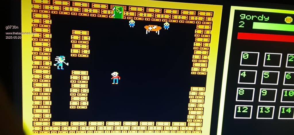

This game has a lot of influences from games I have played as well as various games I made in the past. It's basically a combination remake of 3 separate games I made years ago. It is turning out great. I am in a bad place in life right now so working on this stuff is saving my mind lol.

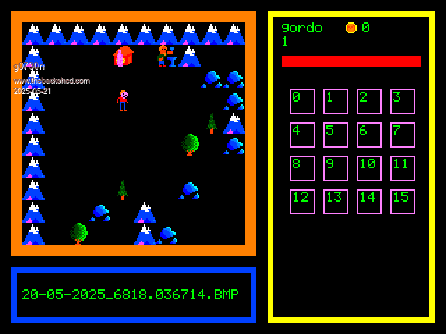

P.S. you can save your screen as a BMP with "SAVE IMAGE "name.bmp"" or "SAVE COMPRESSED IMAGE "name.bmp"" so you do not need to take photo's. During development I typically assign the <ESC> key to that function. To take a screenshot at any time in the game.

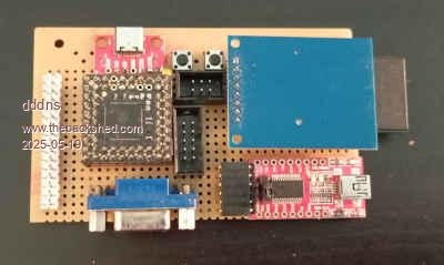

Here a very nice tinkering solution without guarantee:
RP2350 + PSRAM 8M
One more correction: It _might_ not be compatible
Edited 2025-05-20 19:57 by dddns

I tried out that Screenshot trick, it worked pretty good. The forum here doesn't accept BMP so I converted to PNG and 2x scale so its easier to see. 320x240 not zoomed in is pretty small haha.
