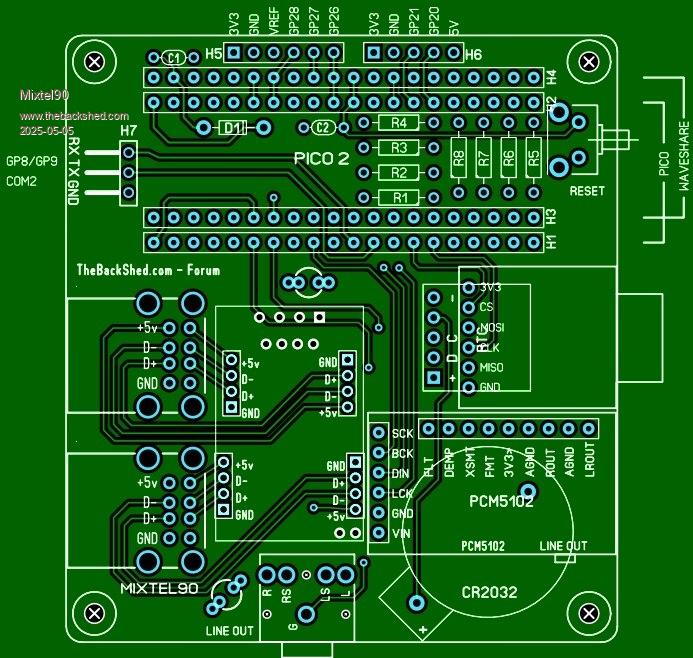

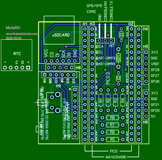

It's changed a bit more. :)
The Reset button is now on the end, with the screen control buttons.
The notch has gone and the board has rounded corners.
I now know it will fit because I've overlaid it on a photo of the Waveshare board. :)
This seems to be a reasonably priced display, which is why I'm making a proper job of the design. It might be of interest to others. An option might be a second board mounted on the lower two fixing pillars that holds the components for a 4-port USB hub or a PS2 keyboard. I've no idea how strong those pillars are, could they be used like the VESA fixings on a monitor?

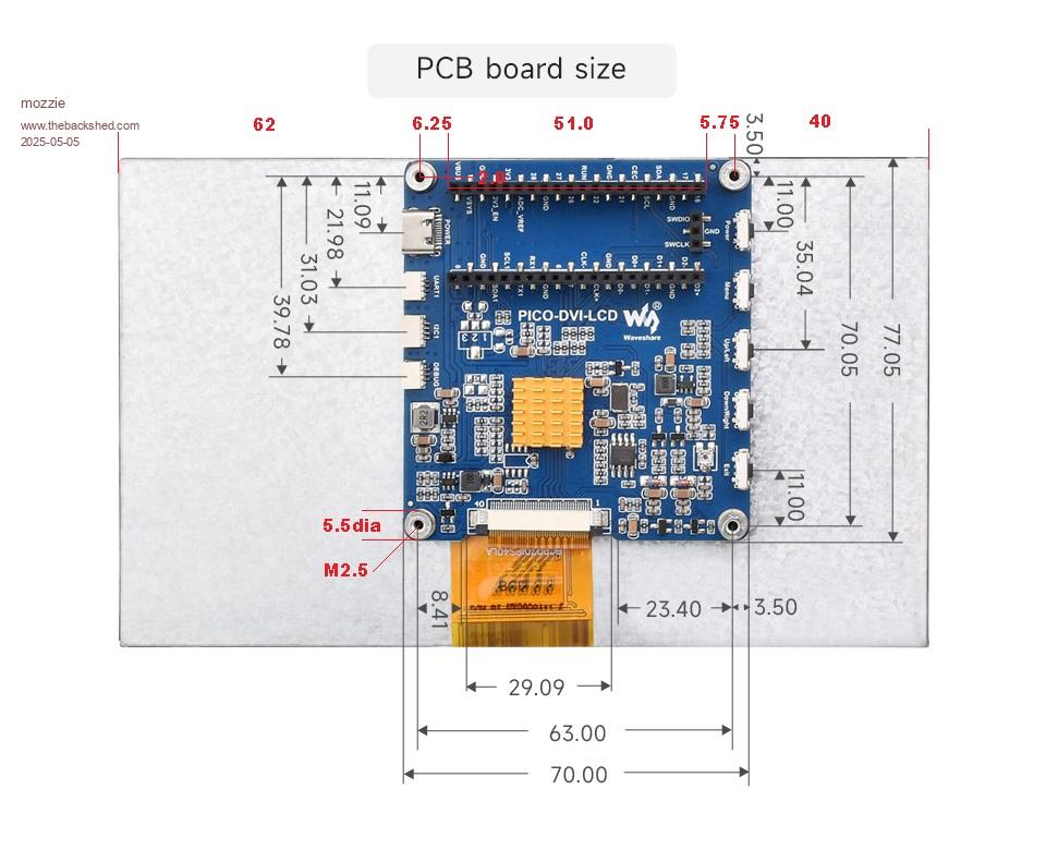

G'day, that board is looking good Mick, hopefully the following will help.
The M2.5 mounting bushes on the board are solidly soldered to it and will be suitable for mounting to, however the board is only attached to the screen with double sided foam tape, although it is pretty strong stuff and the screen is quite light.
The headers for the Pico2 on my board are slightly offset (0.25mm) to the right and the top header C/L is 2.0mm below the C/L of the mounting bushes (see pic)
Do you think it might be a good idea to make the board extend over the mounting bushes so they can be screwed together if this is going to be portable?
Lyle.
Posts: 9238
Posted: 04:09pm 04 May 2025
I can do that if you like. Just the top holes or a full piggyback board? I don't want to obstruct that heatsink too much as I've no idea how hot it gets.
Looks like it's safe enough to assume that the screen won't be hanging off those M2.5 pillars. :)  I'd want something more solid personally - maybe metal to metal using sticky pads. I was only wondering if it was safe to mount things on them or if they might be used in future.
My photo overlay isn't perfect due to distortion in the picture, but I think it's plenty accurate enough. I tried to export the pic but it won't include the scanned image.

OOPS! I got carried away...
You need a little USB lead to plug into the Pico. The other end can be soldered to the hub module. The hub plugs in, but the connectors are 2mm pitch turned tin type as I've found these to be more tolerant of the strange connector positions on the module! No links are needed for programming as you have to unplug the USB connector, which also disconnects power from the hub.
The 3.5mm audio jack may not be needed, but the one on the audio module might be a bit obstructed by the CR2032 holder when using larger plugs. SL6 has no 3D capability so it's not all that easy to visualize.
Length of the M2.5 spacers will obviously depend on the length of the long-pin female headers, but IMHO you should be looking to get at least 5mm unobstructed over the top of the heatsink. Knowing my luck standard size spacers will require a non-standard header pin length.

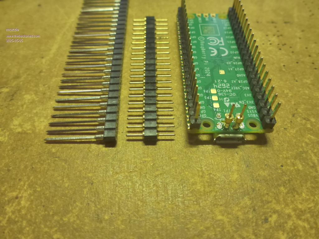

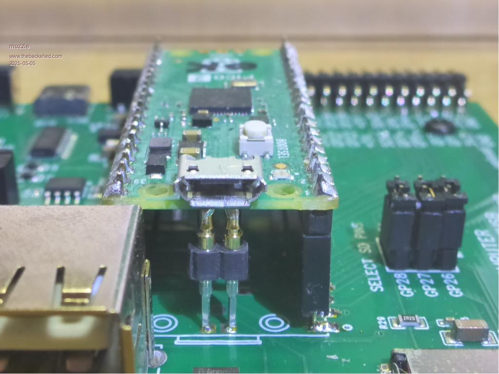

Also see below for my preferred mounting setup for PICO2 with USB, this was going to be posted in the PICO2 HDMIUSB reference design thread but not sure if you would like to accommodate it here as well as an option to using a micro usb plug.
Cut the pin off one end of the M/M header shown centre and solder to USB connections
Finished product.
The idea of soldering the PICO in and then frying it somehow (I'll find a way) makes my head hurt
Posts: 9238
Posted: 01:52pm 05 May 2025
I don't want to solder in the Pico here. There's nothing to be gained. I'd have to fit switches or links to disconnect D+/D- while installing MMBasic and there isn't much room. Unplugging its USB is fine as the plug is already behind the display and it gives perfect isolation (and is foolproof!). There's no problem with height as the Pico, USB sockets, Audio and RTC modules are all roughly the same height.
Posts: 9238
Posted: 07:55am 06 May 2025
After me saying that I didn't want to include PS2 due to possible mechanical problems it seems a bit petulant to refuse to fit it now that the board is securely fastened down. So, this morning's news is that there will now be a choice - you can include either the USB hub and its sockets or a PS2 socket and its level shifter (it's the same PCB design so you can build a couple of each if you like!). :)  Sorry, you can't mix PS2 and USB but there are limits!
I've just laid out the board and done the point to point test and DRC in SL6 and I think this might be the final design. I'll finish tidying it up and get the Gerbers sorted out.

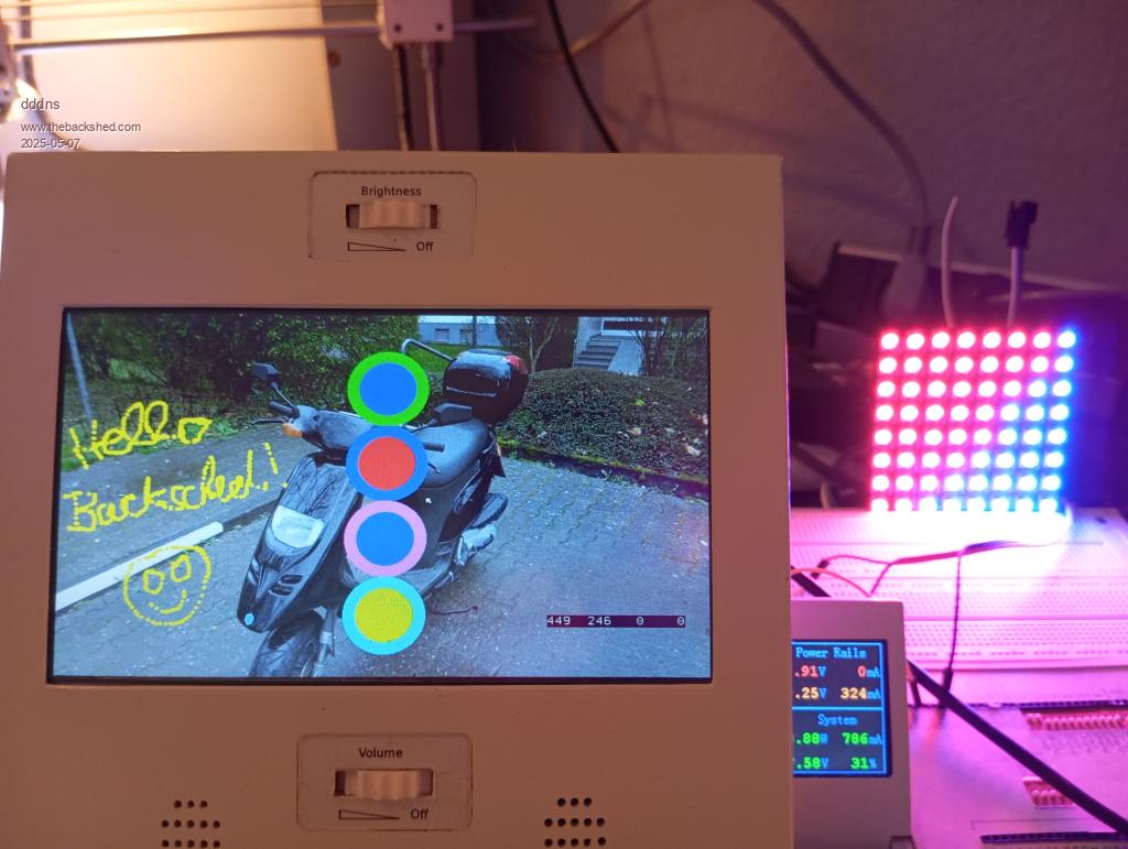

  mozzie said
Micro Die Grinder with adaptor
Lyle.
Looks amazing. How fast does that spindle turn?
Don't want to show off but it fits for the interested
and this
The ssd1963 has one big advatage, it has its own screen buffer and displays full colour at 800x480 really brilliant in photo quality.
Downside is, that PicoMite supports full color not in full extent but with 16 colors a frame buffer works on RP2350 with PSRAM and blit works in full color and is very fast. I think no other supported display has a nicer picture. But TFT and very poor viewing angle, touch works excellent
If its relevant you have probably the most free ram space for your code
photopaint with magnifier
sorry!! of cause I wanted to write Backshed but the german sch is deep in me :)
edit2: This is really nothing special and achievable for everyone as it takes about 30 lines of beginners code to have such result

Posts: 9238
Posted: 10:03pm 06 May 2025
And here it is!
This design *should* work. I've not been able to find anything that might stop it. However, if the circuit diagram is screwed up somewhere I take no responsibility. I can only work with the info that I have. :)
construction pack.zip
