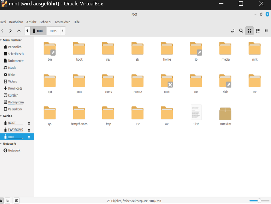

To make things easier, I am currently setting up a LinuxMint VM in Virtual Box. So reading the Linux partitions on the SD card is no problem.
The EmuElec starts even if no SD card is inserted. There is only one partition with the roms on the SD card.
If I now insert the 2nd SD with the ARK OS into the right slot, the system boots into Arc OS.All system changes must therefore be made on this card
Here, the ARC OS system SD under Mint:

as I see it, it is only partially useful that I can access the ROOT partition of the SD Card with MINT Linux. I can copy the tgz file into the /home/ark folder and possibly also unpack it, but as i see it,  I need console access under ARK LINUX at the latest to assign the rights. For this I have to connect the running system to the network, and access via ssh, which I have not yet succeeded in doing (tested with 2 different USB WIFI devices). But I will continue testing.
Anyway,thanks for your effort , I have not given up yet

I think the SD card will be mounted in mint as something like /media/<username>/<card name> ?
If so what does this show ?
ls -al /media/<username>/<card name>

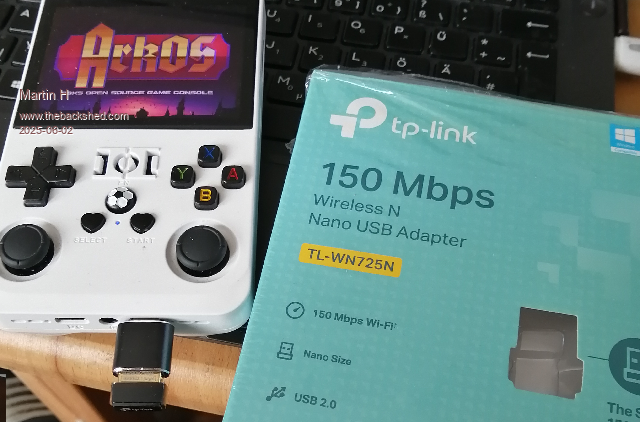

Tom,
I have now found a supported WIFI adapter that is supported by ArK Os.
tp-Link TL-WN725N
SSH access tested and working. I will try again later this week to work through your instructions.
