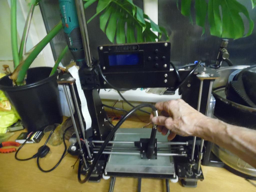

Whereas a cheap 3d printer might work as an intro and you can modify it with your own printed parts, I reckon a router needs to be NOT cheap as it needs precision, so rigidity. The one I posted was extruded alloy.
As said I got two 3d printers and one's just sitting there. I'll strip the extruder so just the carriage and sort a router head. it may work??

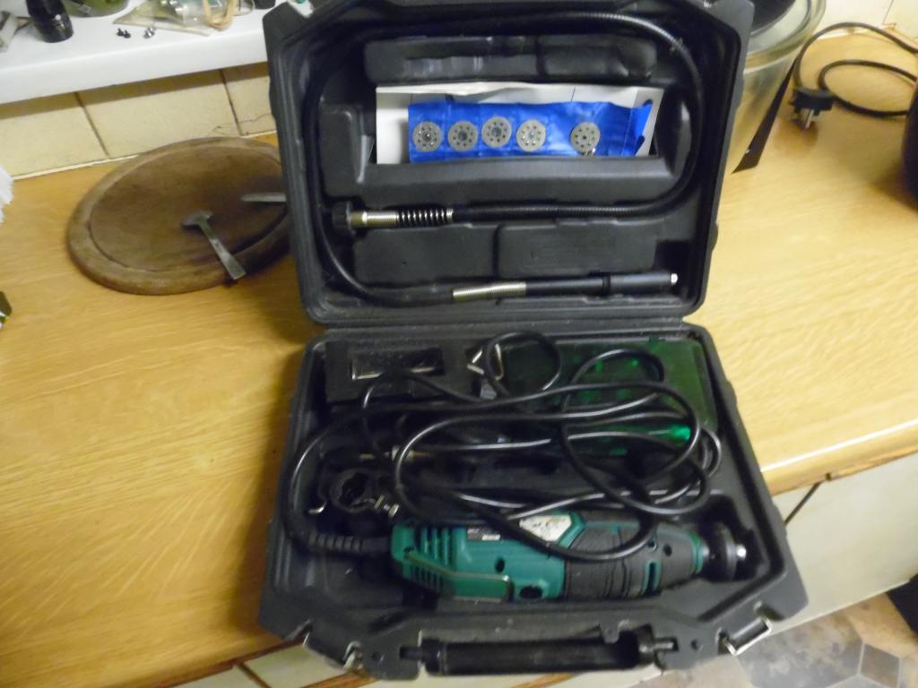

wow, cnc spindle motors aren't cheap!
I looked at my lidl dremel and it got a flexi drive which might be a lighter option.

  stanleyella said   I'll strip the extruder so just the carriage and sort a router head. it may work??
yes why not, if the body of your printer is stiff enough. I looked for so long but from the ratio price/preciseness I think, that Proxxon is the best low cost choice.

Posted: 07:21pm 03 Mar 2025
thanks for the advice, as said I think it hanging as it's meant to with flexi drive might work, it would need a smaller mount, pipe clamp maybe. see what happens and software to use as it's not a 3d printer adding layers it's going the other way.
let you know progress
Posted: 10:21pm 03 Mar 2025
got to make a bracket for the "dremel" extension drive. stripped the extruder and heat bed stuff.

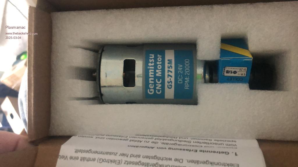

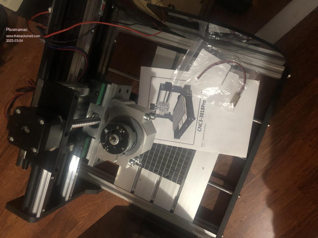

Posted: 11:13pm 03 Mar 2025
Got a cheap 3018 pro from a big seller for 100 bucks , build some stiffer axis because the original are death after
A friend helps with some Alu parts and ready.
A little motor is my Spindel and works like a charm.

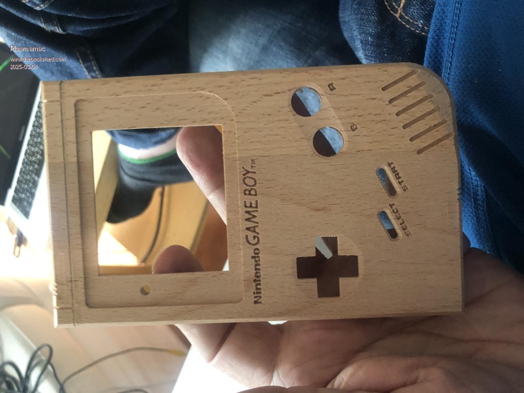

Posts: 6197
Posted: 08:11am 04 Mar 2025
Nice....
A wooden Gameboy...

  Plasmamac said  Got a cheap 3018 pro from a big seller for 100 bucks , build some stiffer axis because the original are death after
Your result looks very nice!
And it is always good to have friends as the modifications are well done.
But in the end, it is always the same conclusion, that you have to modify and
rework or it is not really usable.
Are the axes driven by trapezoidal spindles? Did you try to mill a PCB as it is harder than wood?

  stanleyella said  got to make a bracket for the "dremel" extension drive. stripped the extruder and heat bed stuff.
I doubt that you will get satisfying results. The A8 looks like I know it and this construction is definitely not stiff enough.
The extension drive will be dead after 3 hour nonstop rotating (I guess).

Posted: 10:46am 04 Mar 2025
Those flexi drives aren't up to it. They are too stiff and you would need to sort out some sort of lubrication or it will jam repeatedly. They are fine for their intended use, but not for running for a long time.
