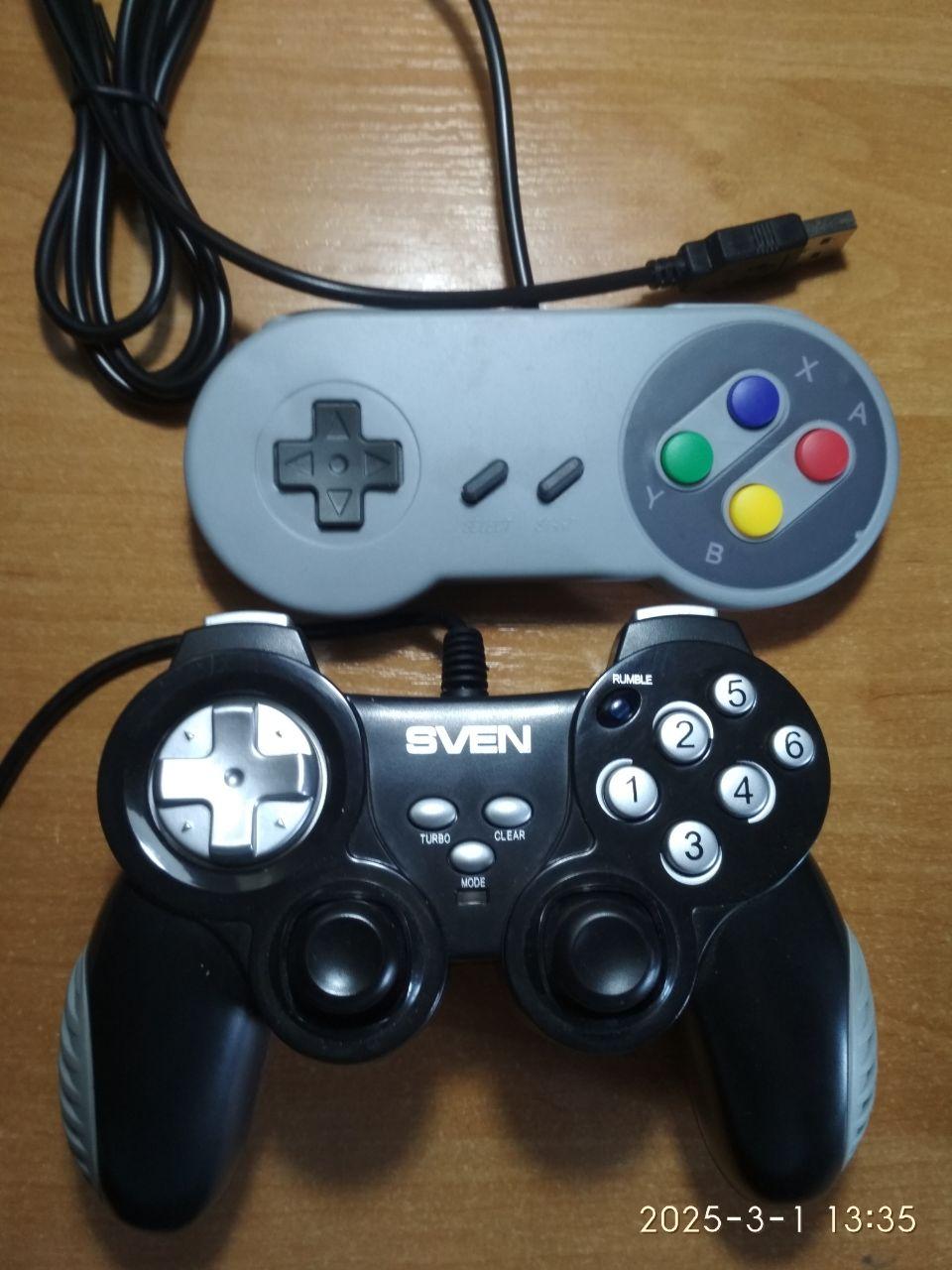

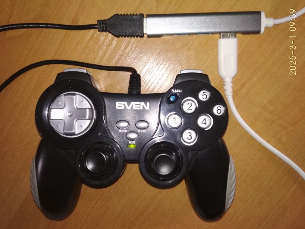

This gamepad is essentially an analog PC joystick. It has two modes: analog and discrete (in which only extreme values ​​for the directions of the analog sticks are set)
The D-Pad processes the extreme positions of the left analog stick.
| 7F | 7F | 7F | 7F | 7F | 0F | 00 | A0 |
 X1   Y1   Z1   X2   Y2  But1 But2 Stat
X1,Y1 - Left Analog Stick
X2,Y2 - Right Analog Stick
Left - X1=00
Rigt - X1=FF
Up   - Y1=00
Dn   - Y1=FF
But1 - B   A   Y   X . 1   1   1   1  (bits)
But2 - Rt  Lt  R2  L2  R1  L1  6   5  (bits)
Stat - A0 - Discret
      20 - Analog
Edited 2025-03-01 20:50 by javavi

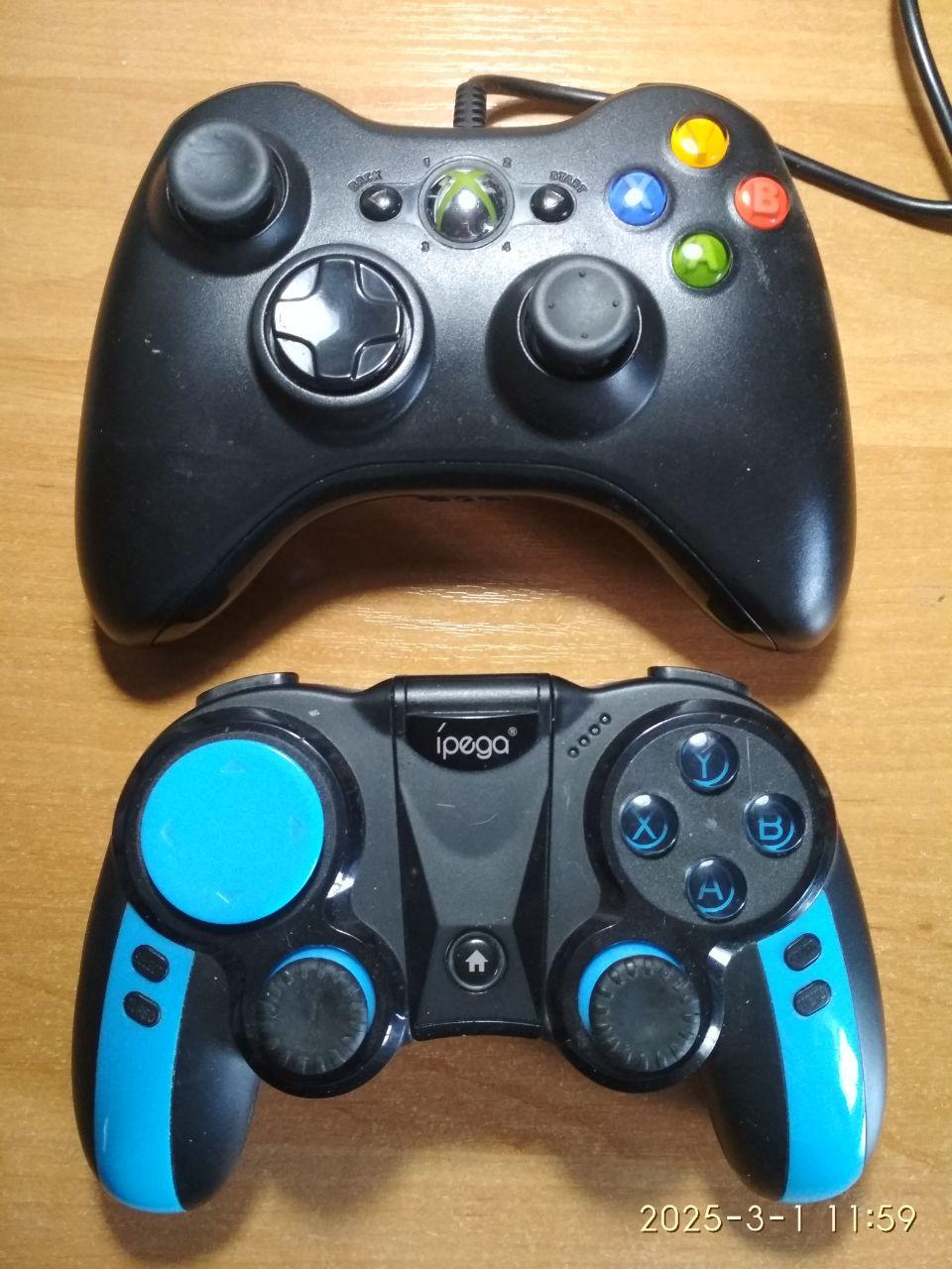

I also have two joysticks for the XBox 360 system.
They are not recognized by the test program at all.
I wish they were also supported by the PicoMite system.

In terms of the report form, this SVEN X-Pad is similar to the top USB SNES gamepad that the PicoMite system currently accepts. They differ only in the VID/PID code.
I think that there are a great many such gamepads, similar in report only from different manufacturers!
They can also contain a different amount of information in the report from the number of axes and buttons.
And it would be better to recognize them by the USB HID device descriptor.
