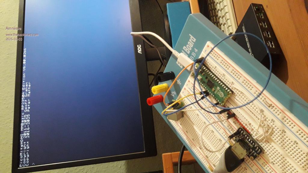

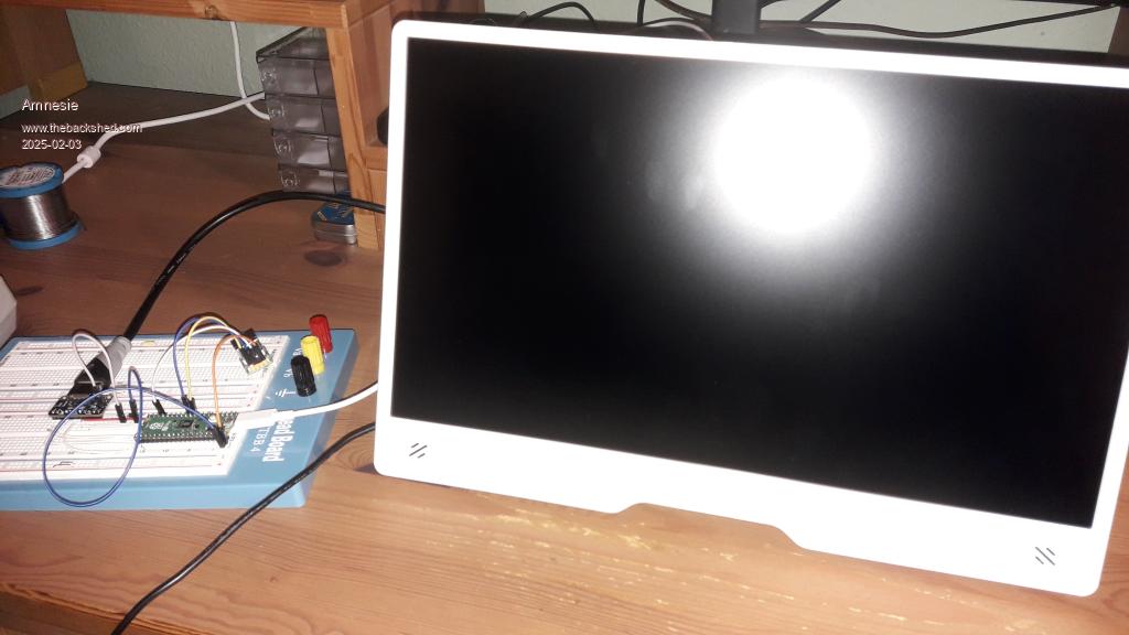

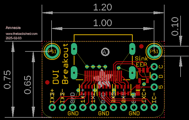

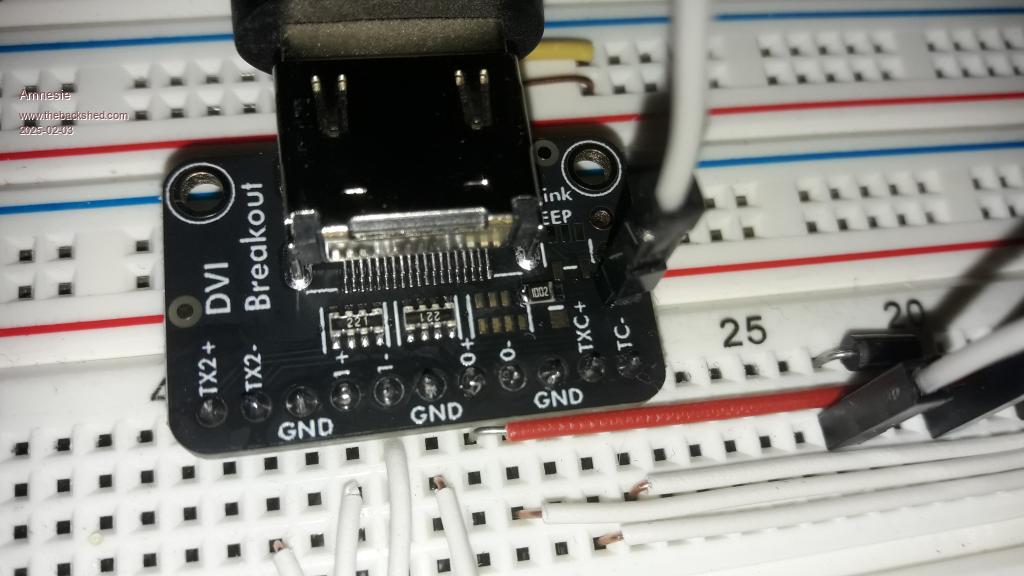

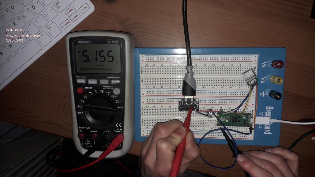

Hi all,
thank you very much for you help. I've attached some pictures.
@ Mixtel:
I did soldered the correct resistor value and it has contact. In fact I've soldered a second one to be sure and measured it.
According to the Adafruit schematic it is not neccesary (in this case) to solder the whole resistor network. So is soldered one 10k pullup (see picture) and the original Adafruit PCB layout. This way the 10k pullup goes to pin 19 of HDMI, too.
Layout:
My "hack":
Measurement between GND and Pin 19 HDMI, HDMI-breakout is supplied via Schottky:
Raspi Monitor not working:
My main work monitor is working:
Javi, the schematic is, as said, 100% the default wiring of the manual for the HDMI version, I just connected a PS/2 keyboard for testing...
Greetings
Daniel
Edited 2025-02-03 05:59 by Amnesie

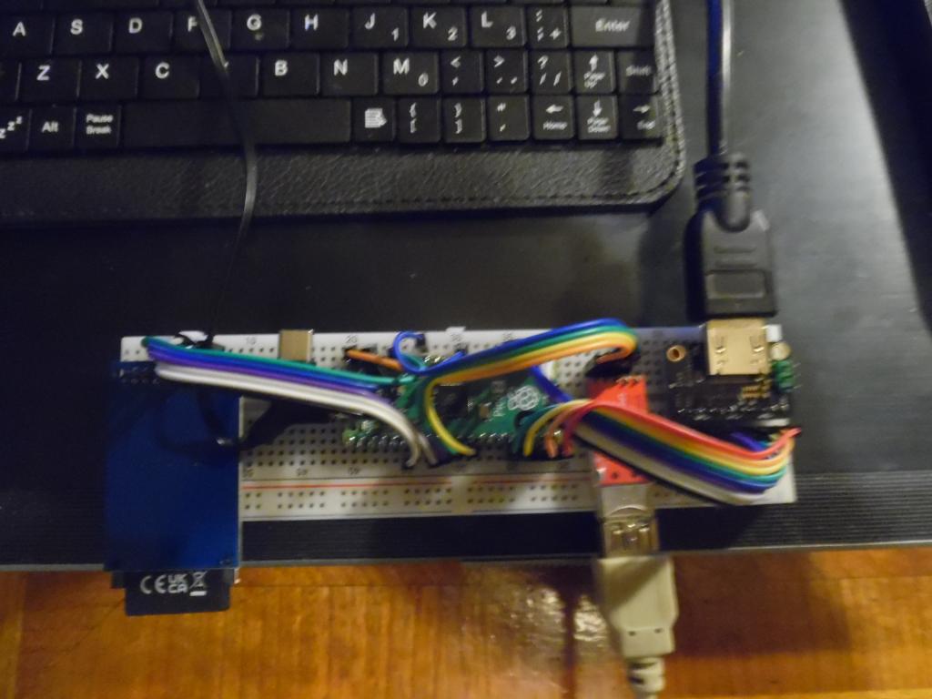

Posted: 08:37pm 02 Feb 2025
mine started on breadboard and worked and on stripboard ok

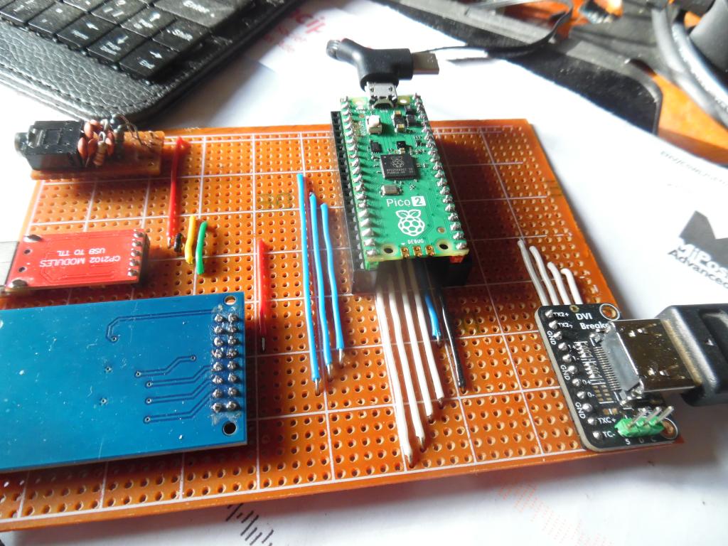

Posted: 08:46pm 02 Feb 2025
no capacitance errors. I found it's the adaptor is ok with bread/strip board.
got to be a reason it works on all tvs with hdmi for me. no 5V to hdmi breakout board.

Posted: 06:55pm 03 Feb 2025
look up car reversing monitors
I got tv android boxes and rasperry pi's to test hdmi.
I got no trouble with pico 2 hdmi usb... you are using pico 2.
same monitor pico 2 vga usb plugged in. no probs switching via mode/source button.
using the same breakout board as you can't see your problem#
show option list and pins in use prog results
Edited 2025-02-04 08:14 by stanleyella
