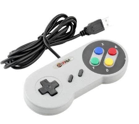

Nobody has actually said it, but I believe this is what we are talking about as an example of the generic USB controller at a reasonable price:
https://thepihut.com/products/raspberry-pi-compatible-usb-gamepad-controller-snes-style
Note it also has two shoulder buttons (L & R) that you can't see in this picture.
Edited 2024-09-13 21:52 by thwill

@Peter,
Are those the controllers that are compatible with the build in API ?
