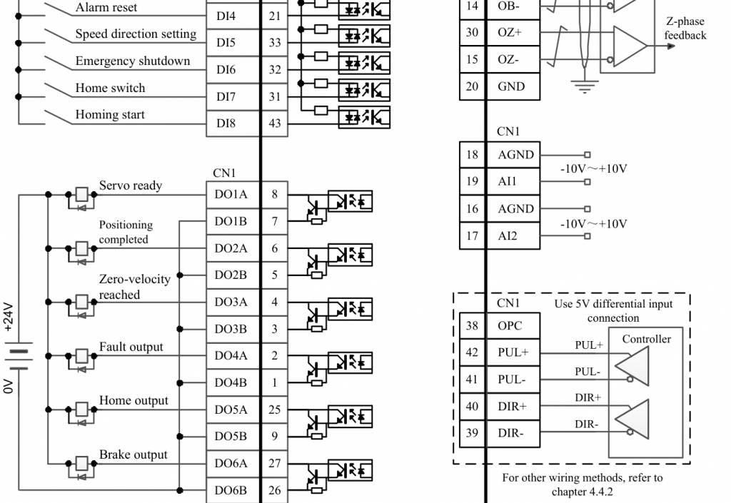

This is a typical industrial servo drive.
On CN1, A11 and A12 are the analog inputs. One is for those who need the device to be a velocity controller and the other is for those who need the device to be a current (therefore torque) controller.
As a velocity controller, the +/- 10V is scaled to the maximum RPM of the motor (velocity gain).
As a current controller, the +/- 10V is scaled to the maximum current output (current gain).
Lower down, you can see PUL & DIR, pulse and direction. In this mode, the PID is 100% closed inside the drive and the pulses are simply like those of a stepper-motor. They are counted and become a position command for the device. (like Volhout has recently implemented in PIO).
I use the current(torque) mode because I want full control

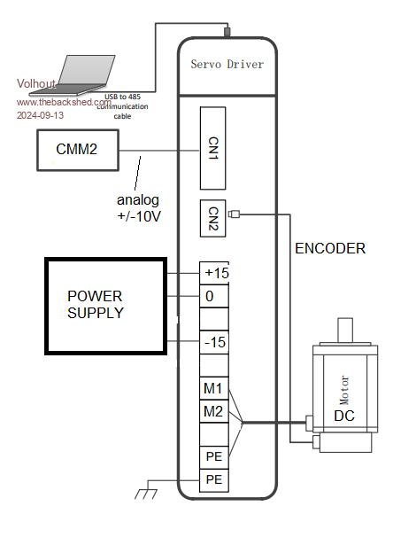

So Phenix,
This is what you are trying to accomplish in this phase of the project ??
P.S. I borowed the picture from the user manual you have posted.

More like
                                                              !--- 24V motor supply
!               !              0-3   !\    +/-3   !\  +/-10  | \-------
!    CMM2       !--------- DAC ------!  >---------! >--------|  >    DC Motor
+---------------+                                          Power Amp
      +------------------------------------------------------<----- Encoder
I think. :)

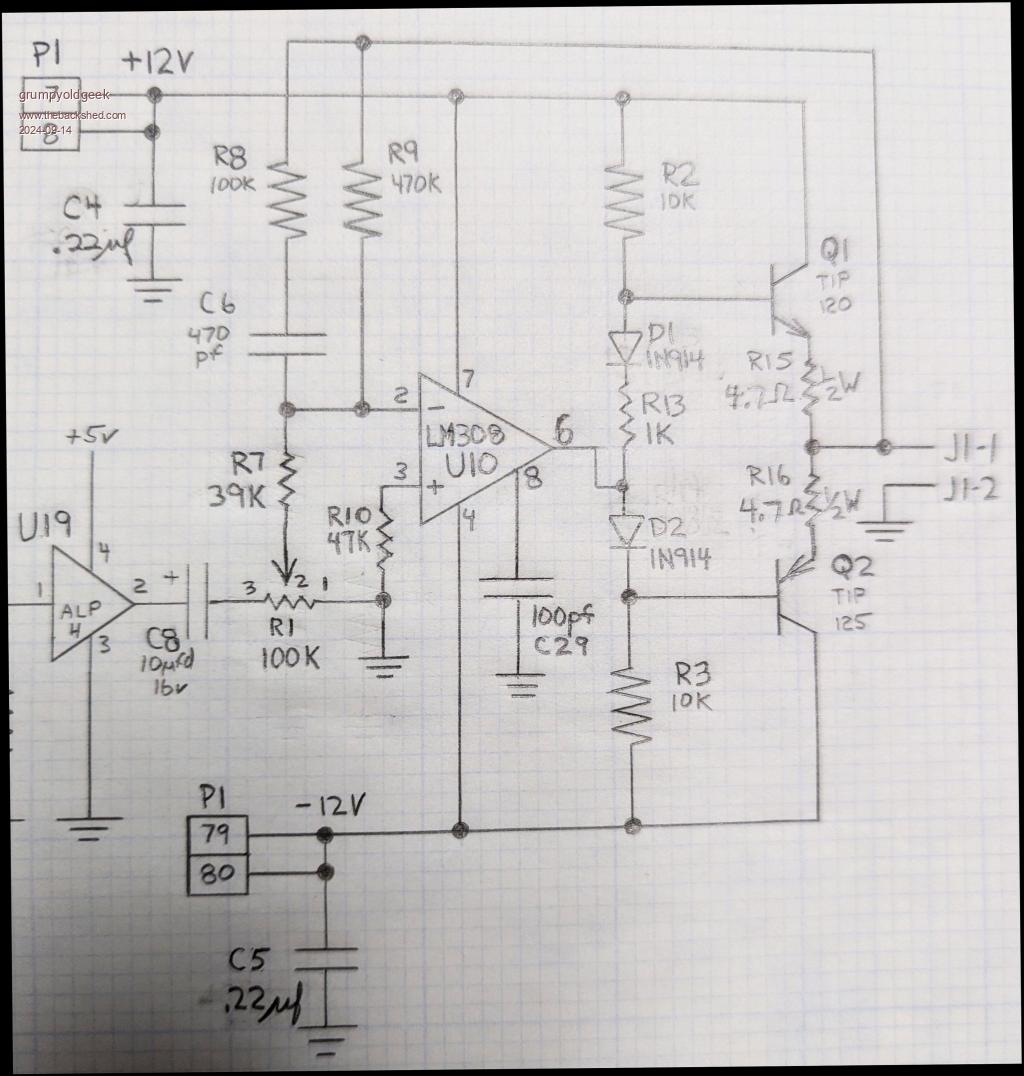

  PhenixRising said  I have been searching for a full schematic for something like this:
It's for my small brush-type motors.
My command signal is +- 10V where 10V drives max current in one direction and -10V drives max current in the other direction and of course, 0V is null.
Current output <2A but adjustable gain (pot?) would be a plus.
I had several of these, back in the 80's but now I can't seem to locate one and I'm useless at designing this stuff
If you are insistent on going this route, here's a design I did about 25 years ago.  It can't drive anything close to 2 amp, but will work and be stable.  The transistors are darlingtons and have all the issues of such, and ignore U19, it's a sharp low pass filter for anti-aliasing. I would not suggest this circuit for anything other than experimentation as there are much better ways of doing things.
Bingo!!!   (and I love the drawing)
As stated many times, all I care about is rotating my small motor with an analogue command signal where 10V command = 100% current in cw direction and -10V = 100% in ccw direction.
The performance/efficiency is irrelevant.
H-bridge, No. I have many but I cannot use PWM on the Picomite as my timer ISR is 1ms and writing to the PWM takes at least that.
Edited 2024-09-14 16:43 by PhenixRising

To avoid dissipation in the output devices you *have* to use pwm, unfortunately. If that is really impossible then your output devices have to be rated up to the full stall current of the largest motor that you are going to use. You also have to fit heatsinks that will keep those devices cool - or at least stop them melting under starting and plugging conditions. :) You also need some form of protection for the devices against back EMF from the motor.
It's quite possible to design an output stage that will do this, but you *have* to know the absolute maximum current that it is going to have to handle before you can start. You can never use a bigger motor than that once it's been built.
The above design is a good starting point. It may be necessary to replace Q1 and Q2 with multiple devices (possibly retaining them as drivers), including paralleled outputs, if you need more current.
Don't rule out H bridges. They can be analogue or digital depending on how you build them. The cheap little modules are digital but you can do it other ways. The increased torque can be well worth it (if you can spare the heatsink volume!).
DC motors are generally not kind to electronics.
