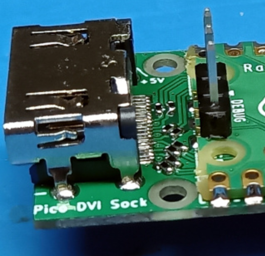

  JanVolk said  homa,
The smd resistors on this board are 220 ohms what could make a difference?
https://learn.adafruit.com/adafruit-dvi-sock-for-pico/overview
Jan.
Hi Jan, I do not know.
I bought it from a German distributor, I took adafruit as an example because of its internationality.
https://www.reichelt.de/raspberry-pi-dvi-sock-fuer-pico-rpi-pico-dvi-p306670.html?search=pico+dvi
Now I see in the second link that the original developer Luke Wren uses the board labeled "Pico DVI Sock" on his photo.
https://picockpit.com/raspberry-pi/raspberry-pi-pico-video-output/
I happen to have this one as well. But I will also get the one from adafruit. And as I wrote above, I'm waiting for the board (from Peter) in the collective order and an Olimex is also on the way. There is still a lot of room for testing! Hopefully we will find the cause.

I'm using 220R terminating resistors for the DVI connection and it's fine. They were all I had at the time so I used them.
I mentioned on the other thread that this monitor doesn't sync properly with the Pico 2 DVI signal. That's not the fault of the signal, I don't think, because a TV is rock solid. More likely that this monitor is marginal at the particular frequencies being used. Windows doesn't offer me a choice greater than 60Hz for refresh but the monitor manual shows a better range.

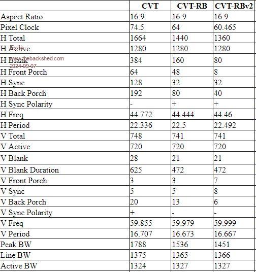

If 372MHz is too high for some Pico2s, is there a possibility to use CVT-RB or CVT-RBv2 timings instead? That would pull the clock rate back to either 320MHz or 300MHz
Video Timings
Posts: 12068
Posted: 02:56pm 07 Sep 2024
  Quote   I understand you this way: it is possible to use the pico2 at this board because the picos are pin compatible, is this right?
Yes: Just plug in a Pico2 and load the HDMI firmware. Then set the option. This is essential because Olimex use a non standard DVI pinout
  Quote   is there a possibility to use CVT-RB or CVT-RBv2 timings instead?
I'll have a play and see if it works - thanks for the info

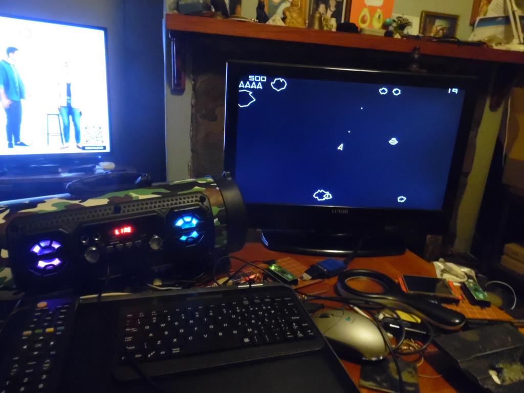

in anticipation of olimex arriving searched my tv's with hdmi and this was wide screen but analogue , no freeview digital but hdmi. in the mean time connected usb vga pico2.
vga looks better than the vga monitor but then it's bigger. no 3.5 stereo input for vga sound but loads of other option so I used a stereo rechargeable £14 blaster with 3.5 aux in  as well as guitar sockets, usb playback, and fm radio...
and the sound in asteroids is proper.. not the bleeps from the vga monitor
so I don't think sound through hdmi is important.
