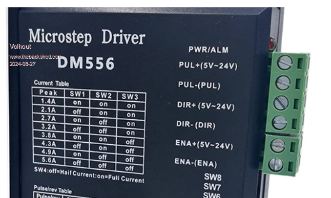

Please be aware, the DM556 uses 5V or higher signals. PicoMite is 3.3V, so you need to attenuate the signals, or use an optocoupler.

Well mate only took about 10 minutes to hook this up and I hooked the Y axis and although silly me forgot about the 3.3 volts output we have life in my cnc at last as the Y axis WAS turning nice and slowly and quiet as.
So yes a 5 volt rail needs to be made and got a heap of small transistors to use. So tomorrow is another day where hopefully more steps are made.

Posts: 9237
Posted: 10:22am 27 Aug 2024
The inputs are already opto isolated. You could probably interface 3V3 to it pretty simply.
Open drain MOSFET directly off the Pico. Connect the + inputs to 5V and the - inputs to the drains of the MOSFETs. You can also use NPN transistors, but use a 1K base resistor.

Posts: 6195
Posted: 11:07am 27 Aug 2024
Or a 4.7k/10k voltage divider. Will make 3.3V from 5V.
But this will only work if Bryan has both "-" pins wired together (to GROUND).

When I originally set it up for the CMM2 I pulled up to 5 volts and as I made the wiring already just swapped it over to ground on the inputs for the DM556. At first I thought it wasn't working then when I put my hand on the ball screw it was turning.
So yes the pico's GP0 and GP1 were connected directly to the DM556 the pico was running the stepper.
