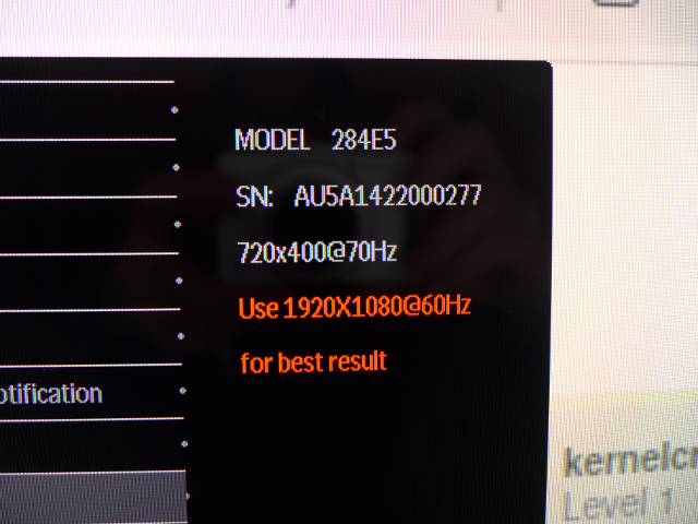

  matherp said  720x400 is an old vesa standard and I can find no evidence that it has ever been supported over hdmi. Lots of posts from people who want vga to hdmi converters for 720x400 and no solutions
works fine for me, on a relatively new 27" philips 1080p monitor over an HDMI connection:
the mode predates VESA, and is a part of the VGA and original BIOS specifications, accessible as modes 2 and 3. i suspect many motherboards would have required it to be supported to use a textmode bios setup.
but, a width of 720 pixels may still be beyond the abilities of the RP2350, and i am just offering it as a suggestion without any expectations; likely i'd be the only person who would use the mode!
rob   :-)

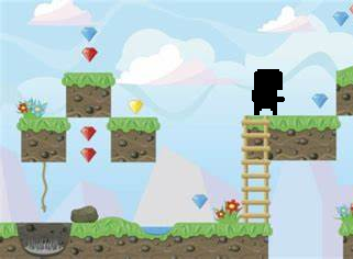

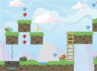

Just a thought for the resolutions with high memory requirements to save the memory for a 2nd framebuffer and layer:
How about an extended classic sprite routine (or Gui Bitmap)where you can specify a mask at the same time (binary 1 pixel remains visible, 0 for deleting the pixel) , so when called, the background of the sprite would then be saved away, Mask would be logically gated to then the area on the screen with AND and then the actual sprite data would be ORed with it.
If the sprite is deleted or moved, the originally saved memory is written back to the screen.
Sprite:
Mask:
Background:
Background AND Mask
OR ing the Sprite
just an idea
Edited 2024-08-16 22:24 by Martin H.

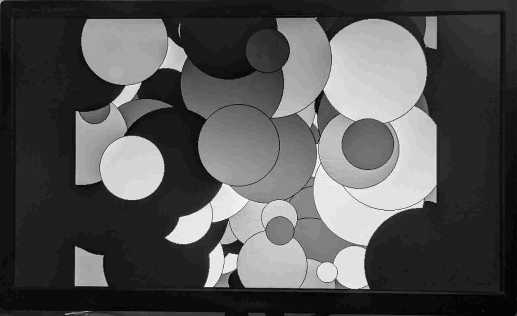

I've found that uneven numbers of bits per pixel colour to be a bit of a pain, particularly with respect to grey scale.
rgb332 does not work well for shades of grey.
rgbi2222 is much nicer, if possible. The 2 i bits are added as the 2 lowest bits to all three colours. So the 4 bits of red = rrii, green = ggii and blue = bbii. Is that possible to implement?
