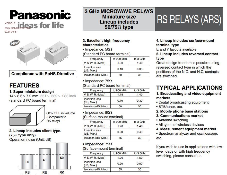

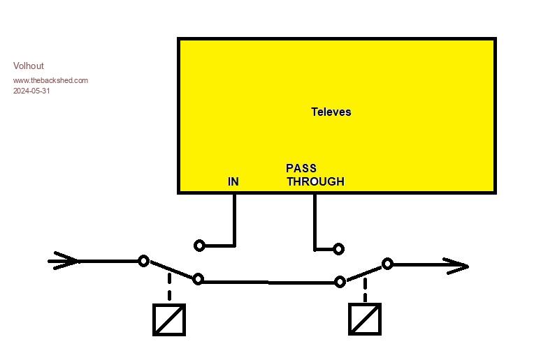

Another option could be to add a coax relay to the pass-through connection of the TeleVes. Power the COAX relay from same 230V (phone charger) that poweres the Televes.
Once the Televes looses power, the COAX relay will switch to pass the input signal of the Televes to the output. The next houyse will get a slightly weaker signal, but it may solve the issue.
(*) since the signal gets weaker due to cable losses and signal being routed to Televes units along the run, the first houses may need -20dB pickups, the later houses -10dB or -6dB or -3dB.

Yes, that is another good idea - had not considered coax relays.
Something else to think about.  Lots of lovely ideas being thrown around here - thanks chums!

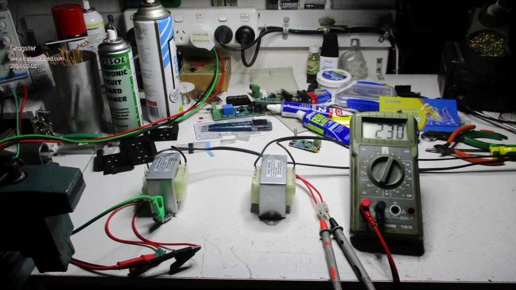

BENCH TESTING:
This is the very standard HV-LV-LV-HV transformer arrangement. (sometimes called HV-LV-HV)
A happy 230vAC at the other end of the 100-meter link of speaker cable. (no load)
Yes, I laid the entire roll out flat, I did not leave it all coiled-up on the roll, which would affect the results.
Please ignore the direct 230v outlet to the clips of the "TX" transformer - this is NOT something anyone not competent with using live 230vAC should EVER use, but I have been using "Hot leads" like this for years, and due to my training, I know what I am doing.  Note I still wrap the phase up in PVC tape.
...but I digress in the name of safety...
There is nothing special about this photo - it is basic transformer theory from the days of old and when we ALL learned about the benefits of AC power distribution.(vs DC)
These transformers are single-phase 230vAC input, and 30vAC output @ 1 amp.

Posted: 05:22am 08 Jun 2024
UPDATE:
Despite the relatively high-impedance of the "New" 230v out of the receiving transformer, the test VCR started up just fine with no issues, and it is a SMPSU based unit.  Current in the 30vAC side of the link, is around 350-400mA, which sounds about right.
I might try loading it up with more stuff, just to see how far I can push it!
But this is encouraging, so the next step will be to connect this arrangement temporarily to a phone pair, and see if I can start one of the Televes amps on it.
I have more testing-and-monitoring to do yet, but the initial test worked well, so that is a plus!
I was kinda expecting the VCR PSU to not start due to the high-impedance of the "New" 230vAC.  Most(if not all) SMPSU's have an initial inrush current that can be upwards of 20A or more, just for a fraction of a second while the PSU gets running.  The low-impedance of the normal mains handles that without issue, but the high impedance of this kind of setup can often prevent SMPSU's from starting at all.
