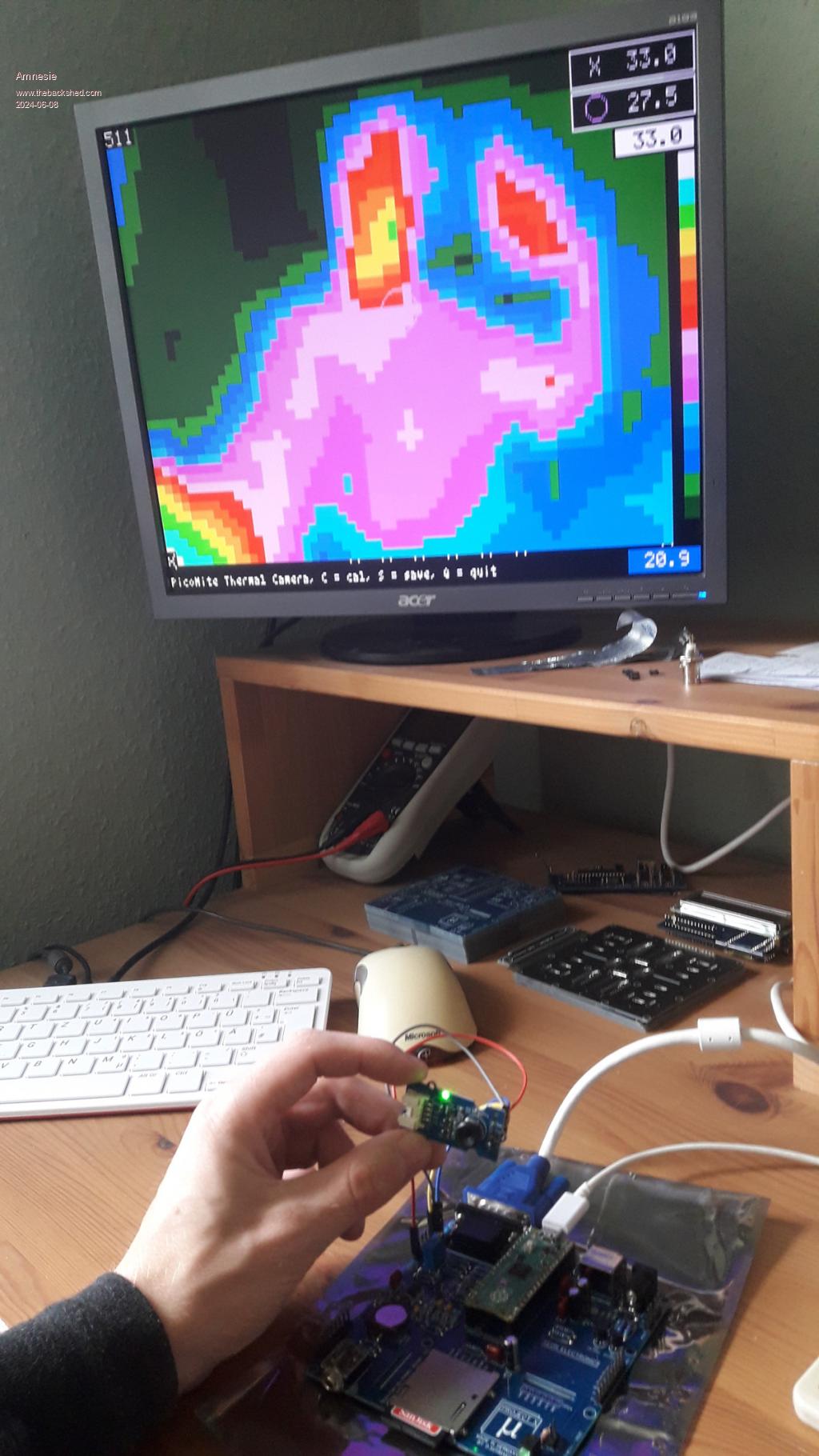

Amnesie
Joined: 30/06/2020
Posts: 763
Posted: 09:55am 08 Jun 2024
Volhout,
the thermal module arrived and your sorftware works geat, just impressive!
Me sitting in front of the cam holding the smartphone to shoot the image:
I am excited to see how far you can push it to the limits, but to be honest, I am really happy with the current results.
Greetings
Daniel
Posted: 11:42am 08 Jun 2024

Posts: 6198
Posted: 01:43pm 08 Jun 2024
Daniel,
You are running 378Mhz. The version I listed here does 730ms at 252Mhz.
The version under development now achieves 500ms at 252Mhz. This is for compatibility with the Game*Mite.
The number 511 in the top corner is the speed. The camera module speed is 500ms approximately.So you run in sync with the camera now. The number will never be less than this, since the software will wait until the camera Has a new frame ready
Edited 2024-06-08 23:50 by Volhout

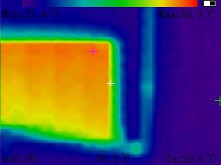

Posts: 6198
Posted: 09:15pm 08 Jun 2024
It can clearly identify whete wxactly  in the bezel pf a laptop screen the  aclight driver is mounted. So I ecpect it can find warmer parts of a wall.
Posted: 09:26pm 08 Jun 2024
a rad and hidden pipes. ready made 32x24 camera mlx90640 wide
