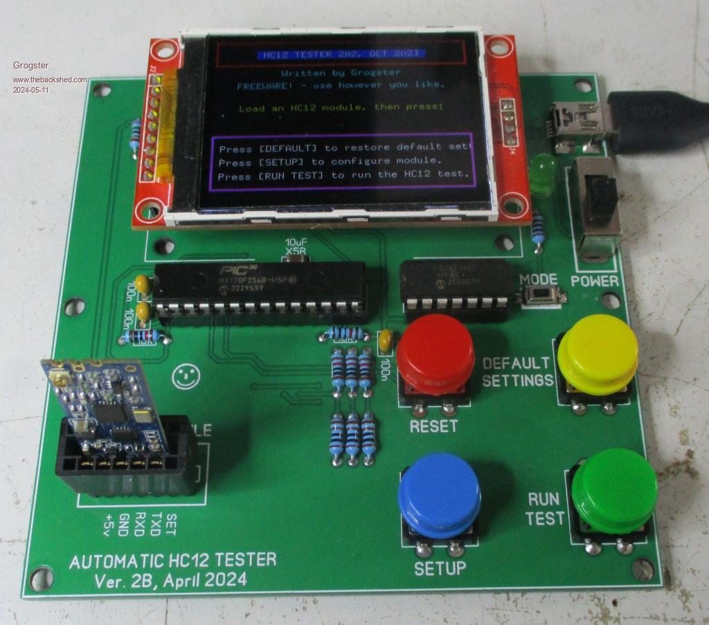

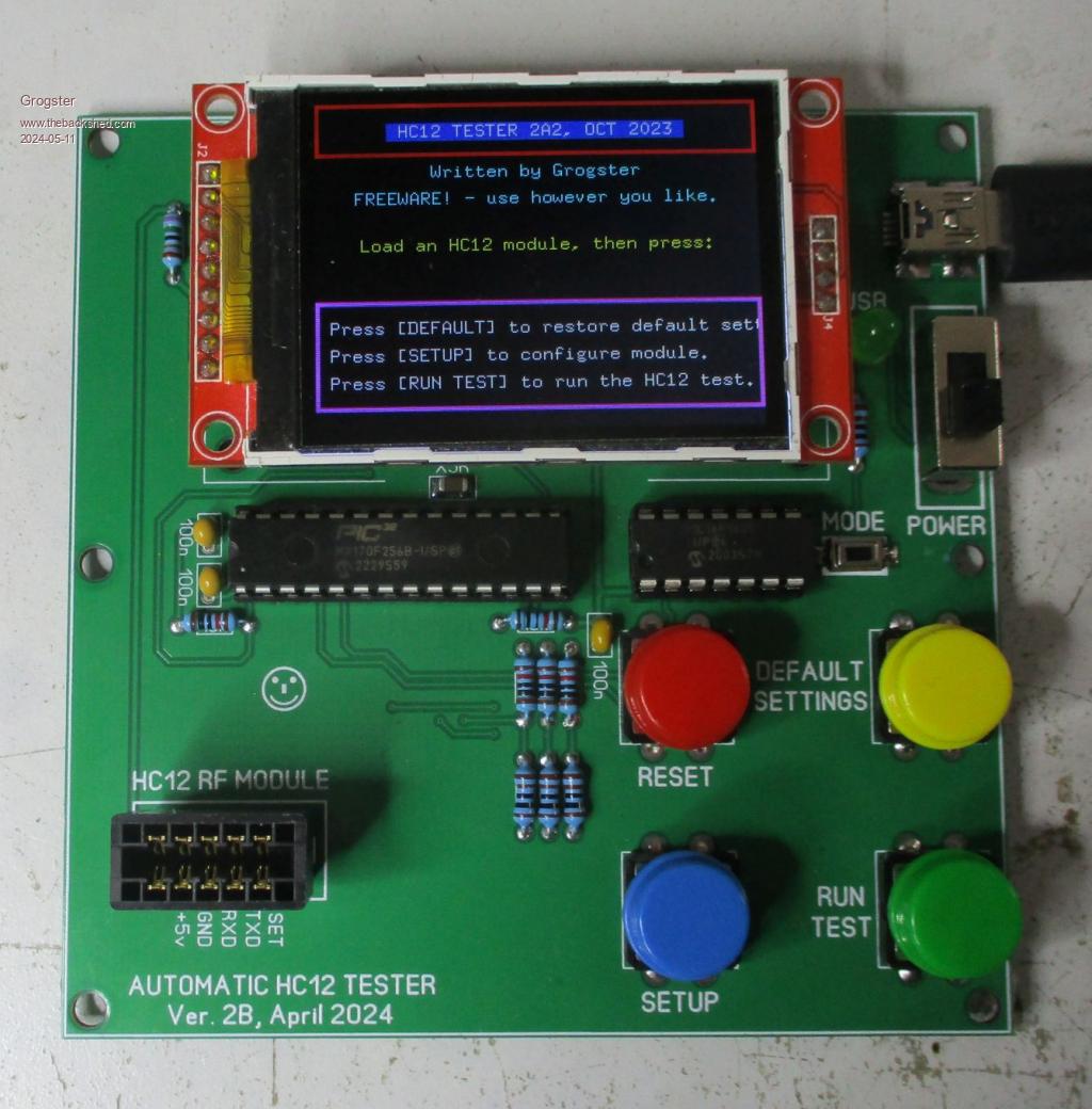

When I have any spare time(that that often!), I have been tinkering on a few projects.
The latest one is a new version of an HC12 tester - this is the unit that caused me all the LCD problems - till I discovered that I was the creator of my own horror story, as I installed the wrong regulator chip.
This board automatically configures the module under test, tests the transmission frequency, and then resets the module to default settings.  You need a scanner radio to tune into the test frequency, but everything else is done at the press of a button.
This is designed to make testing of any HC12, a quick and easy process.
It was found to be necessary to test EVERY module that did not come directly from the HC factory, as there are lots of clones on the market.
If the module under test passes, it is OK to use.
If the module under test fails, then that normally requires you to replace 30MHz SMD crystal on the module, then re-test.
If anyone here has a use for this(looking any any of you who use HC12's regularly!), let me know and I can either upload a constructors ZIP file, or start a new thread.

What about a known good HC12 to use in frequency testing?
 One that is part of the board where you can run it through a set of frequencies
 for the test unit to match.

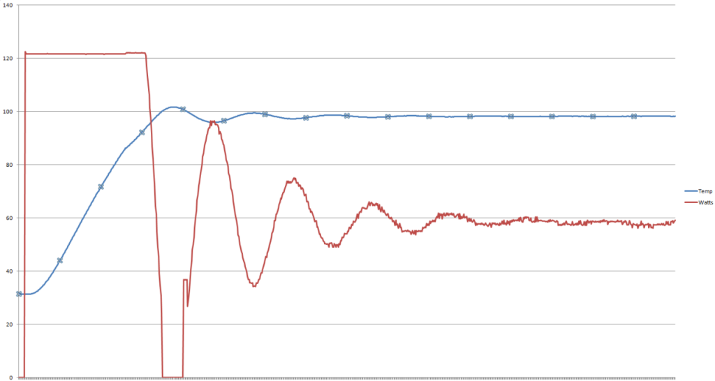

re-visited the software in my 3D printer heated bed controller. Did a very simple "bang-bang" version years ago but the temperature was predictably erratic and on the hot side. I wanted more as-demanded rather than "it's in there somewhere"
New software with trending and using SIN to compensate for the hysteresis between the heaters and the thermal mass of the plate. Target was within 5% of demand - I got it down to around 1.8% so quite happy with that.
Plot of temperature Vs input power. The power is calculated by V * A(full load) * PWM ratio (0.00>= n >=1.00).

G'Day Captain.
I know I will live to regret this but.......
What is SIN?
Nice to see you still active.
Peter
Posts: 3417
Posted: 08:08am 12 May 2024
  Quote  What is SIN?
Just a guess, but looking at the trace he seems to be including the SINE function in the PID loop to counteract oscillations caused by thermal lag.

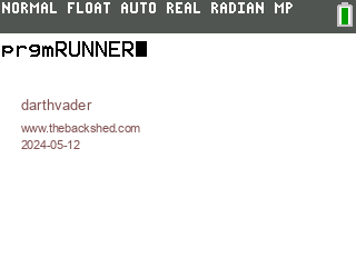

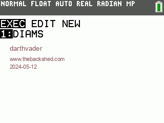

@Martin ,
II have made a boulder dash clone in TI83 calculator long ago , if it can help i attach the c source code
TIDiams_src.zip
And for the same calculator i made a lode runner clone too , if someone is interrested here is the c source code :
runner_src.zip
The GIF/PNG are animated , i hope the forum can show it.
