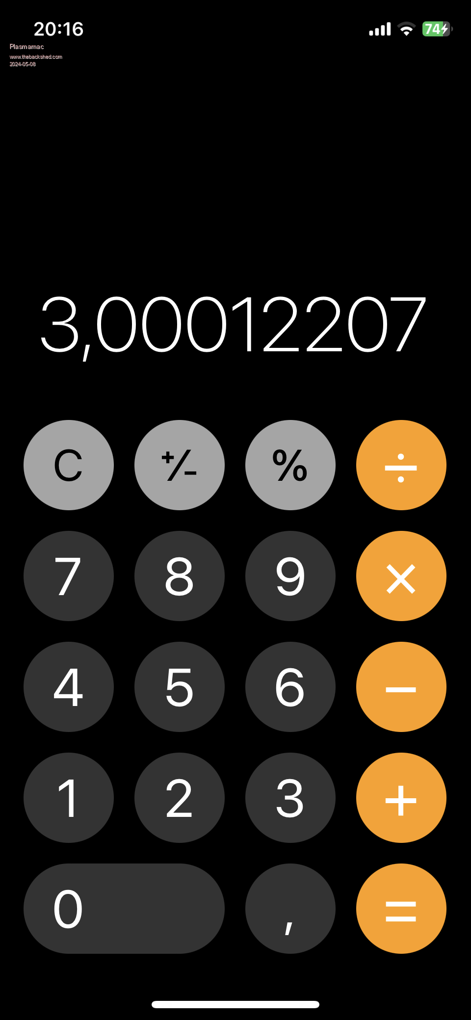

Plasmamac
Joined: 31/01/2019
Posts: 620
Posted: 06:19pm 07 May 2024
Edited 2024-05-08 04:21 by Plasmamac
Plasma

Interesting thread.  What is the result on maximites or early micromites  ?
@Plasmamac, what is the screen ?
