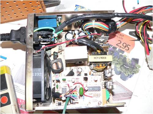

I fiddled a little more with the psu, i think the problem now lies with the undervoltage lockout. When turning the voltage down below 7 Volts (doesn't matter if i do this with the voltage pot or current pot, with load), the psu trips into failsafe mode. I assume there would be no adverse consequences if I disabled the undervoltage lockout, right? The tl494 and lm339 seem to get their power from an auxiliary 20VDC line.
This psu seems to use pin 3 to shut down the psu instead of the dead time control. The LM339 latches on to do this. The pin 4 is just connected to a voltage divider between Vref and ground.. which leads me to another question, how is the soft start in this psu handled? There is a place for a cap in the pin 4 resistor circuit in the pcb, but there is no cap in it(it would make sense if there were a cap, as it is in paraller with the pullup resistor). Only soft start i see in this is the cap in paraller with the resistor feeding the pin1 on tl494.
Another thing also i need to do, currently the psu takes the reference measurement from +5V line, i'll have to change this to the 12V line.

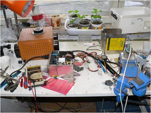

A few pics below, sorry about the not so great pic quality.
Notice how nicely the control board is in there, attached with 2 screws and the cord is easily removed = easy to take the board out for soldering :)
PSU & some of the equipment.

Hmmm...
The designer obviously attacked this with a different bent than most others I have seen.
The 393 seems to kill off the pulse at the feedback point. Works I guess, but not as I would have done.
Controlling soft start by drowning the control voltage is as good as any I guess, but usually done by pulling pin4 high with a cap, and letting a bleed resistor pull it back down again.... ie cap in series with b+, resistor pin4 to ground.
In the ones I have played with, an aux diode simply rectifies the 12v rail directly from the transformer, and feeds the 494 with that. Keeps it fairly independent from the main rectified voltage. (seems to run on ripple when short on the secondary is in place, and current control keeps current at exact levels when Vout=0
I am unable to see the dxf files of the circuit. Are you able to screen catch and post a jpeg or similar?
The physical layout is very different to what I have seen, but at least it is not as messy as an ATX.
