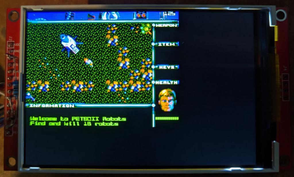

Posts: 12068
Posted: 07:44pm 26 Mar 2024
Firmware V5.09.00 release candidate RC2 is now available for download from
Fixes error in OPTION RESET RP2040-GEEK
Fixes spurious output when plugging a USB keyboard while running a program
New boards
PICOGAME 4-PWM
PICOGAME 4
SWEETIEPI
VGA Basic
USB Edition V1.0
Use OPTION RESET LIST to see boards that are available on any specific version of the firmware
OPTION LCDPANEL anyspidisplay orientation, dcpin, resetpin, cspin [,backlightpin] [,INVERT]
if the new optional parameter "invert" is used the colours are inverted - supports the IPS ILI9488 display
OPTION LCD320 ON/OFF now supports 480x320 SPI displays. This allows programs that run on a 320x240 display to be run and tested on  the bigger display by restricting the framebuffer size to 320x240
Edited 2024-03-27 05:47 by matherp
