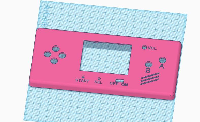

So that I have a smooth contact surface when printing I wanted to change the lettering of the TOP Cover from raised to engraved.
Top Case:
  Quote  STL num of vertices 365496 num of triangles 731593
Base
  Quote  STL num of vertices 393630 num of triangles 787272
For a simple housing, that's a lot.
Sadly I could not Handle such complex files.
'no comment

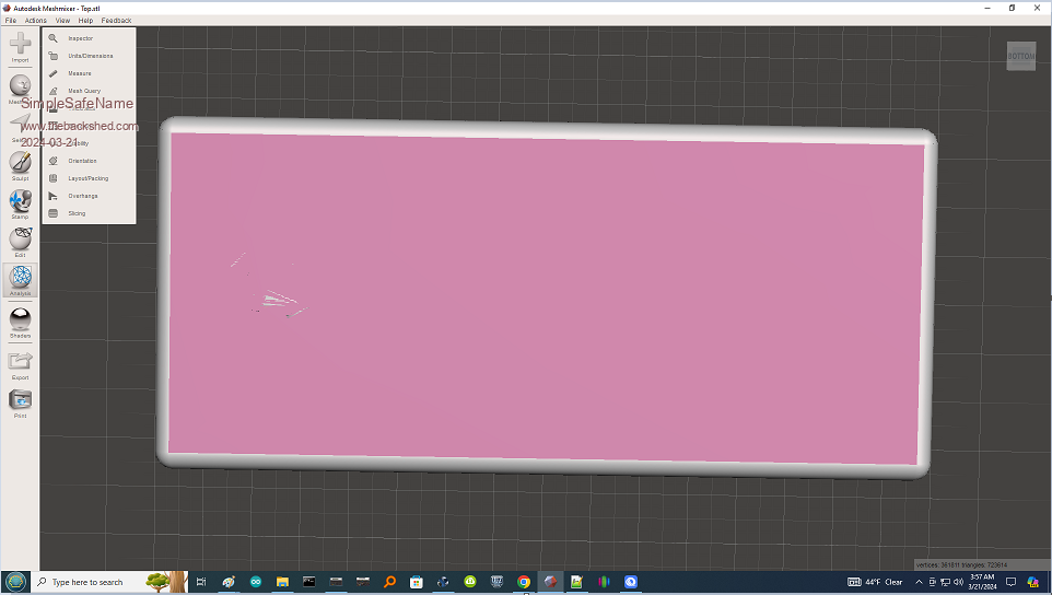

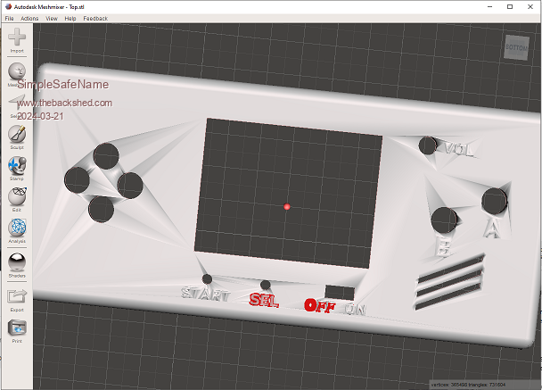

Oh what fun! OpenSCAD is correctly complaining about an "ERROR: The given mesh is not closed! Unable to convert to CGAL_Nef_Polyhedron." error.
This has happened to me in the past when I was trying to print the Destiny Thorn gun that someone had added their name to in the model. So until the error is fixed OpenSCAD won't render the file (and without a proper rendering, there will be no STL file exported).
So, off to MeshMixer. Which shows where the error is:
And MeshMixer's first shot at fixing the error:
Arguably it did fix the problem. LOL! Nonetheless, it appears that we have some work to do. :)
The best thing would be for Geoff to remove the text, but I'll muck about with it and see if I can fix it. My edits might leave a file that looks correct, but no longer prints accurately (but I don't expect that to happen).
So take this post as a work in progress,

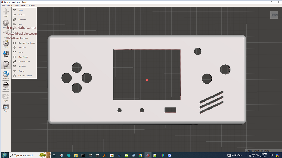

For the record, there is nothing wrong with your file - if - it is printed as you intended using a resin printer.
But if you want to print it at home using a filament 3D printer the bumps from the letters will lift the rest of the print off of the build plate and that part of the print will begin in mid-air (which won't work).
That's all that was "wrong" with it. But by editing your design to omit the lettering you fixed the problem for filament 3D printers. And it can now be printed at home.
I did "fix" it in MeshMixer, but I've forgotten what I did to fix the previous file for my friend. The resulting file is about 3 times the size (but looks pretty good), but it now exceeds the memory limits of OpenSCAD (my rig has 64 Gig, I'm going to go out on a limb and say that *I* didn't run out of memory).
But your file is the way to go.

  Geoffg said
However, for anyone who needs it, I have created a version without the lettering (top enclosure only).
Thanks a lot
For People that like to print it with filament Printer, I changed the "No Text Version" to engraved text.
PICO GAMER TOP-engraved text.zip
Martin
