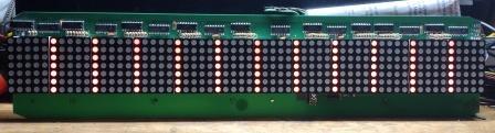

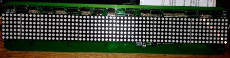

Ok I found an LS138, ran the three unused bits off the last 4094 into the inputs of the LS138.
The outputs from the LS138 then pull down the gates of the RFP Mosfets through some low value resistors.
Slight mods to the code and that is almost perfect, though there were some artifacts on the display bottom line.
Looking on the scope there is what look like very fast pulses coming out of the LS138 outputs, which I think is the data being clocked into the 4094's rippling through as I had enabled the LS138 permanently by connecting the enables to gnd and vcc..
So I have used a pin on the Pico which I connected to one of the enable inputs on the LS138, I shift the data out using SPi, then toggle the latch pin on the CD4094, finally I enable the LS138.
Flicker has now completely gone, so all good.

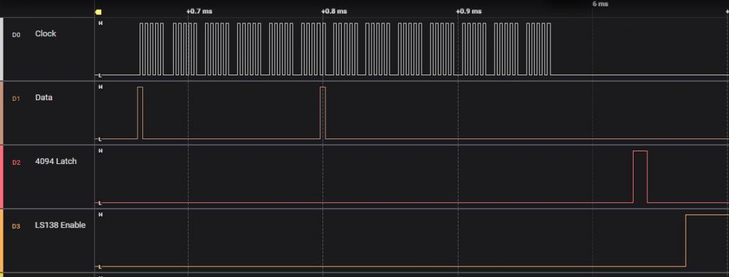

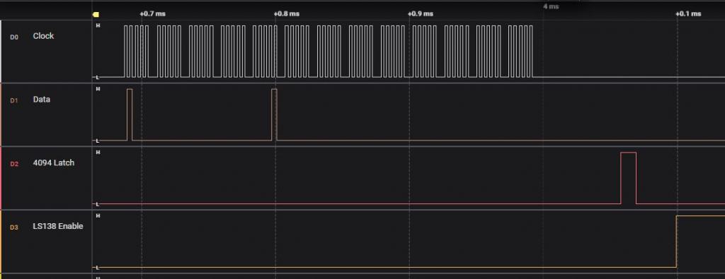

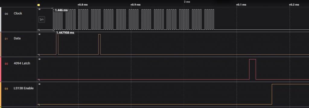

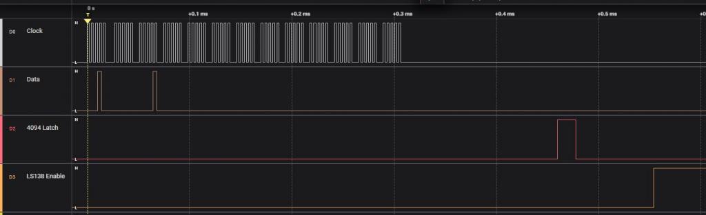

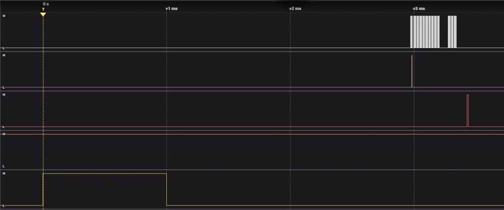

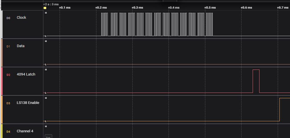

Row 1
Row 2
Row 3
Row 4
I can send you the captured data if you use Logic by Salae (which I think your screenshot was from).
Tony

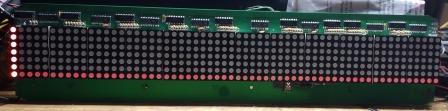

Ok, sorted out the correct values for the first byte, this is what I now have

the only odd thing now is the left hand most column of LED's never lights, also, if I send out all the data bytes set to 01, I would have expected the righhtmost LED in each group of 5 to light, but they don't sending out
 data &B00000,01,01,01,01,01,01,01,01,01,01,01,01
'row 2
 data &B00010,01,01,01,01,01,01,01,01,01,01,01,01
'row 3
 data &B00100,01,01,01,01,01,01,01,01,01,01,01,01
'row 4
 data &B00110,01,01,01,01,01,01,01,01,01,01,01,01
'row 5
 data &B01000,01,01,01,01,01,01,01,01,01,01,01,01
'row 6
 data &B01010,01,01,01,01,01,01,01,01,01,01,01,01
'row 7
 data &B01100,01,01,01,01,01,01,01,01,01,01,01,01
I am seeing this
Could that be because we're sending 65 bits?
Tony

I just tried the data lines you sent, I get nothing recognisable on the display,
I think there still maybe something wrong in the shift / math bit.
If I set the data bytes to all 0 including  the first byte which selects the row, that should clock all zeroes to the display.
I've set a trigger pulse at the start of the code to trigger the analyser, then captured clock, data and 4094 latch.
For some reason I am seeing a '1' on the data line, but the data does'nt have any 1 bits set for the first row.
Top trace is clock, next one down is data and the next one down is the 4094 latch, the bottom one is the 1mS pulse to trigger the analyser.
This  is the code that produced that capture.

And the matrix looked like this
I took out the enable to the LS138, I am now seeing the artifacts on the bottom row you can see in the picture, if I have the lines back inf or the LS138 enable, the artifacts disappear.
Tony
Edited 2024-03-18 19:39 by 58kk90

No idea what is going on
using the math V-OUT you mentioned, right before the SPI instruction, I get
0, 0, 0, 0, 0, 0, 0, 0, 0, 0, 0, 0, 0
2, 0, 0, 0, 0, 0, 0, 0, 0, 0, 0, 0, 0
4, 0, 0, 0, 0, 0, 0, 0, 0, 0, 0, 0, 0
6, 0, 0, 0, 0, 0, 0, 0, 0, 0, 0, 0, 0
8, 0, 0, 0, 0, 0, 0, 0, 0, 0, 0, 0, 0
10, 0, 0, 0, 0, 0, 0, 0, 0, 0, 0, 0, 0
12, 0, 0, 0, 0, 0, 0, 0, 0, 0, 0, 0, 0
Which as far as I can tell is correct, so why I am seeing the '1' in the data out of the Pico is unknown.
Tony
58kk90
Joined: 14/06/2023
Posts: 82
Posted: 10:05am 18 Mar 2024
So replacing the line
spi write 13,row_out()                'send it out
with
spi write 13,00,00,00,00,00,00,00,00,00,00,00,00,00               'send it out
gives this on the analyser
Which looks perfect, all 0's sent, all zero's being clocked out.
Tony
Posts: 6199
Posted: 10:07am 18 Mar 2024
Hi Tony,
The "1" is in the first clock block, so it is the LS138 row address bit.
That should be correct.
I am not sure about the dim lit lowest row. MAybe that P-FET does not turn off fully. Is the LS138 output 5V, or only 4V. Maybe add a 1k pullup to the LS138 outputs. To make sure it is 5V and the FET is off.
The lit first row when sending 0's... I have no idea. I assume the data is shifted in from the left to the right ? So the lit column is the last bit sent ? Can you confirm ?
Posts: 6199
Posted: 10:14am 18 Mar 2024
Hi Tony,
Looking at the 1'st picture in the 9:37 post, the data should shift 1 bit further.
I will check if the SPI setting is right for the 4094. Maybe mode=0 is not correct (although I thought it was).
58kk90
Joined: 14/06/2023
Posts: 82
Posted: 10:30am 18 Mar 2024
@Volhout,
This is the latest code,
'4094  driver, running on picomite GEEK unit
option default integer
Const LS138Enable = MM.Info(pinno gp1)              ' enable to the LS138
'SPI channel
setpin gp16,gp3,gp2,spi    'gp2=clock, gp3=tx , gp16 is not used
'CD4094 shifts on rising clock edge, input data must change on falling edge.
SPI OPEN 200000,0,5       '200kHz data output falling edge, 5 bits
SetPin LS138Enable, DOUT
setpin GP15, DOUT          ' a trigger pulse for the analyser
setpin gp5,dout           'latch enable signal
pin(gp5)=0                '0=hold data
'this is the array holding all the pixel data for the LED's
dim txt_out(12,6)
 'this is the array that us used by SPI to send out data
dim row_out(12)
filltextarray
'this is the interrupt that multiplexes the display
settick 2,nextrow
pulse GP15,0.1    ' a 100uS trigger pulse for the analyser
'here comes the main code, text entry, scrolling, serial input etc...
do
  'do all the stuff
  pause 100 'just to simulate stuff...
loop
'This is the display multiplexer
sub nextrow
Pin(LS138Enable) = 0
static i=0                         'static = local i inherits last value
inc i,1:if i=7 then i=0               'next row
math slice txt_out(), ,i ,row_out()   'copy into single dimensional array
pulse gp5,0.01                        'latch enable pulse
Pin(LS138Enable) = 1      ' enable the row
end sub
'just to get the pixels in the DATA statements into an array
sub filltextarray
for i=0 to 6
  for j=0 to 12
    read txt_out(j,i)
  next
next
end sub
'some default text, each bit is a LED in 5x7
data &B00000,00,00,00,00,00,00,00,00,00,00,00,02
'row 2
data &B00010,00,00,00,00,00,00,00,00,00,00,00,04
'row 3
data &B00100,00,00,00,00,00,00,00,00,00,00,00,08
'row 4
data &B00110,00,00,00,00,00,00,00,00,00,00,00,16
'row 5
data &B01000,00,00,00,00,00,00,00,00,00,00,00,00
'row 6
data &B01010,00,00,00,00,00,00,00,00,00,00,00,00
'row 7
data &B01100,00,00,00,00,00,00,00,00,00,00,00,00
That is almost perfect, I get a backslash '\' on the rightmost 5 x 7 LED panel not sure why the previous versions were like they were, but clearing all the code and options from the Pico, and sending it again, it now ALMOST works.
By Almost, I have found an issue with the way the panel is wired, which may mean the code will need to be changed.
If I put 01 as the rightmost byte in the ROW 1 (or any row) data line, I see no LEDS lit.
If I change it to 02, then the right most LED lights up, looking at the pinout for the first CD4094, the D0 output doesn't go to the ULN driver like every other output pin does, it goes back to the header where the controller board would have fitted.
The right hand most column of the LED's actually goes to the D1 output via the ULN driver, which is why sending 02 lights the right hand most LED.
Sending 01, the pin on the header toggles high but no LED's light, which is understandable as the D0 output is effectively not used.
Tony
