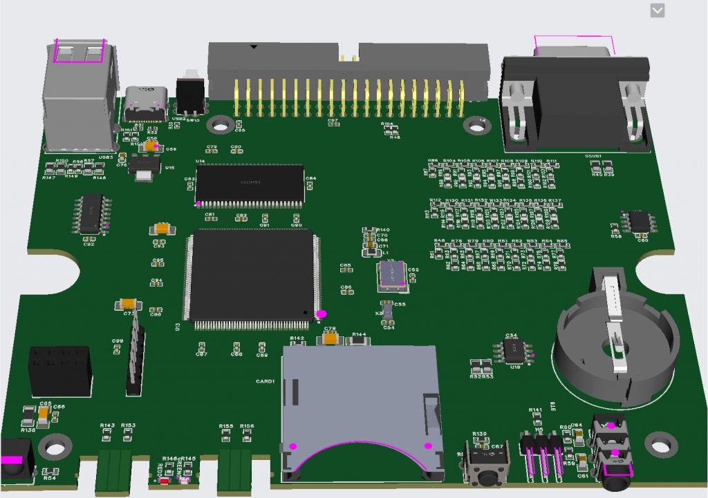

Absolutely, I've just imported the PCB outline from DesignSpark into EasyEDA.
The basic objective is to get the layout onto a more modern platform and do some value engineering so:
Remove as many as possible "extended" range components
The PCB to be able to be built by JLC with NO extra components to be hand soldered
Remove any redundant circuitry
For example, if you look at the circuit it now uses pairs of 120ohm resistors in series to make 240. The 120s are "basic" whereas JLC don't list a basic 240.
Instead of the expensive LED package the new design uses two SMD "side-sticker" leds. I didn't know these existed before but they are LEDs that shine out of one side rather than the top - perfect for the power and disk indicators.
Later today or tomorrow I should have an unrouted layout I can cost at JLC so I'll post that when I have it.

Here is the new layout (still unrouted).
The great news is the price £135 for 5 boards (not including postage and tax) fully completed as you see here - nothing left to solder and ready to pop into a box
Edited 2024-02-25 21:22 by matherp

Beautiful
But is that uSD?
Posts: 12069
Posted: 02:55pm 25 Feb 2024
  Quote  But is that uSD?
No:
The CMM2 firmware implements both card-detect and write protect so I decided to keep with a full size SD to aviod any conflicts
Posts: 9246
Posted: 03:10pm 25 Feb 2024
That's a very clean looking layout. Good price too.

Posted: 03:15pm 25 Feb 2024
Amazingly good price!

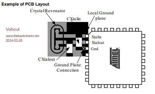

I have not taken the time to dive deeply into the layout, but I notice one thing that could be critical in layout of the board.
You have place the RBG resistor dividers close to the VGA connector. That is good for signal/noise on VGA, but as a result, you are running 24 high speed digital signals accross the board. And when I am right, these run along crystals X2 and X3.
To avoid having the jittering VGA video (as the first blue Waveshare boards had) the crystals need very noise free environment. Ground plane under them, short traces to the STM32, surrounded by a guard trace (ground trace) to avoid any coupling into these crystal traces. Best is to have the ground plane under the crystals isolated from the ground plane, start connected to the ground plane under the STM32 ground pin nearest to the crystal oscillator pins. The 2 capacitors connect to that "crystal ground plane", not to the "noisy" board ground plane.
I hope I have not confused you,
