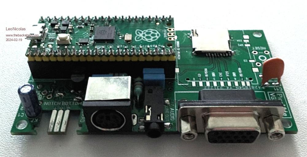

As described by Turbo46 and Volhout, I'm trying to connect a modern mechanical USB keyboard to a PicoMite VGA with a PS2 connector. The direction is:
USB KEYBOARD ==> PicoMite VGA PS2 Connector
I don't have a PS2 Keyboard, and buying one is my last option.
Edited 2024-02-19 03:03 by LeoNicolas

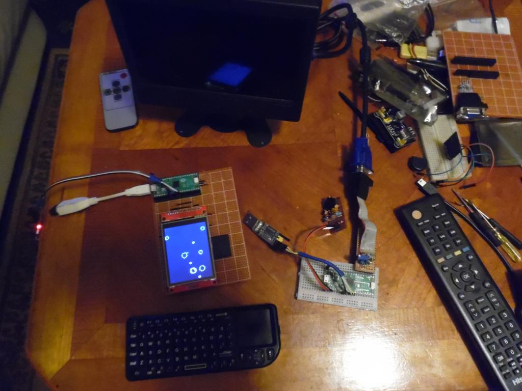

Posted: 07:18pm 18 Feb 2024
chipin in, usb kb works fine vga and lcd. usb to ttl powers picomite VSS pin next to usb.

Posted: 09:05pm 18 Feb 2024
I run picomite from linear 3.3v and 5v reg boards. 3.3v enable to ground.
not really necessary in reality. The usb and power from usb to ttl adaptor is nice

Turbo46
Joined: 24/12/2017
Posts: 1694
Posted: 10:14pm 18 Feb 2024
Jim, I think Leo's preferred option now is to use the USB PicomiteVGA firmware so he can plug the USB keyboard into the Pico's USB socket.
Leo, Can you please tell me which one of of Mick's many boards you have. I can't find it and I want to look at the circuit diagram.
