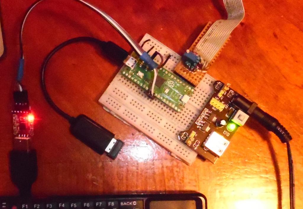

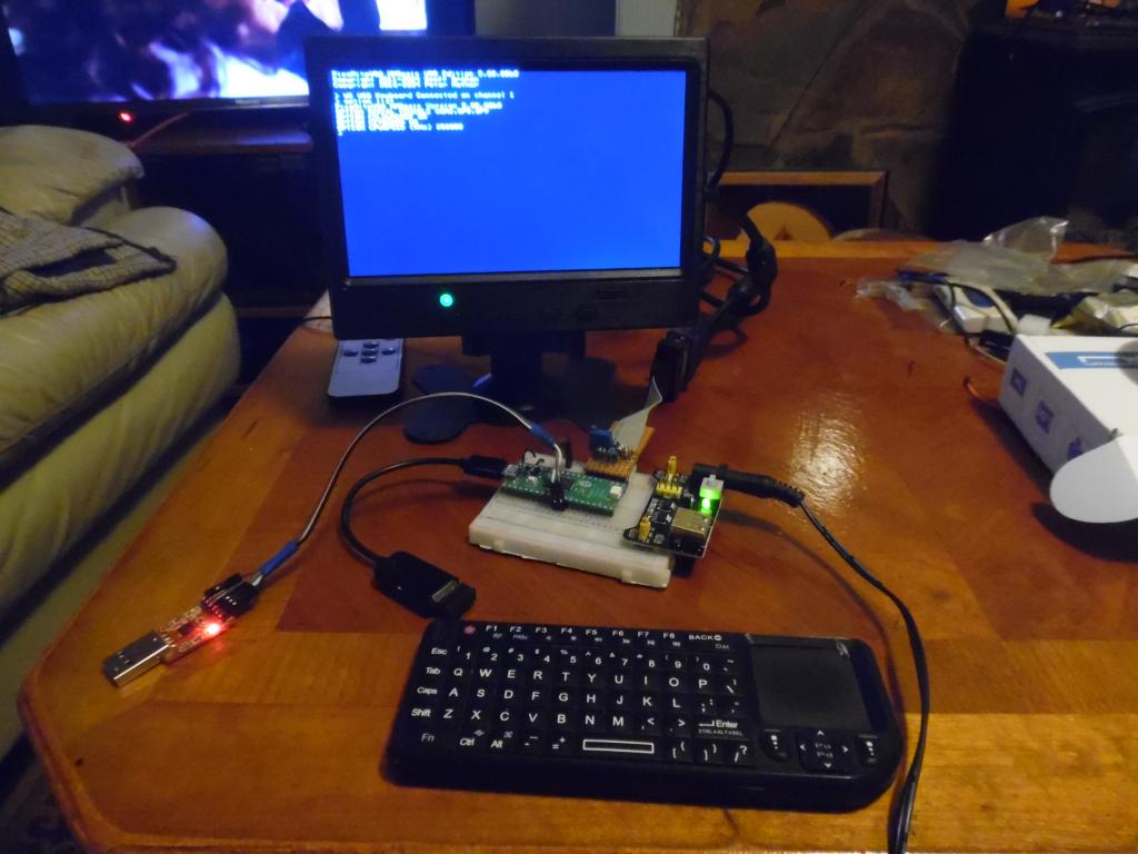

I loaded the vga usb rc and it works with micro wireless keyboard. impressed so posting. haven't tried the usb to ttl yet to program it.
It wasn't what I expected with like a console that takes keyboard commands.
I'm very impressed with usb, nice one, stan
I'm powering the usb to ttl at 5V, is that ok or use the 3.3V pin?

I found connecting the usb to ttl to win pc the converter powered the picomite with no supply and it booted the picomite  and shows as com 10 but it crashes with mmedit. something wrong.
Posted: 01:02am 09 Feb 2024
Sorted usb to ttl. rx tx wrong but ran at 5V now 3.3V. dunno, didn't mess up the pico cos just flashed bubble universe from mmedit so the vga with 7" screen and micro keyboard works as I wished and the usb to ttl works. happy days.
If I turn the 5V to VBUS off, the screen just says usb keyboard disconnected, the pico still runs from the usb to ttl although it's powered to it's 3.3V pin to picomite 3.3V.
The usb to ttl will be powered by host pc 5V so will be 5V logic level??? blow gp??
should the usb to ttl be run through a bi-diectional logic level converter?

I plugged the usb to ttl (that's what is printed on the board) into win pc and scoped tx/rx and 3.6xxx volts. Too high? need logic level converter?
Found external 5V not needed, runs from usb to ttl adaptor.
the 7" monitor and micro keyboard work nice. I code on a pc with full size kb.
mmedit is fine and teraterm.
