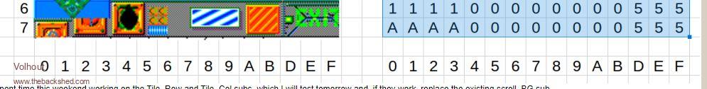

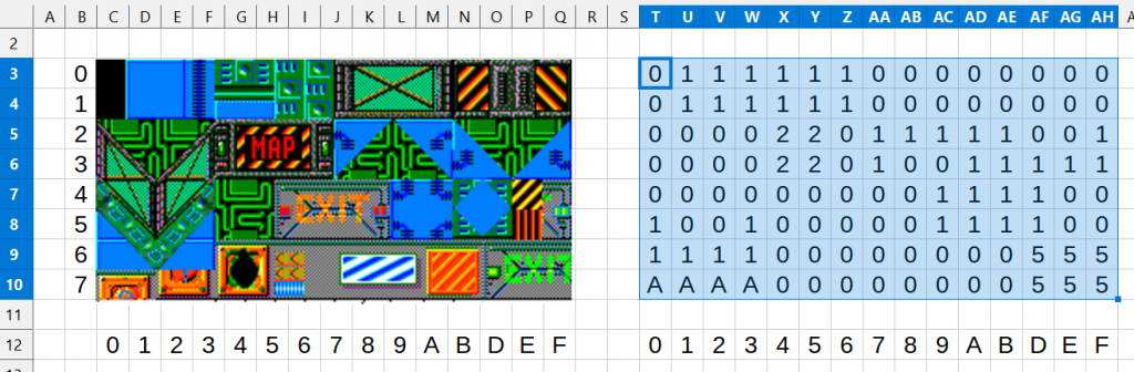

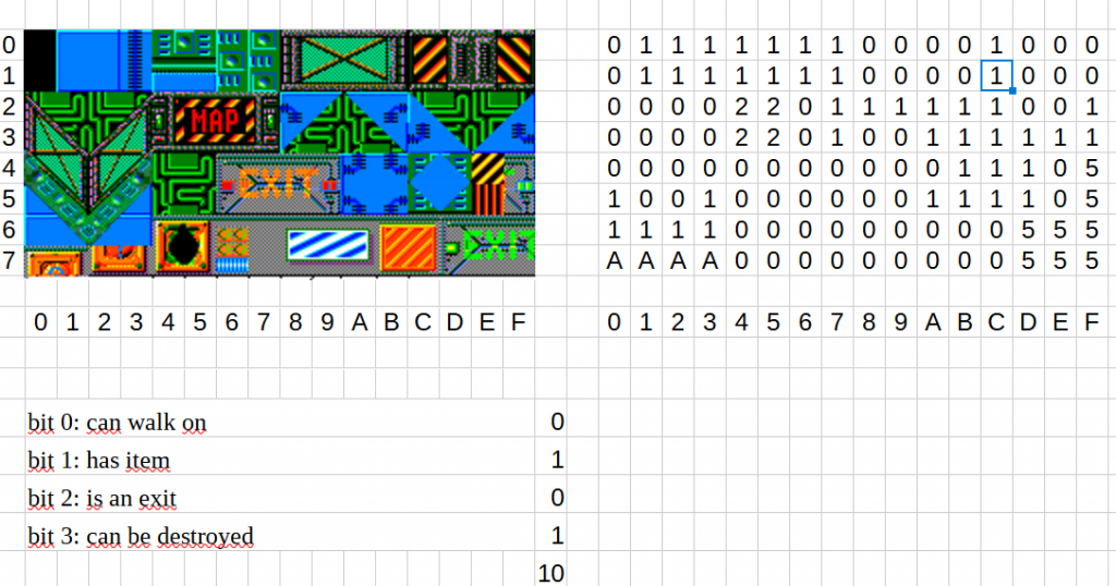

I think in the next version I will attach 128 bytes with the tile attributes to each map so that they can be read with each map.
like this:
I also spent time this weekend working on the Tile_Row and Tile_Col subs, which I will test tomorrow and, if they work, replace the existing scroll_BG sub.
Once the attributes and the new sub-routines have been implemented, it should be possible to walk through the worlds with the player.
Martin

Hi,
Nice overview Martin !!
This definitely helps in development
Maybe you could also add a column "C" ? (in 0,1,2...E,F, the C is missing).
I am sure you wanted to see if I was awake....yes I am !!
Edited 2024-02-19 22:01 by Volhout
Ups ..
you're right of course, and I didn't notice.
That's what happens when you do something like that (quickly) before you go to sleep.
But it explains the principle of how I will assign the attributes to the tiles

Posted: 07:38pm 19 Feb 2024
  Volhout said  Hi,
done
