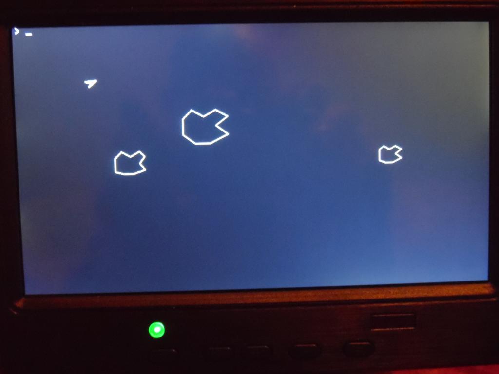

Posted: 05:17pm 21 Jan 2024
strange with ili and non vga
https://www.youtube.com/watch?v=RWVrMc5veOY

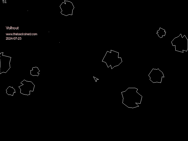

Posted: 07:04am 23 Jul 2024
Pete, Stanley,
Anyone object if I take this a bit further ? There have not been updates for some time, but in the background you could have been working on it.
I am aiming at 640x480 to closer mimick the original monochrome vector graphics.
