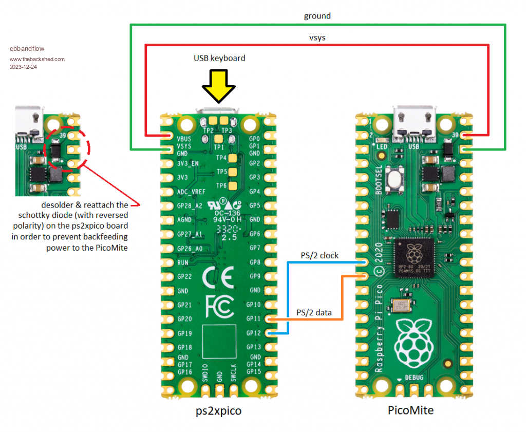

Posted: 04:32pm 23 Dec 2023
Awesome find in the ps2x2pico! Here's what I'm going to try for adding a USB keyboard... I figure the level shifting is pointless when communicating from pico to pico. Also going to desolder and reverse the schottky diode to prevent power backfeeding the picomite. Thoughts?
Edited 2023-12-24 02:40 by ebbandflow

>>confused<<
That diode is forward from the USB input (VBUS) to VSYS. It's there to protect the PC. Reversing it is to allow VSYS to power the USB keyboard, not to protect anything. If you want to power a USB device from a Pico then power the Pico via VBUS rather than VSYS.
Alternatively, you can simply link VSYS and VBUS when the USB port *isn't* connected to a host.

Posted: 06:32pm 23 Dec 2023
  Mixtel90 said   That diode is forward from the USB input (VBUS) to VSYS. It's there to protect the PC. Reversing it is to allow VSYS to power the USB keyboard, not to protect anything. If you want to power a USB device from a Pico then power the Pico via VBUS rather than VSYS.
My intent is to prevent the picomite from booting if a powered device is accidently plugged into the keyboard USB port on the ps2X2pico.
Reversing the diode on the ps2x2pico board ensures that the system can not be powered via the 'dedicated keyboard USB port', that it will only supply system power to the keyboard not vice versa. That's what I'm thinking anyway! Testing and quite possibly magic smoke shall decide! xD

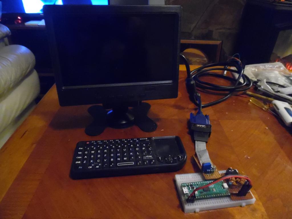

I only use picomite and thought usb keyboards/and controller pads so cheap, can't use though.
cheap wireless tiny kb and pad.. with laser pointer??
with 7" monitor.. would be nice.

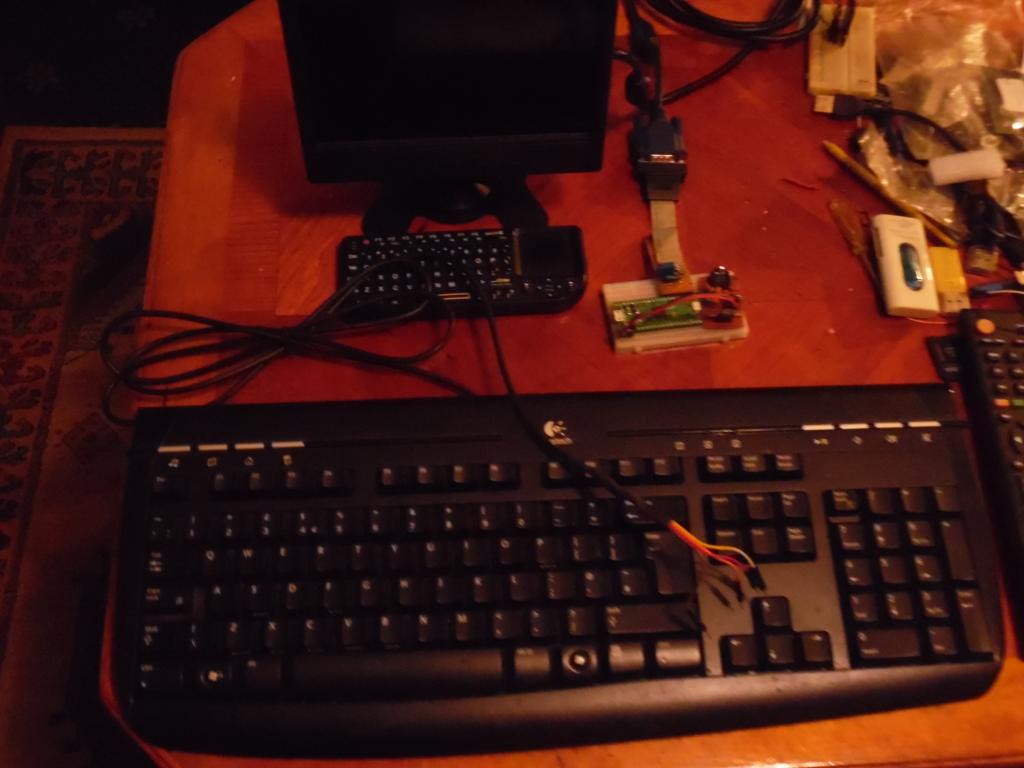

Posted: 09:27pm 23 Dec 2023
I dug this kb from many "in a drawer 10 years", cut of ps2 plug,works at 3.3 V but too big.
I meant desk space. I don't use the kb mostly.

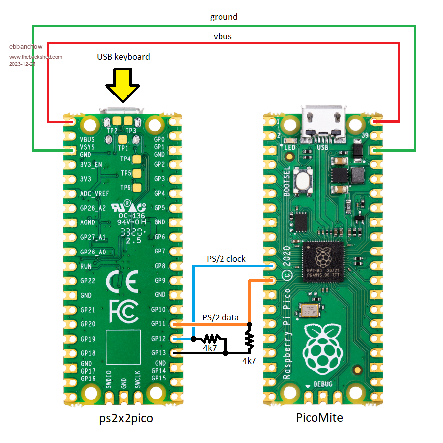

Well, I have a USB keyboard > ps2x2pico > picomite running on my desk and I'm quite pleased!    I downloaded and flashed the ps2x2pico as outlined here: https://github.com/No0ne/ps2x2pico#usage  but I wired it up as shown below. Now that it's working I plan to experiment with reversing the diode (per my previous post) and joining vsys of the picos together instead of vbus.
Edited 2023-12-25 03:28 by ebbandflow
ebbandflow
Joined: 31/08/2023
Posts: 62
Posted: 07:32pm 24 Dec 2023
Minor setback... the USB keyboard does not seem to reconnect after a power cycle unless the ps2x2pico is reset via the run pin. I think I'll need to reset the ps2x2pico on boot using a spare pin on the picomite or maybe just build an auto reset circuit.

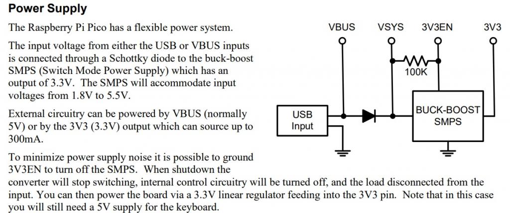

Posts: 9246
Posted: 08:46pm 24 Dec 2023
The Schottky diode is built in. There's a diagram showing the Pico's power arrangement r the beginning of the manual.
Posted: 09:07pm 24 Dec 2023
  Mixtel90 said  The Schottky diode is built in. There's a diagram showing the Pico's power arrangement r the beginning of the manual.
I always thought you added it. I run some picomites fro 3.3 lin regs for noise reduction but you can live with the switching supply imho.
Posts: 9246
Posted: 10:16pm 24 Dec 2023
The diode is there because you can damage the USB ports of some PCs if the PC is powered off while there is still a supply on the USB input. VBUS is connected directly to the USB 5V on the Pico and the diode comes off that to feed VSYS, which thn feeds the input of the switching reg. By powering the Pico from VSYS the USB on the PC is protected.
The clone Pico boards don't always have the same system. If you are going to use one then it's important to check its power circuit.
