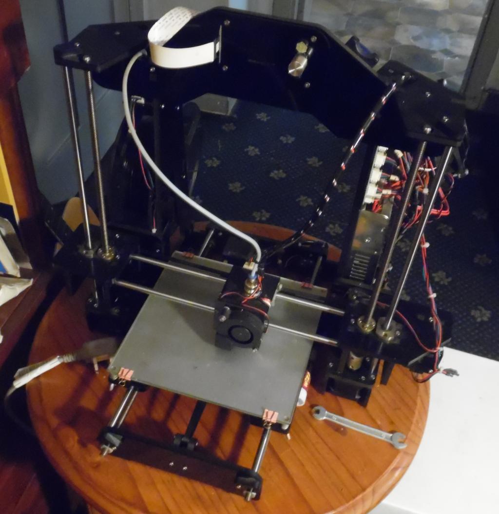

I use a £70 ebay flatpak build yourself kit and it's fine. problem is you have to copy the print file to a sd card then insert the card in the printer, there's no usb lead.
amazing the control board only uses a 328p.

  stanleyella said  I use a £70 ebay flatpak build yourself kit and it's fine. problem is you have to copy the print file to a sd card then insert the card in the printer, there's no usb lead.
Yeah, nothing wrong with that. Especially the price. :)

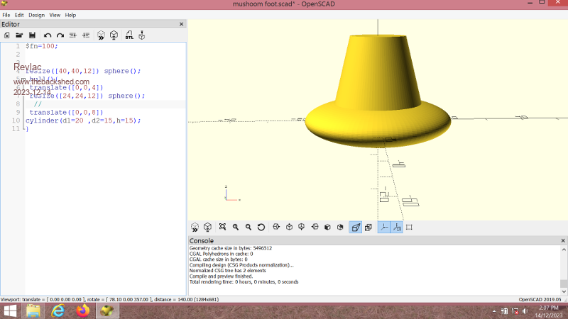

Just a few lines in OpenScad, mushroom is easy, its incomplete but anyone can play with it and make the way they want, I don't know the exact dimensions of that one in Bunnings, this should be fairly easy in any CAD I guess, just use the one your familiar with, I'm no expert with any of this.
$fn=100;
resize([40,40,12]) sphere();
hull(){
translate([0,0,4])
resize([24,24,12]) sphere();
translate([0,0,8])
cylinder(d1=20 ,d2=15,h=15);

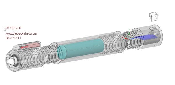

For mechanical 3D modeling I use DESIGNSPARK MECHANICAL (free version does not allow import STL, but do not need that) https://www.rs-online.com/designspark/home
My random creation/enclosure

Easy enough to load and then paste in Aaron's 'mushroom' from above.
I'm tinkering already.

  Revlac said  hull(){
Had to look up "hull". That was a new one on me. :)

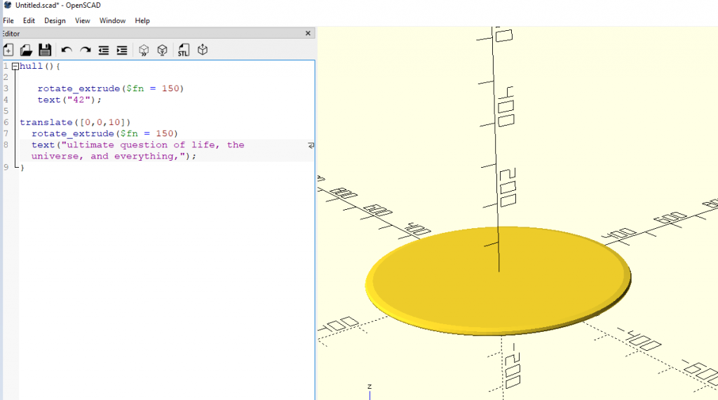

So that's umm, different. Try changing the "O"s to something else.
