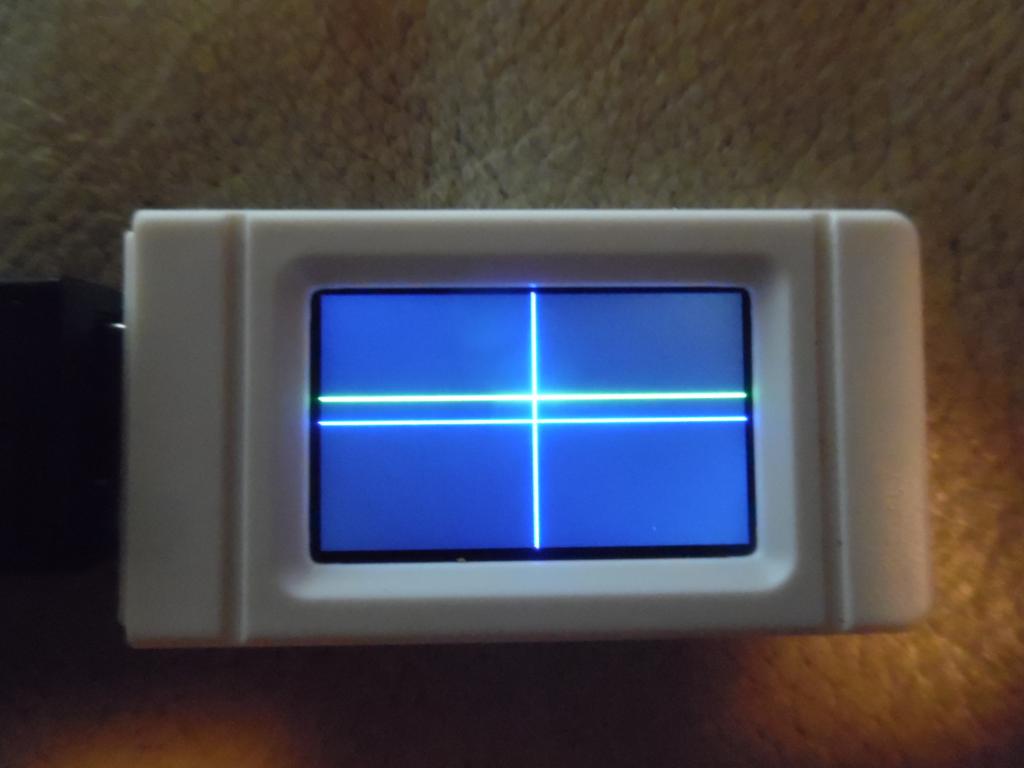

I got no idea how to set this up Volhout. strange errors. how to clear pins?
RUN
[9] ADC open 500000,3
Error : Invalid frequency
> C:\Users\stanley555\Documents\mmbasic programs\160x80trigscopev07.bas
Uploading using:  'target port\COM9:115200 s\picomite
Upload started
NEW
AUTOSAVE
Upload completed 1
Saved 862 bytes
Time taken: 2625mS
RUN
[9] ADC open 50000,3
Error : Pin GP28 is not off or an ADC input
Upload started
NEW
AUTOSAVE
Upload completed 1
Saved 875 bytes
Time taken: 2673mS
RUN
[7] SetPin GP28,off
Error : Pin 34/GP28 is reserved on startup
 'SetPin GP28,pwm1A 'this optional test signal comment out
 'PWM 1,10000,50  'square wave ,this optional test signal comment out
'SetPin GP28,off
 dim c%,x%,samples!(480)
 SETPIN GP26, AIn
 adc open 50000,3
 FRAMEBUFFER CREATE F
 FRAMEBUFFER LAYER L
 FRAMEBUFFER WRITE L
 line 0,mm.vres/2,mm.hres,mm.vres/2,,rgb(blue)
 line mm.hres/2,0,mm.hres/2,mm.vres,,rgb(blue) 'draw cross to layer L
 'line 119,0,119,239,,rgb(blue)
 'line 0,119,239,119,,rgb(blue)
 FRAMEBUFFER WRITE F
 do
   adc start samples!() 'get new samples
   'trigger
   c%=0
  do:If samples!(c%) > 0.1 then if samples!(c%+1) < 0.2 then exit do
inc c%:loop while c%<160
math scale samples!(),239/3.3,samples!()'scale to 80 pixel height
FRAMEBUFFER COPY L,F
for x%=0 to 238 'screen width
     line x%,samples!(x%+c%),x%+1,samples!(x%+1+c%),,rgb(green) 'draw new sample from sample(c%)
next x%
FRAMEBUFFER COPY F,N
loop

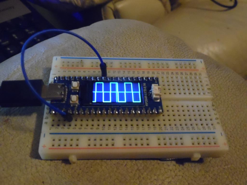

Posted: 11:06pm 06 Feb 2024
  Mixtel90 said  Only ADC2 (GP28) and ADC3 (GP29) are brought out, by the looks of things.
You can't use ADC0 (GP26) and ADC1 (GP27).
duhrrr?, so no pwm, or much else? nice display, just loaded bubble universe version.
bubble burst. the 160x80 version was better imho, more normal. geek was sold as it is not the 160x80 in a case so my fault... but still could be useful... or not.
Posted: 11:15pm 06 Feb 2024
  Mixtel90 said  You can't use GP26 as AIN. You can't read it.
ADC OPEN accepts n_channels as the number of channels. You can't use the first two as they aren't available, so set it to 3. Then you'll get GP26, GP27 and GP28.
You'll have to use GP28 as the input.
thanks but I get
RUN
[9] SetPin GP28, AIn
used by lcd
