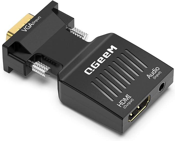

in order to become mass-marketable the CMM2 (or its successor) needs to have an HDMI-compatible video output (DVI over HDMI is fine, with sound on a 3.5mm stereo socket) and solid USB support for keyboard and mouse.
I agree, however, I think Grogster is right, the HDMI is a licensing issue. Having said that, I use a cheap VGA to HDMI convertor, and I would suggest that we could ship that with the unit. Again, the problem for customers is finding all of the right peripherals that work with the CMM2 - the right keyboard, the right HDMI convertor (not all worked).
It would be even nicer if we could mount the HDMI convertor inside the case, but lets walk before we can run. Yes, I know all of these things add $10 here, $10 there, which pushes up the cost of the final product, but they are barriers for a lot of people. Yes, there will always be the enthusiast who's happy with the bareboard, but if you want to just pull a machine out of it's box and plug it in, you don't want to be buying three different keyboards in the hopes that one of them works.
https://www.amazon.ca/Jmday-Adapter-Samsung-Computer-Projector/dp/B07F1K3QQX/ref=dp_prsubs_sccl_2/132-3230169-5628127?

  Grogster said  People like the Raspberry Pi Foundation, have a contract with the HDMI people for licensing the use of the HDMI technology on their boards either arranged by them, or via Broadcom who supply the ARM chips at the heart of the Raspberry Pi boards.
If using the sort of adapter shown above its manufacturer would most likely have licensed it, If that is required.
If the output is just DVI through a HDMI socket it is likely no licence is needed as they are not using the HDMI protocol.
