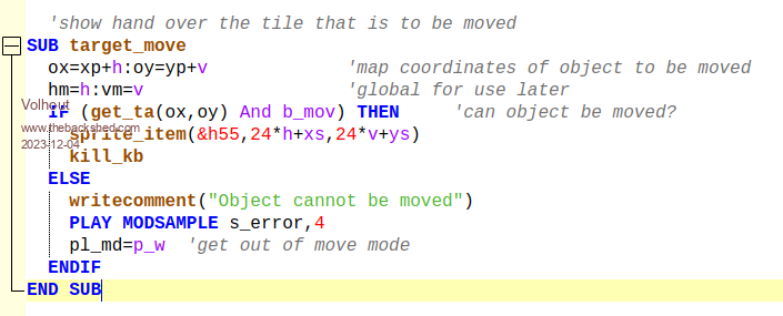

For Tom: The "kill_kb" in below code fixed it in the earlier version
