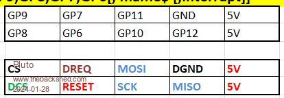

Posted: 09:41am 28 Jan 2024
Seen from the component side of the VS1053 board:
OPTION AUDIO VS1053 GP10,GP11,GP12,GP9,GP8,GP7,GP6

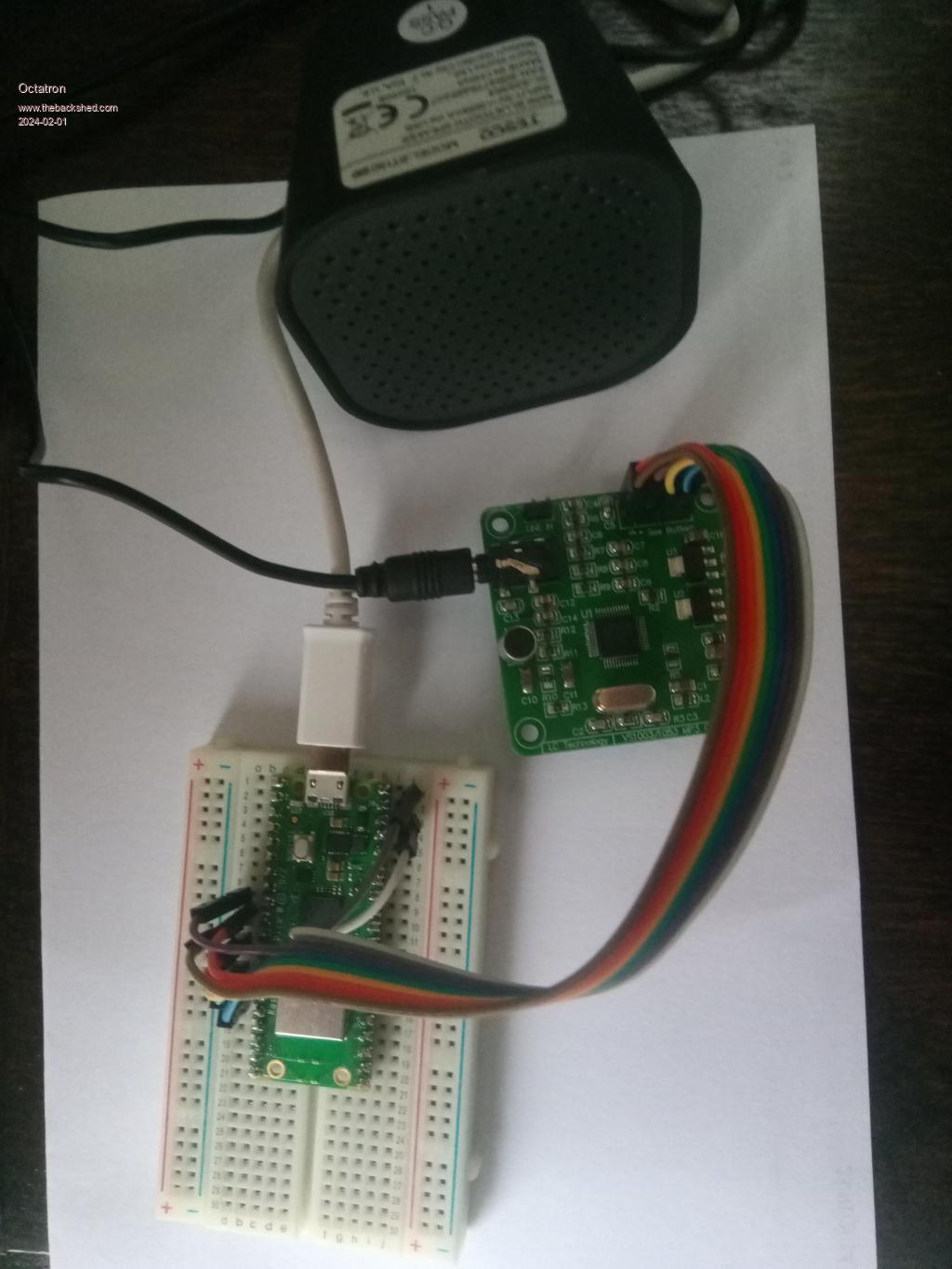

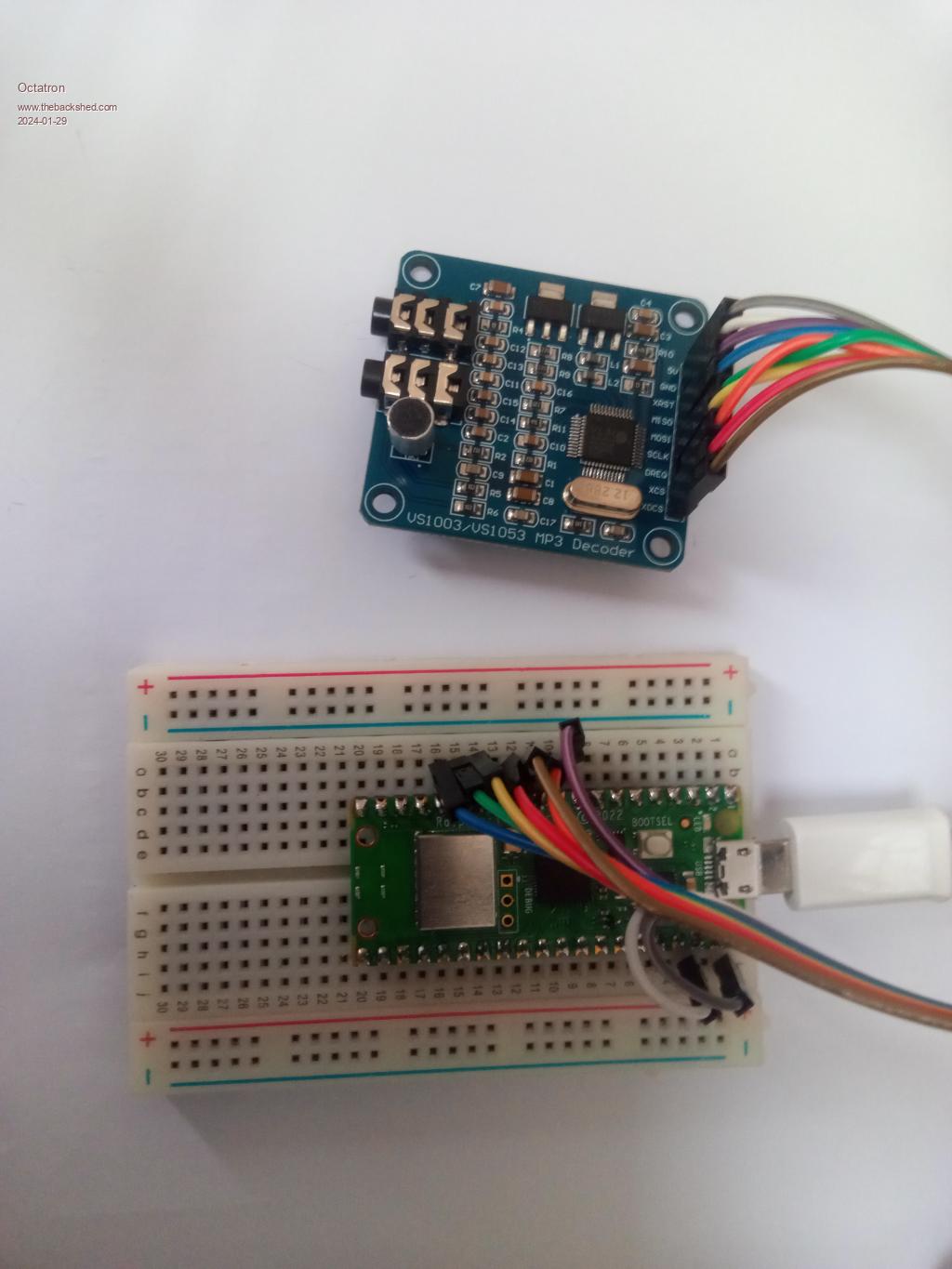

Joined: 01/04/2015
Posts: 29
Posted: 02:56pm 28 Jan 2024
Thanks for all your responces. Answers to questions.
Maybe stupid suggestion.(All suggestions accepted)
You are using the correct pins? Gp8 is not pin 8 of the pico.
Yep, correct pins used.
Does the module have power? Measure with voltmeter.
Yep and requlators giving correct voltage
Does the wiring actually connect (broken wire)
Yes just checked that out
Are you using the same board as Matherp in first post of this thread?
No it's slightly different, see photo.
This one is important - it definitely doesn't work at 3.3V
Initially I had it on 3V3 but then noticed on the V1053 board it said 5V so swapped it over to VBUS 5V.

Octatron
Joined: 01/04/2015
Posts: 29
Posted: 03:17pm 28 Jan 2024
I think I have found the problem. The chip on the board is a VS10033 not a VS1053 and according to VLSI's website there are differences.

Posts: 9246
Posted: 03:30pm 28 Jan 2024
Your wiring looks right.
if you have a multimeter, have you checked through from the VS1053 to the actual Pico pin - just in case it's a faulty connection on the breadboard?

Joined: 01/04/2015
Posts: 29
Posted: 05:04pm 31 Jan 2024
New VS1053 board has arrived connected it up and it works, wonderful.
Previous board was sold as a VS1053 but it had a VS10033 chip (should have spotted it earlier), now on the way back to the supplier for a re-fund. So I'm up and running, thanks for the help.
