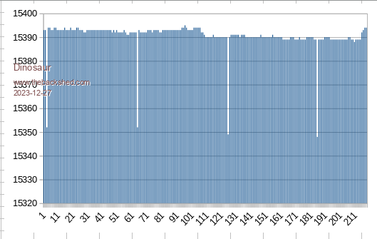

Joined: 12/08/2011
Posts: 360
Posted: 12:51am 27 Dec 2023
Hi All
Just an update for anyone using the Pico for pulse counting.
The chart below shows that on every interrupt (60 secs) the count gets corrupted.
So have to edit the reading so that this reading is ignored.
Otherwise getting 4mA stability with no Input on the ACHS7123 and connected to an AD654.

Posted: 08:34am 27 Dec 2023
If you can make the shortest simple version showing it then you've a chance either your or the Pico bug will get attention & be fixed.

Posted: 10:00am 27 Dec 2023
It may be a non-issue or one that can be fixed but only if there's a (short, self-contained) example to reproduce it.
