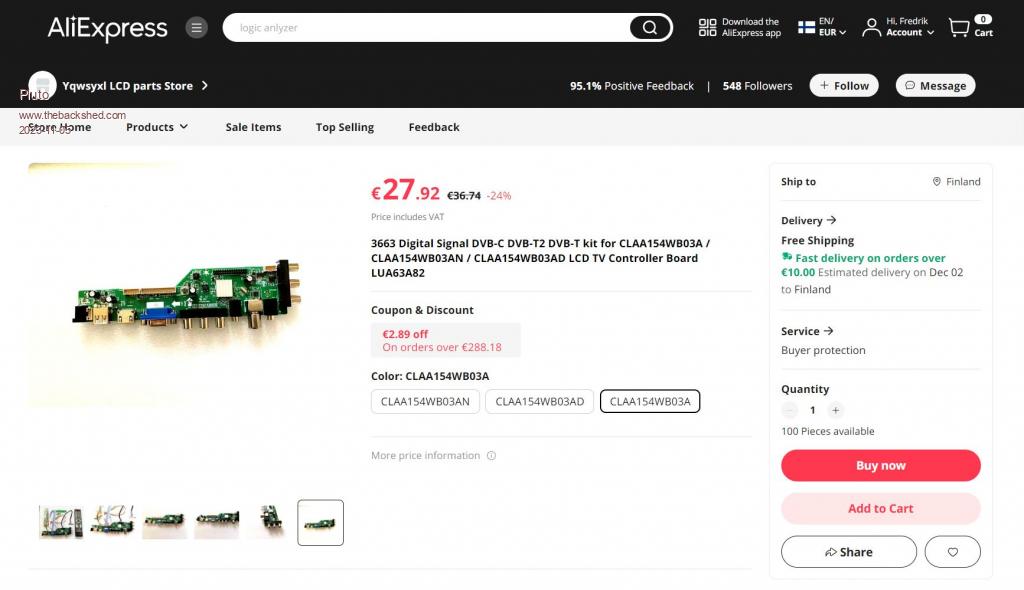

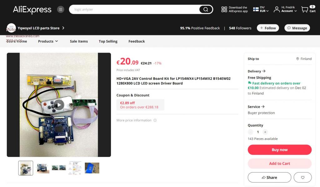

Posted: 04:23pm 03 Nov 2023
@pluto and other
Aliexpress links will not work in all country , so please post a screenshot also .this will help us for searching in Ali.
Thx
Plasma
Pluto
Joined: 09/06/2017
Location: Finland
Posts: 421
Posted: 05:26pm 04 Nov 2023
Plasma, screenshots enclosed.

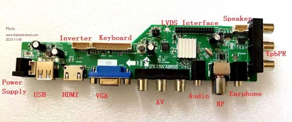

Pluto
Joined: 09/06/2017
Location: Finland
Posts: 421
Posted: 11:56am 06 Nov 2023
  John said  Interesting... what is the interface (*) for that if you know?
(*) other than the TV aerial / cable :)
LCD Controller Board:
HDMI VGA AV USB ATV DTV LCD Board Work for LVDS Interface LCD Screen
Input Power Adapter:12Vdc More than 2A.
Come In Standby Model When Not Input Signal
Standby Model <1W
HDMI Port Support Transform Audio Compatible With HDMI 1.3/1.4,HDCP 1.2
USB Support Video
AV Compatible With PAL And NTSC
Video Input: HDMI VGA AV USB ATV DTV
ATV: 48.25MHZ-863.25MHZ PAL/ SECAM
DTV: VHF (50MHz ~ 230MHz) UHF (474MHz ~ 862MHz) DVB-T DVB-T2 DVB-C
Audio Input: HDMI PC-Audio
Audio Output: Speaker Connector
OSD: Brightness Contrast Auto Language And So On
Language:English French German Spanish Italian And So On
Board Size:183mm x 43mm x 17mm
For PicoMiteVGA: 12V in to the LCD controller board and 5V out to Pico. VGA out from Pico and into the bord's VGA.
Main use: PicoFrog and Tiles machine for the grandchildren (5a and 7a).
Fred

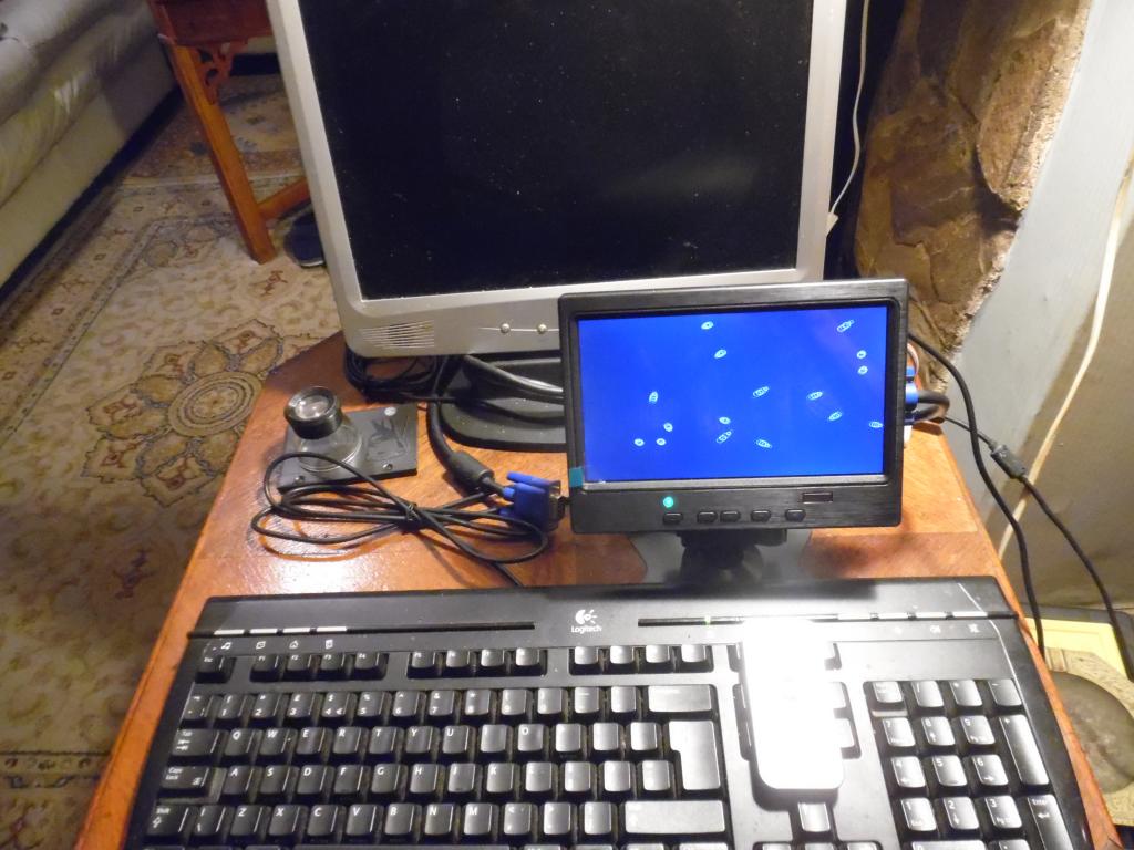

Posts: 6199
Posted: 09:53am 10 Dec 2023
I have been using the display in the first post, and it is amazingly sharp and bright on the PicoMiteVGA. Good picture, good colors, viewing angle is great.
I power it from one USB port of the laptop with the included cable.
The other USB port is for the PicoMite
Third for the mouse (not a touchpad guy).
Good investment. I can write code on the kitchen table without the larger 19" screen.

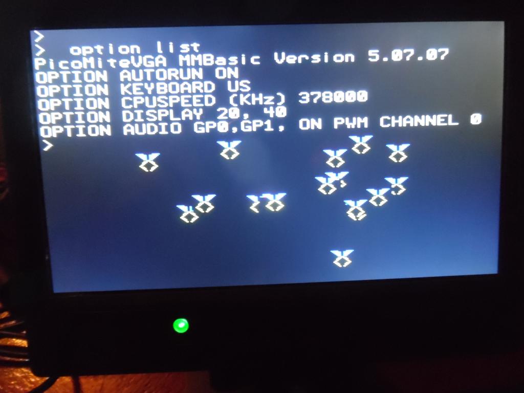

Posted: 07:58pm 18 Dec 2023
This arrived and vga pico is fine for 7". No sound but shows avi socket but none so hdmi no sound either.. do I moan or it's useful?
edit.. it's great. mode 0 320x240 fine. could replace my monitor. just need a small ps2 keyboard.
not what it said,no av just composite phono.no hdmi sound.. no sound... but nice picture.
Edited 2023-12-19 06:42 by stanleyella
