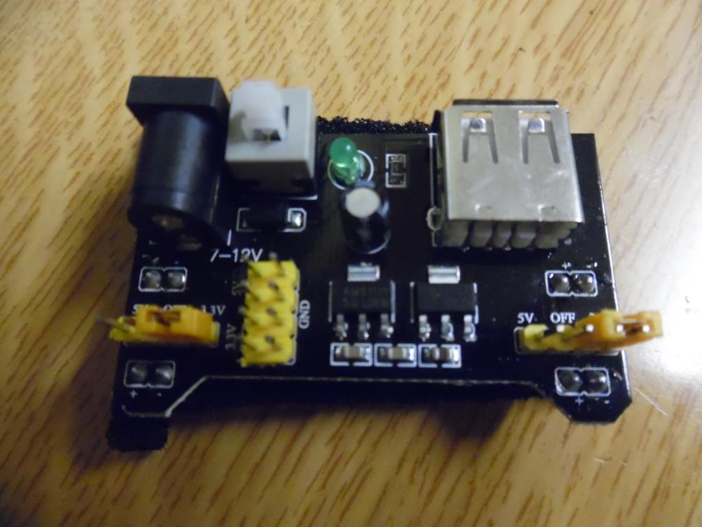

These are handy for vero. £6. 5v & 3.3v
These are cheap.. what's the postage though? https://cpc.farnell.com/stmicroelectronics/ld1117v33/v-reg-ldo-3-3v-1117-to-220-3/dp/SC08302

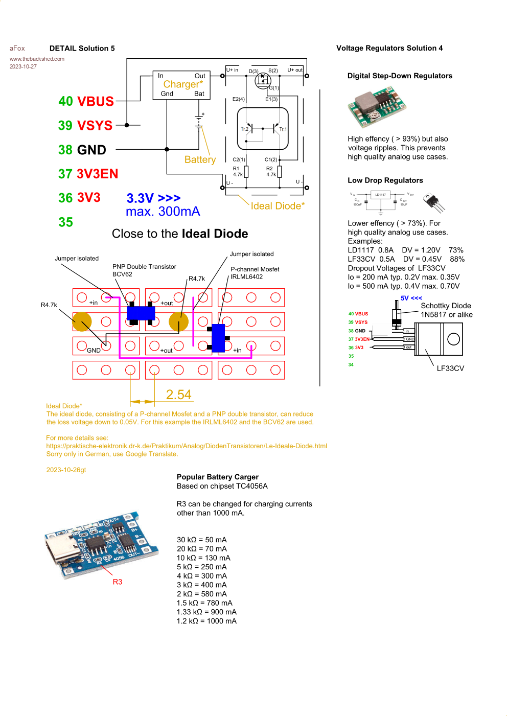

Cheat Sheet Update
Many thanks for your help.
I have changed the Mosfet part because I found a detailed Ideal Diode description.
For more details see:
https://praktische-elektronik.dr-k.de/Praktikum/Analog/DiodenTransistoren/Le-Ideale-Diode.html
Sorry only in German, use Google Translate.
I have not problem to get the suggested parts here in Germany.
What is in your country?
Comparsion Types:
P-channel Mosfet IRLML6402?
PNP double transistor BCV62?
Pico Power Supply Cheat Sheet 2023-10-26.zip
Any suggestions are welcome!
Gregor
Edited 2023-10-27 10:21 by aFox

I just noticed that the capacitors are missing next to the LF33CV.
Practical suggestions?
Gregor

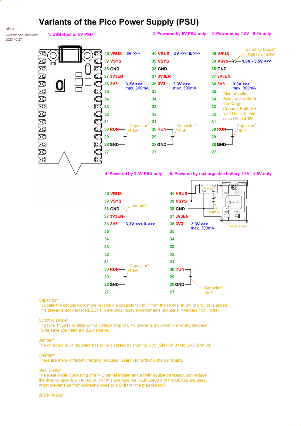

I think we have to talk also about the Jumper in Solution 4
because if we use the USB port for a program update.
Do we get in trouble?
Do we have 5V on the 3.3 port (Pin 36)?
Gregor

Posted: 01:53am 27 Oct 2023
 " NO ! "
      Wayne  !
Posts: 3417
Posted: 04:52am 27 Oct 2023
Expanding the above answer, the jumper only inhibits the on-board regulator. It does not bypass it.
Solution 4 only runs from the external 3.3V supply while the jumper is on. Firmware loading proceeds as normal.

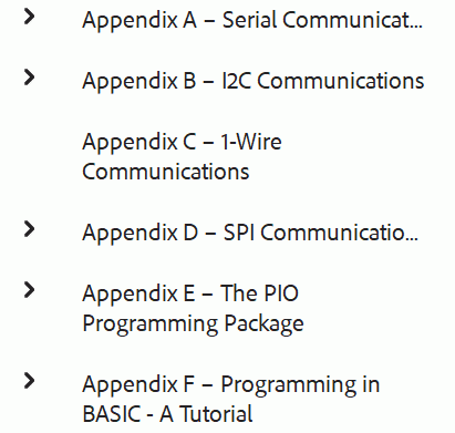

  JohnS said  Otherwise where do you draw the line? I2C, SPI, RS232, 1-wire, Ohm's Law, electrons, quantum physics, ...
PicoMite Manual:
Ok, no Ohm's Law or quantum physics, but I think this particular cheat sheet on powering the PicoMite would be worthwhile in an Appendix.

All those are specific to MMBasic though, they aren't general information (although F is perhaps a bit more general). It's not information you are likely to come across anywhere else.
Powering something at 3V3 or 5V0 via diodes, MOSFETs, switching regulators (buck, boost and buck/boost), linear regulators (fixed and variable), batteries and chargers, solar cells etc. is all general electronics. There are thousands of references. There's no need to repeat it simply because two Pico has some power supply components (already documented elsewhere) on it. The manual *does* show w to power the PicoMite, it just doesn't show the many possible variations, which most people with any electronics knowledge will either already know about or will be able to find easily.
