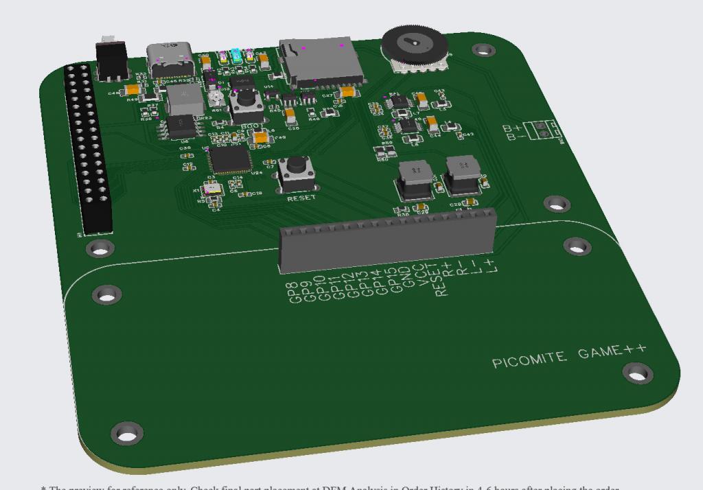

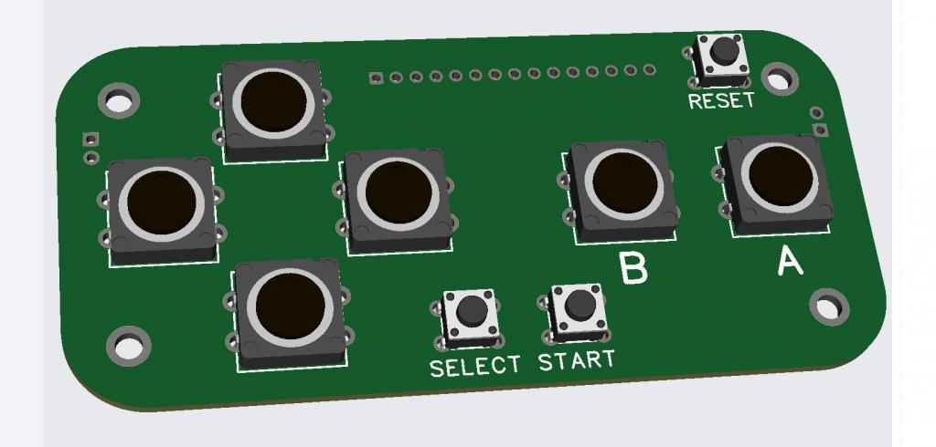

I've taken on board various comments and the result is
Schematic
4f2bc1ad-a3a1-4e76-a19d-0b97ed4f405b.pdf
Changes are:
All user switches now on a daughter board together with the terminals for the speakers
10k pot added to the charge circuit
micro-SD slot added
Volume control, switch, USB-C, LEDs, and sdcard all on top edge for easy access in a "box"
Unfortunately the main board is now 110mmx100mm which has a small impact on price (GBP6.77 vs GBP1.65 for 5) but there simply isn't room for a decent switch layout below the 3.2" 8-bit parallel ILI9341.

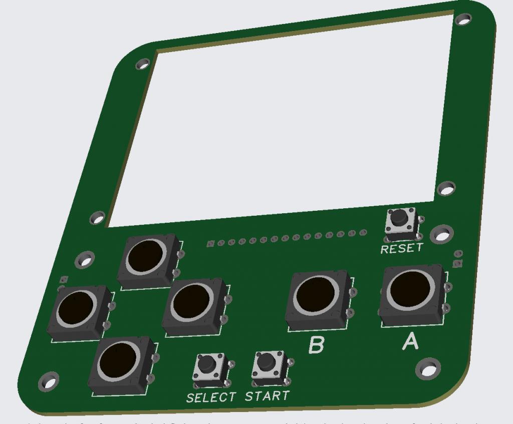

Here's an idea. Why not make the switch PCB a bezel for the screen?
Posts: 9246
Posted: 04:33pm 28 Oct 2023
Because, if you use the Chinese buttons that Tom used, the buttons may be too high. The top clips onto the switch base and has a lip round it, intended to come up against the inside of the top plate. I discovered that putting the button board on 5mm spacers brought the lip up to about the same level as the front surface of the display. Of course, you can't fit a SIP connector in the 5mm gap.
Posted: 04:55pm 28 Oct 2023
I like the bezel (I had/have similar ideas for the Game*Mite), but like Mick says you would need to make sure you used SMD buttons on the "daughter-board".
I was going to suggest that you could get the main PCB back to 100x100mm by having the daughter-board overhang the main PCB by 10mm, though that isn't compatible with using it as a bezel, unless the bezel is then "outsize".

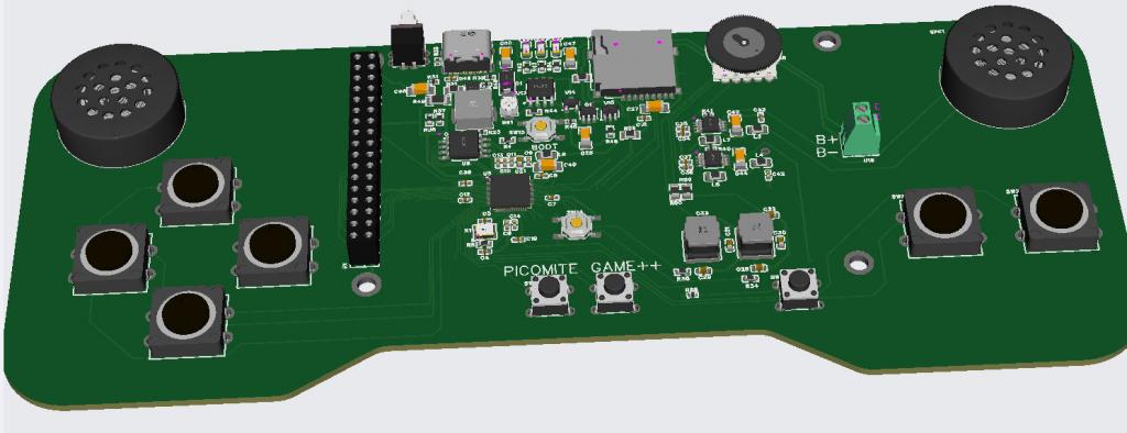

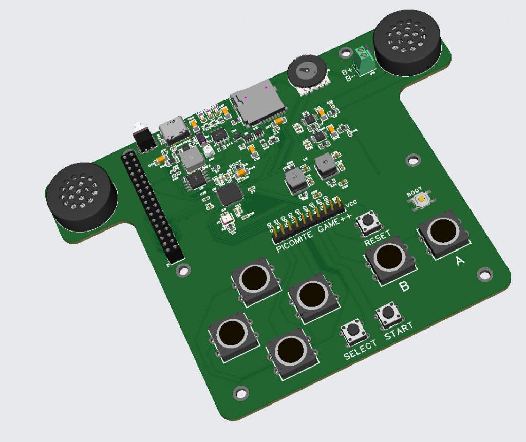

Courtesy of Mick's PCB design
LCD will mount direct without a connector and a top bezel cutout will hide the battery with the display, speakers and switches poking through
Edited 2023-10-29 07:50 by matherp
Posts: 9246
Posted: 07:32am 29 Oct 2023
I wonder why that appeals to me?  ;)
Did you need to scale it up for the 3.2" display? I didn't design it round that one.

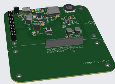

Here's the final version. Because the display will mount direct to the board the level of the switches and screen should be good. I'll get a couple made and then release the gerbers. When they arrive I'll also do a 3D print box design
4683d882-0388-4721-a757-f82ebdc0fd66.pdf
All parts are in stock at JLC but it probably makes sense to fit the switches yourself so you can chose the exact type and the two headers should be omitted (included for clarity)
Cost for 5 boards with all components as shown GBP98.4 plus shipping and any relevant taxes. Cost with all through hole components omitted GBP74.88
Edited 2023-10-29 22:39 by matherp
