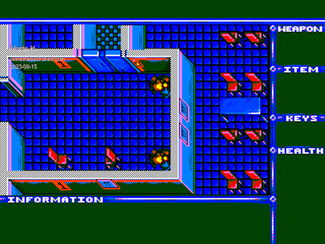

I'm currently in the process of adapting/convert/repaint every Tile into.spr Files.
Here is How it could look like on the Pico
with this Layout we are able to hide 53 Tiles under the Border
Edited 2023-09-15 21:06 by Martin H.

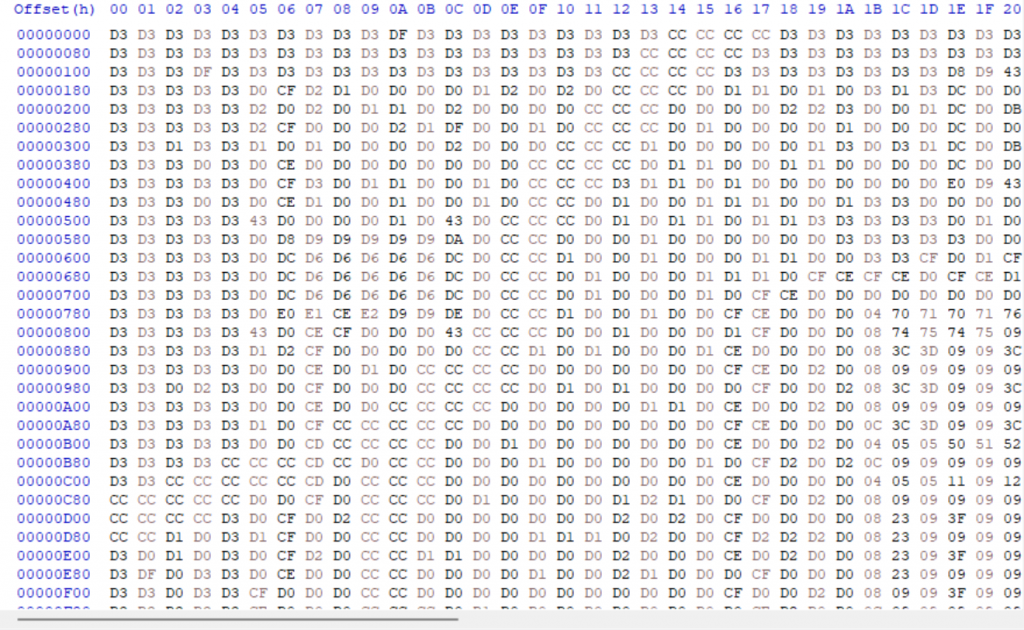

I downloaded the user manual for the game. It shows (some of the) the maps.
Maps are 128 x 64 tiles (8kb when 1 byte per cell).
To make life easier, I suggest
The tiles (you are converting) should be grouped in 2 groups
1/ static tiles (floor/walls/grass/water/etc), there should be 127 of these maximum
2/ dynamic tiles (explosions, movements (opening doors), player, robots, etc..)
On the world map any number < 128 will directly translate into a tile
Any number > 128 will be an AI unit. The AI unit has a attribute list. In this list is the related tile number(s) depending on it's state. The AI tile can be any tile 0...255).
This allows to keep a compact world map.
I also have been looking at the video (part 1 is most interesting).
From that I derive:
world_map (x,y)
each cell (byte) contains a base tile number
if number < 128 then tile
if number > 127 then AI unit under/on tile
tile_attrib (128)
each cell (byte) contains tile capabilities (taken from youtube film David)
bit 0 = can walk on it
bit 1 = can hover over it
bit 2 = can be moved
bit 3 = can be destroyed
bit 4 = can be see through
bit 5 = can push onto
bit 6 =
bit 7 =
AI unit_attrib (128,8)
each object can have capabilities (taken from youtube file David)
byte UT = (unit type .. robot/door/etc...)
byte X = X coordinate
byte Y = Y coordinate
byte A =
byte B =
byte C =
byte D =
byte H = health (or hit points)
Edited 2023-09-15 23:30 by Volhout

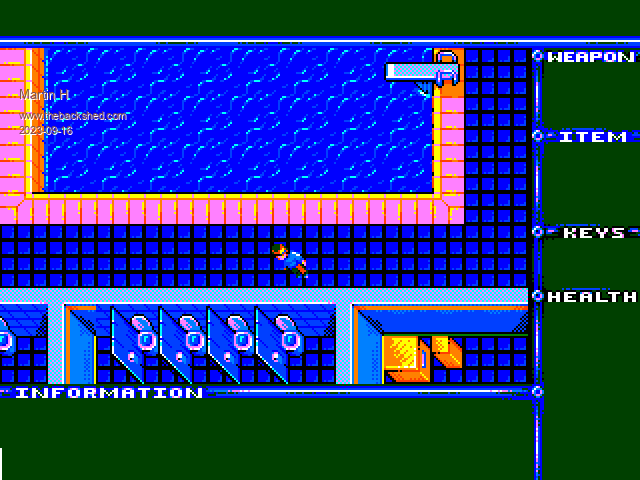

so here is my work so far ...
All Levels, Tiles and most of the Sprites..
There is a little test program,
I haven't optimized anything here yet because it's just for illustrative purposes.
PETSCII.ZIP
The assignment of the tiles to the maps is not yet correct but I've moved enough pixels for today.
