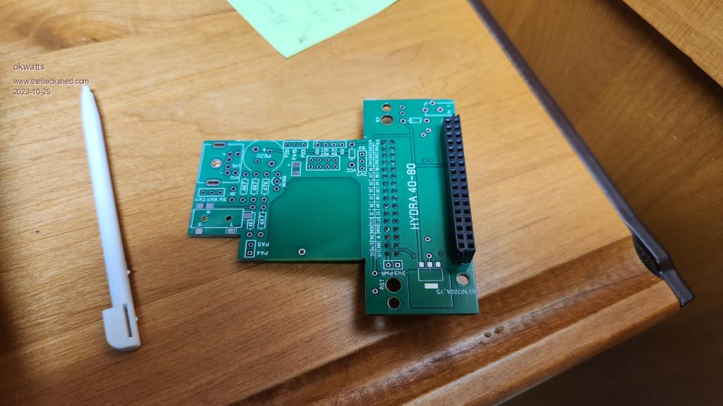

Hey Mick (&lizby) I soldered just the connectors for the display to the Hydra40-80 (revised gerbers) and shorted the links for the "old" dev board. I've noticed something unusual (at least to my understanding) that when I plug in the ips display the USB port disappears. I can connect through the serial console and then turn it off remove the display and I'm back to using the USB. Is there an explanation since I have not brought power to the Hydra from the dev board. Is that lack enough to explain this?

I had a look and it appears there are 2 issues. the first is that without the power input to the hydra40-80 there is no power to the IPS display since the pnly power from the F4 board is 3.3v at the display connector. The other larger issue is I believe the connector for the IPS on the HYdra40-80 is not flipped to match the mounting of the display on the top side. I enclose a picture of my board as built.

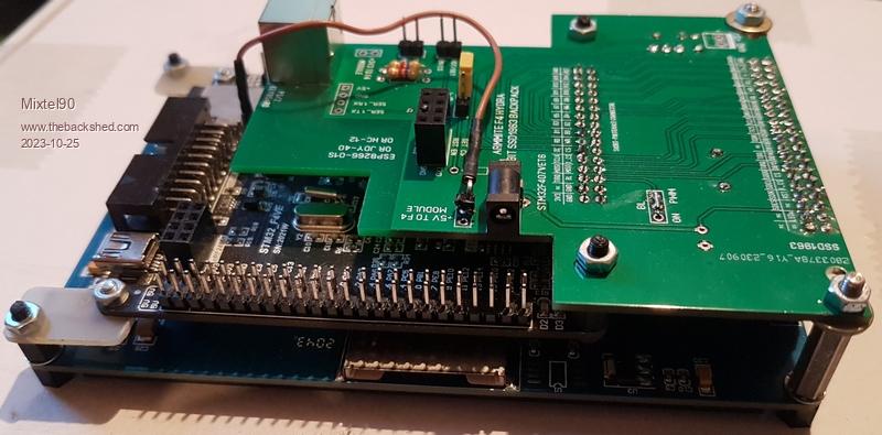

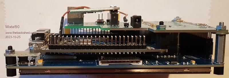

Ah, you've assembled it wrong. :( The display connector goes on the bottom of the board in your photo, so both connectors are on the same side. This sounds weird until you look at he final assembly.
These pics are of the prototype. As I said, I haven't got an IPS display or a Hydra 40-80 board. It's the same idea though. The shape of the Hydra board lets you get to the pins of the Armmite F4.
The component silkscreen goes to the top of the assembly when the display is lying face down on the table, as shown in your pic.
5V from the Armmite F4 is best picked up from the serial port connector 5V pin via a link wire to the serial port on the Hydra. (Innermost pin, next to the diode, between the PS/2 and audio connectors). With this connection in the whole system is powered from USB. This is the brown Dupont wire shown in the pics of the prototype.
Spacers used in the above assembly are 5mm (6 off) for the end and front, 11mm (2 off) for the F4-Hydra join and 18/19mm (2 off) for the Hydra-display join. I used 18mm for the latter but had to pad it a little with washers to get the F4 parallel to the display.

Okay makes sense when you see it,although it is "backwards" to the way the 3.2inch ILI9341 parallel display and lizby's adapter board are arranged. I should have read the instructions for your original Hydra more carefully. Typically for me just proceeding with what I thought made sense! Fortunately I have 4 more boards left and now I need to source the long tail female connectors to attach to the display.
Thanks for the clarification.
