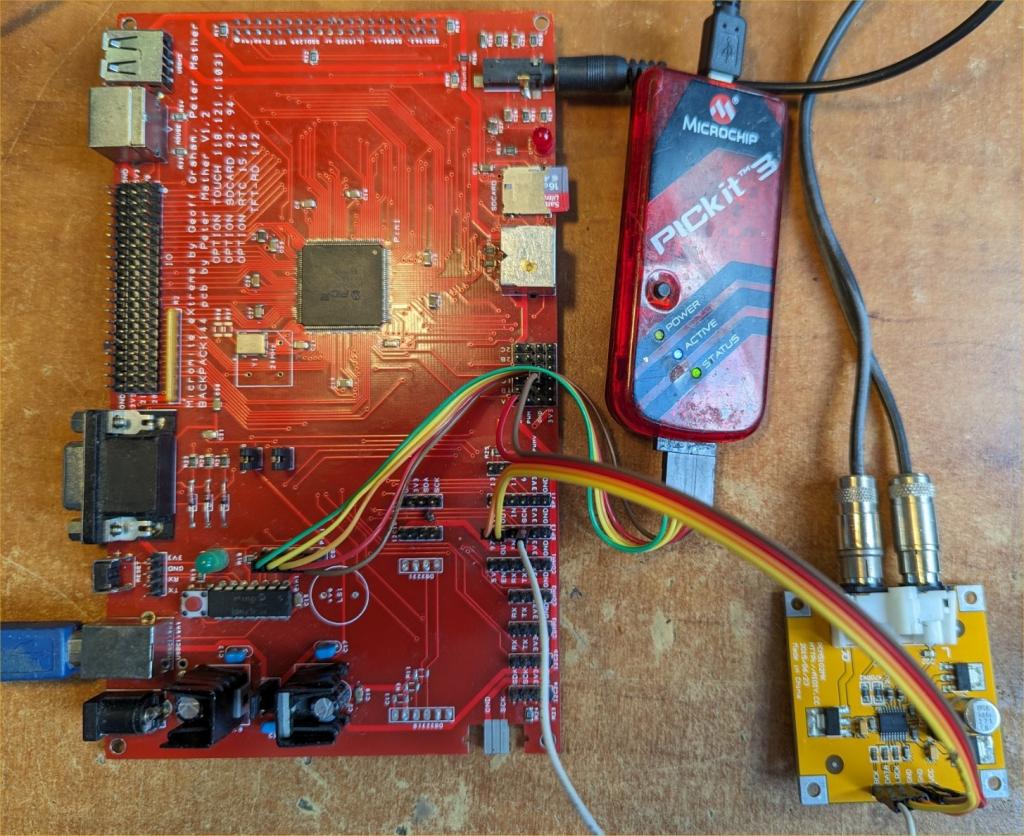

Big changes
Complete re-write of the audio code. This is now the best platform for audio of all MMBasic ports
Supports via 12S,
Flac playback: PLAY FLAC_I2S fname$
mp3 playback: PLAY MP3_I2S fname$
wav playback: PLAY WAV_I2S fname$
mod file playback: PLAY MOD_I2S fname$
Supports via PWM
Flac playback: PLAY FLAC fname$
mp3 playback: PLAY MP3 fname$
wav playback: PLAY WAV fname$
mod file playback: PLAY MODFILE fname$
Tone command: PLAY TONE LFREQ, RFREQ [,DurationInMsec]
Sound command: As per PicoMite manual
SAM Text-to-speech PLAY TTS string$
Flac, wav and mp3 playback (both variants) all support playing an entire directory, just use a directory name instead of a filename. PLAY NEXT, PLAY PREVIOUS allow you to step through tracks
I2S playback is rated up to 24-bit 192KHz
MMX-144 wired for I2S playback.
Bit-clock SPI3-CLK (pin 98)
Data SPI3-OUT (pin 96)
L/R word clock SPI3-SS (pin 97)
Master clock (if required) SPI3-IN (pin 99)
MMX-100 wired for I2S playback.
Bit-clock SPI3-CLK (pin 69)
Data SPI3-OUT (pin 67)
L/R word clock SPI3-SS (pin 68)
Master clock (if required) SPI3-IN (pin 70)
MMX-64 wired for I2S playback
Bit-clock SPI3-CLK (pin 29)
Data SPI3-OUT (pin 45)
L/R word clock SPI3-SS (pin 30)
Master clock (if required) SPI3-IN (pin 11)
NB: the i2S dac pictured won't run on 3.3V - needs 5V

I really can't understand this. The weather's not been *that* bad, surely?
Excellent work (again), Peter. :)

I got pickit3 and gcb extended but not a clue but looks clever

Well, this took me a while to sort out.
I connected the i2S DAC that arrived a couple of days ago - looked very much like the one shown in this thread and then tried to play an .MP3.  Nothing...! I checked my connections.  No issue.  4.98v on VCC.  I re-checked the connections just in case a connector was faulty - from actual pins 96,97,98 on the MMX chip to the solder joints on the i2S board.  All seemed okay. My conclusion; the board must be faulty.
Very frustrated, I looked on Amazon for a next-day delivery PCM5102 DAC and it arrived at lunchtime (a Dollartek product*).  Wired it in and...silence!  Unlikely to be another faulty board, but not impossible.  Again a forensic check on my wires and all seemed okay.  Could it be?  I loaded the Extreme with the old firmware** and, to my astonishment, the music played.
The innovative i2S seems not to be operative in this last firmware version.  Help?
**Edit: very old firmware -5.05.04 - it just came to hand in MMFlash folder.  I have been using 5.05.09 until this new round.
*Edit: the one on the slow boat from China was much cheaper!
