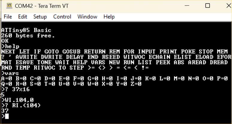

Posts: 12074
Posted: 04:38pm 27 Jul 2023
Here is the latest (final?) version of the firmware. Simplified the source and sone performance improvement.
ATTiny85.zip
New commands
VARS 'list the values of all variables (code from Volhout)
HELP 'list all valid commands, functions, and operators (code from Volhout)
WITWOC addr, data
e.g. WI.104,0 'write to DS1321 RTC to point to the seconds register
New Function
RITWOC(addr)
e.g A=RI.(104) 'read the register on the DS3231 previously set up
New Operator
e.g.
B=A%16 'B = A MOD 16
Source
ATTiny85.zip
Edited 2023-07-28 02:41 by matherp

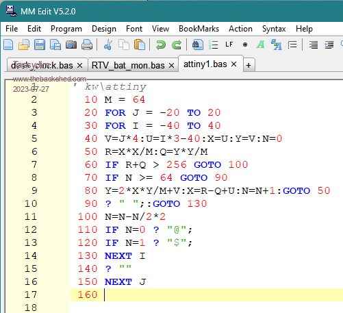

Posts: 6631
Posted: 01:17am 29 Jul 2023
MMEdit is progresing well.
Go from this:
  Quote  1 M=64:F.J=-20TO20
2 F.I=-40TO40
3 V=J*4:U=I*3-40:X=U:Y=V:N=0
4 R=X*X/M:Q=Y*Y/M:IFR+Q>256G.8
5 IFN>=64G.7
6 Y=2*X*Y/M+V:X=R-Q+U:N=N+1:G.4
7 ?" ";:G.13
8 N=N-N/5*5:IFN=0?"@";
9 IFN=1?"$";
10 IFN=2?"#";
11 IFN=3?"%";
12 IFN=4?"&";
13 N.I:?:N.J
to this:
  Quote    10 M = 64: FOR J =-20 TO 20
20 FOR I =-40 TO 40
30 V = J*4:U = I*3-40:X = U :Y = V :N = 0
40 R = X*X/M :Q = Y*Y/M : IF R+Q >256 GOTO 80
50 IF N >= 64 GOTO 70
60 Y = 2*X*Y/M+V :X = R-Q+U :N = N+1: GOTO 40
70 ? " ";: GOTO 130
80 N = N-N/5*5: IF N = 0 ? "@";
90 IF N = 1 ? "$";
100 IF N = 2 ? "#";
110 IF N = 3 ? "%";
120 IF N = 4 ? "&";
130 NEXT I : ? : NEXT J
and back again.
You can edit in either mode.
I need a few more sample programs to test with. Preferably ones that can be copied and pasted, not retyped.
A question. Is there a preferred line ending? CRLF or LF alone and do the line endings count as characters?
I will be happier once I have the chips and programmer in a weeks or two.
Plenty of real life issues to keep me busy until then.

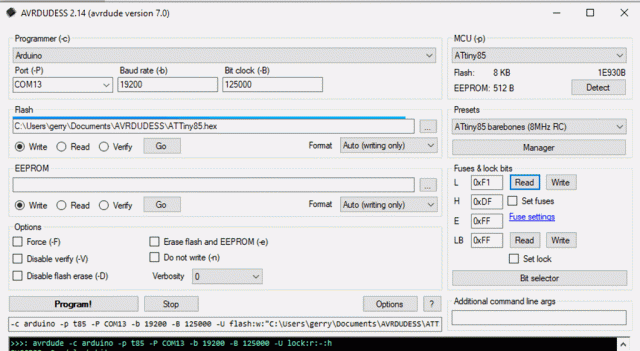

Posted: 10:34am 30 Jul 2023
For those that don't like using the command line, I have successfully used this GUI front end for AVRDUDE. It sets all the fuses so just read them in before you set/change the ones you want to actually change.
I did a portable install into a directory and placed the ATTiny85.hex in there as well.
AVRDUDE GUI interface
