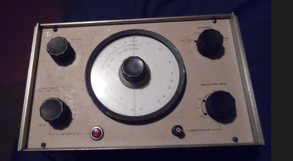

Posted: 01:54pm 22 Jun 2023
Nostalgia isn't what it used to be and reminded of the bulb.
The gen I posted is an Advance and over 50 years old but still works. Thought the caps dried out by now.
