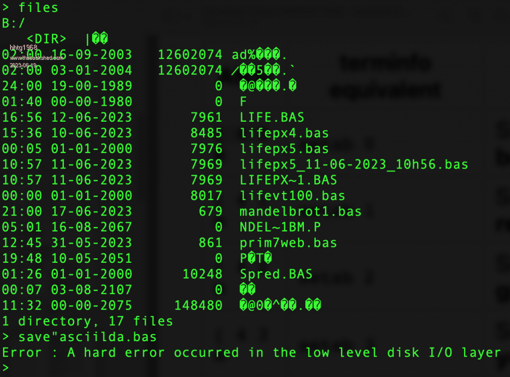

hello again.
meanwhile the sd card reader runs.
but not always. from time to time occur errors like "sd card not found" etc. if i restart the picomite or eject an enter the sd card it mostly functions.
sometimes occurs a "hard error" and it is more complicated to save data (via pc or mac)
here is an image...
hhtg1968
Joined: 25/05/2023
Posts: 256
Posted: 06:51am 19 Jun 2023
... and there are strange symbols in the directory, and strange files and filesizes...
hhtg1968
Joined: 25/05/2023
Posts: 256
Posted: 06:52am 19 Jun 2023
on my mac you cannot see this strange data!

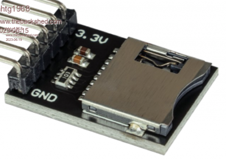

IanRogers
Joined: 09/12/2022
Posts: 152
Posted: 07:10am 19 Jun 2023
That's exactly what mine was doing.
I just bridged out the inline resistors.  Check if your SD slot has any inline resistors.  Any bought from the web normally have 1k (102) but mine had 10k (103) and was far too large for the application.

Posts: 9252
Posted: 07:51am 19 Jun 2023
Also - you can use *any* pins for a SD card. They don't have to be specific SPI pins. It may be worth trying it elsewhere.

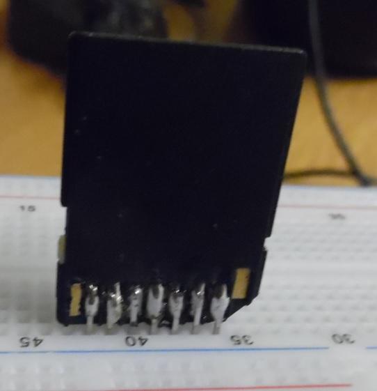

Posted: 12:28pm 19 Jun 2023
the reader is shown in this topic above. here a smaller image...
it is connected via breadboard with long cables - 20-30cm -...
i have the problems at all picos, picomiteVGA and "normal" picomite (here is only the sd-card reader connected (the picomiteVGA has VGA, SD card reader, ps/2- keyboard, rtc etc...
the problems occur more often at the picomiteVGA...
i have tested the connections several times, mostly all is running but not always.
Posts: 9252
Posted: 12:51pm 19 Jun 2023
I've just compared it to the ones I've been using, and which I've proved to work, and it's not the same. Both *seem* to have 4x 10K pullup resistors (but mine are separate, not in a pack) and supply decoupling capacitor (but mine only has one rather than two).  It might be an idea to check that those resistors actually are pullups and aren't in series with the data lines. If they are in series then you are lucky that the adapter is working as well as it does now!
Long cables are no use at SPI speeds. No more than about 10cm absolute maximum from the pico to the card holder IMHO. You may get away with it for a LCD display, but just a single bit error on a SD card gives corrupt data.
If you're having problems with more than one PicoMite then I'm starting to wonder about your power supply, although if it's USB from a PC it *should* be ok. Have you got a powered hub that you could use to feed it? Or you could feed a separate 5V into VSYS via a diode to isolate it from the USB power. That would make sure that that problems with the  USB power supply wouldn't cause a problem. Note that some USB leads are truly horrible when it comes to volt drop!

Posted: 09:46pm 19 Jun 2023
I soldered the sdcard adaptor but not tried yet. I smelt burning plastic.

Those SD/uSD card modules are a REAL landmine.  AVOID! AVOID! AVOID!
I have lost count of how many people have TRIED those modules, and they more often then not WON'T work, cos of the extra electronics on the board.
If you want to connect an SD card or uSD card to the PicoMite or PicoMite WEB, then you MUST DIRECTLY CONNECT.
The ONLY extra circuit you need, is the 2R2 resistor feeding the 10uF and 100n filter arrangement on Vcc.
ANYTHING other then that, causes issues.
In all my designs(about ten PM ones so far), I have DIRECTLY connect the PM pins to the SD card connector, and it NEVER fails to work from the very first attempt.
The issue that is cropping up, is that the Chinese modules that can be had so cheaply, include components that simply are not needed with the PM, and this seems to be seriously screwing with how the SD or uSD cards work with the PM, when you use said modules.
Look for SD/uSD modules that have NOTHING AT ALL - other then the SD/uSD card socket itself on the board.  A "Breakout" board that only routes out the pins to a more happy pin-spacing, but that adds ZERO extra parts.
