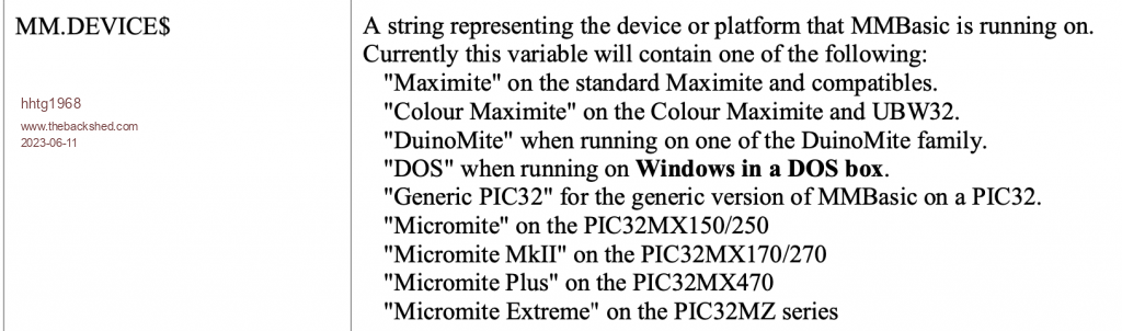

that means if v$ has another content the program caches not and so on. i do not know the
mm.device$
exactly for mmb4w. it could be "DOS". look at the foto...
but exists versions for dos and another for windows? in the manual from the dos version i cannot find any graphic commands...

MM.DEVICE$ from the MMB4W manual.
  Quote  "DOS" when running on Windows in a DOS box.
“MMBasic for Windows” when running in Windows 10 or later
"Generic PIC32" for the generic version of MMBasic on a PIC32.
But I would not worry about it until or if you have MMB4W running.
Sorry about my 'wolf' comment, it is there I was wrong.

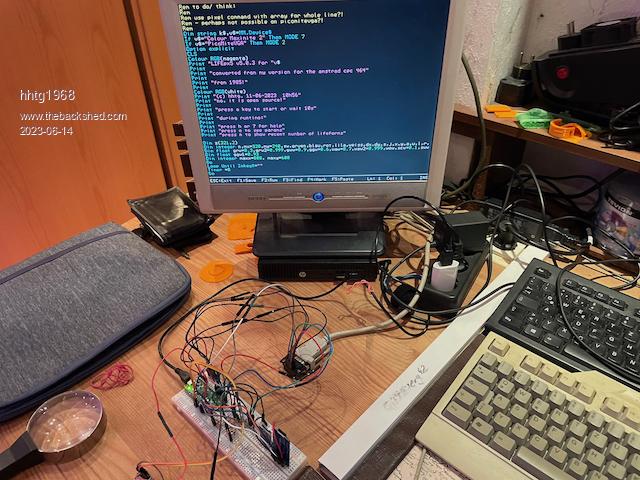

about one hour ago i started my (first) picomiteVGA!
now i must recognize that my simulation does not run 100%. i will change it...
here is an ascii version...
