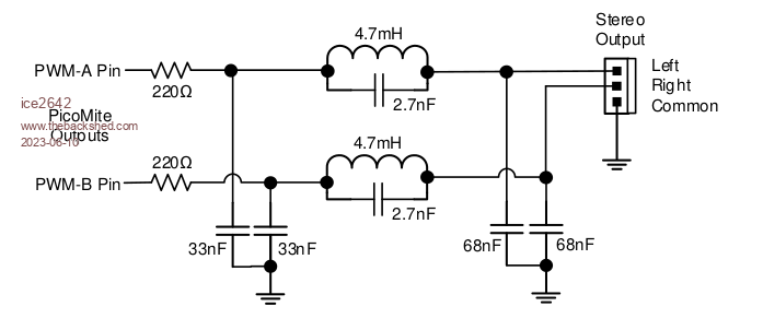

This board as without sound, and I plan to build a little breakout board low pass filter using the scheme from manual.
I am not very well knowledge in electronic, I know the basic of basic. Just to play with arduino and this things.

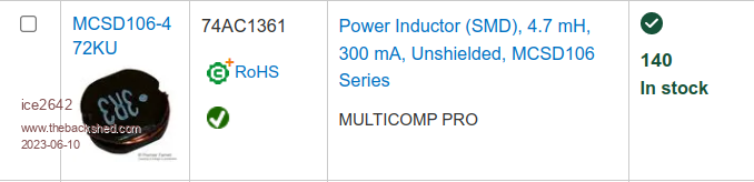

May question is, is it the high type of inductor listed in the scheme?
If yes, this is a good one or I can have best options?
Second, the 33nf and  68nf in schema is it a capacitor? if yes, ceramic or what kind and with how much V?
and about resistance, 220(the omega watch symbol)  when buy is the label 220R?

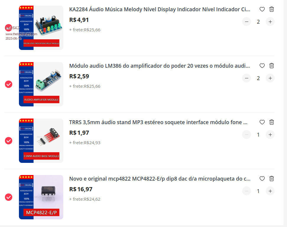

I found the MCP4822 maybe it will be best than a LPF.
how is the best way to make a breakout board using this list plus the resistors to all work?

For the actual I2C DAC all you need to mount is the chip, 2 resistors and 2 capacitors (although I'd recommend a resistor and capacitor to filter the supply as Peter did on the V1.1 board). That board will then pick up GND, 3V3, CS, MOSI and SCK from your Pico board. If you get a suitable connector you *might* be able to make it into a module that fits whatever GPIO connector is on your Pico board. It would then have GND, Left and Right running to your amplifier. It might be an idea to make this a 3.5mm jack but you don't have to.
I can't really advise much else as it will depend on exactly what you are trying to do and what you already have available, as well as whatever constructional skills you have.
Posted: 08:17pm 09 Jun 2023
  ice2642 said  the 33nf and  68nf in schema is it a capacitor? if yes, ceramic or what kind and with how much V?
Yes, capacitors. I guess any kind that's cheap (so will be ceramics I reckon) and it's low voltage so whatever you get will be fine I suspect.
  ice2642 said  220(the omega watch symbol)  when buy is the label 220R?
Yes.
Don't know about the inductor, sorry.

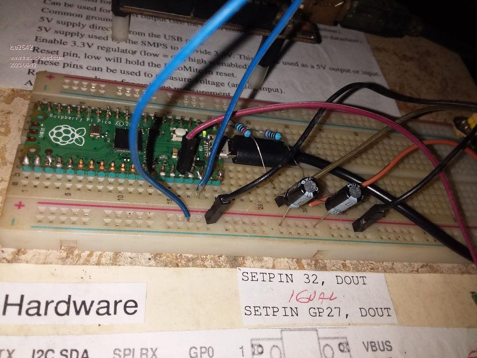

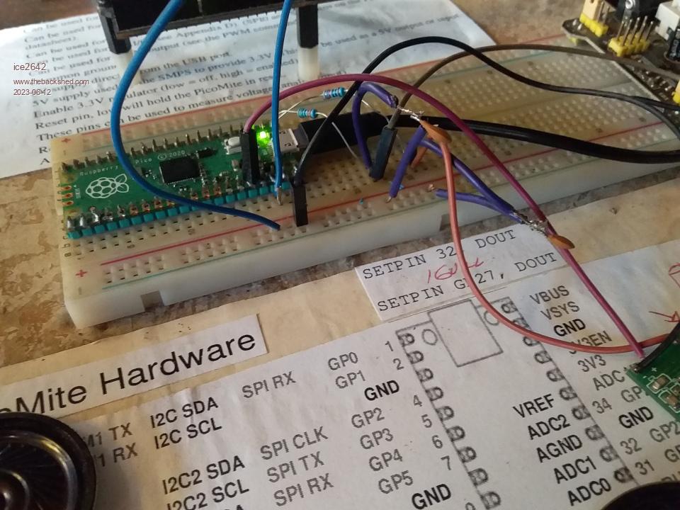

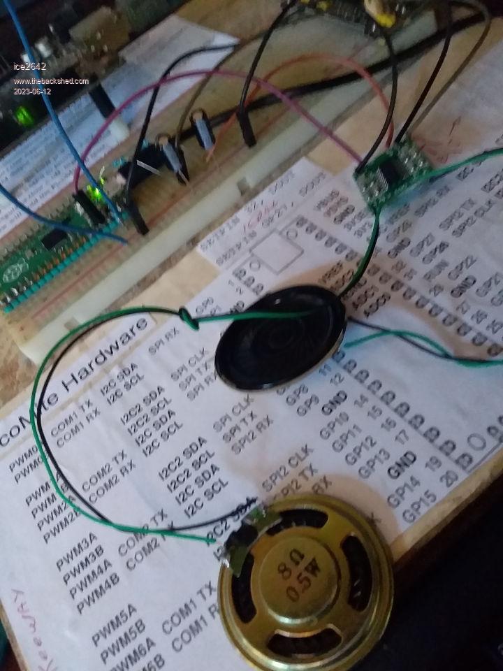

Posted: 03:51pm 11 Jun 2023
Hi friends,
Just for testing while the components do not arrive, I assembled it with some components that I had here using approximation in the calculation fc=1/2pi r c and it suppressed the noise well.
But it was popping in cycles of approximately 0.5s
Knock Knock Knock....
Just for an intellectual exercise, what could be generating these pulses, I don't have an ocilloscope here to send more data about the wave.
Pictures of the mess follow.

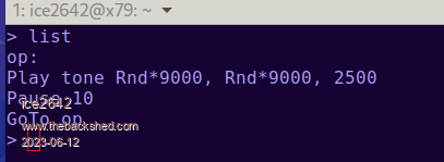

The litle code for making tones.
Thanks.
Edited 2023-06-12 01:53 by ice2642
MMBasic 5.0707 on PicoMite VGA
Posts: 9252
Posted: 04:15pm 11 Jun 2023

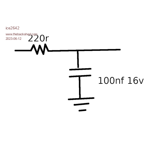

1)  The capacitors that you've shown are electrolytic types - probably 100uF 16V. These are *far* too big in value, you want 100nF which are usually ceramic or polyester types.
2) Even with the correct values a single pole RC filter won't reduce the 44kHz carrier frequency by much because it's at such a high level when compared to the extracted audio signal. It's ok for quick experimenting on the bench, feeding something like a 35R headphone earpiece (but you'll need a series resistor of about 1K because it will be too loud). You could also use it with an amplified desktop speaker but you may need a volume control to prevent overload. Do not use it with a half decent amplifier and speakers that contain tweeters as something may get damaged.

Posted: 04:51pm 11 Jun 2023
  Mixtel90 said  1)  The capacitors that you've shown are electrolytic types - probably 100uF 16V. These are *far* too big in value, you want 100nF which are usually ceramic or polyester types.
Thank you.
I need wait the correct capacitors arrive, here I just have this used.
