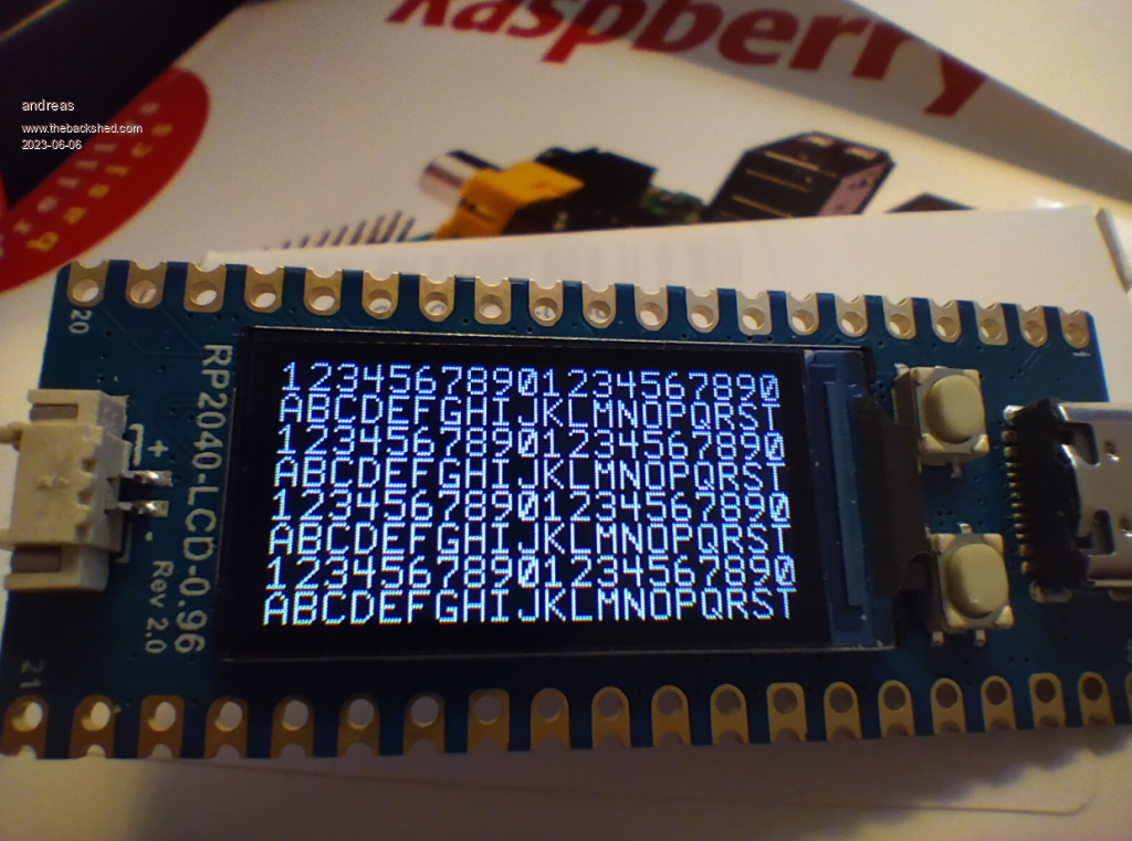

It is not possible to use GP12 within LCDPANEL as RST - PicoMite complains that Pin GP12 is already used within System SPI. That was the reason I tried GP0
This costs me hours and finally, before giving up, I tried GP0 in that place.
Without any settings on standard text output I count 20 chars by 8 lines on the display.

I did reset the options and tried it, but PicoMite refuses that:
> option list
PicoMite MMBasic Version 5.07.07
> option SPI GP10,GP11,GP28
Error : Invalid Option
bug or feature?
-andreas

Yepp! works!  (SETPIN GP28,OFF comma was missing)
> option list
OPTION SYSTEM SPI GP10,GP11,GP28
OPTION HEARTBEAT OFF
OPTION LCDPANEL ST7735S, LANDSCAPE,GP8,GP12,GP9,GP25
> cls
> backlight 10
> cls rgb(red)
> works!
Thank you Mick!
-andreas

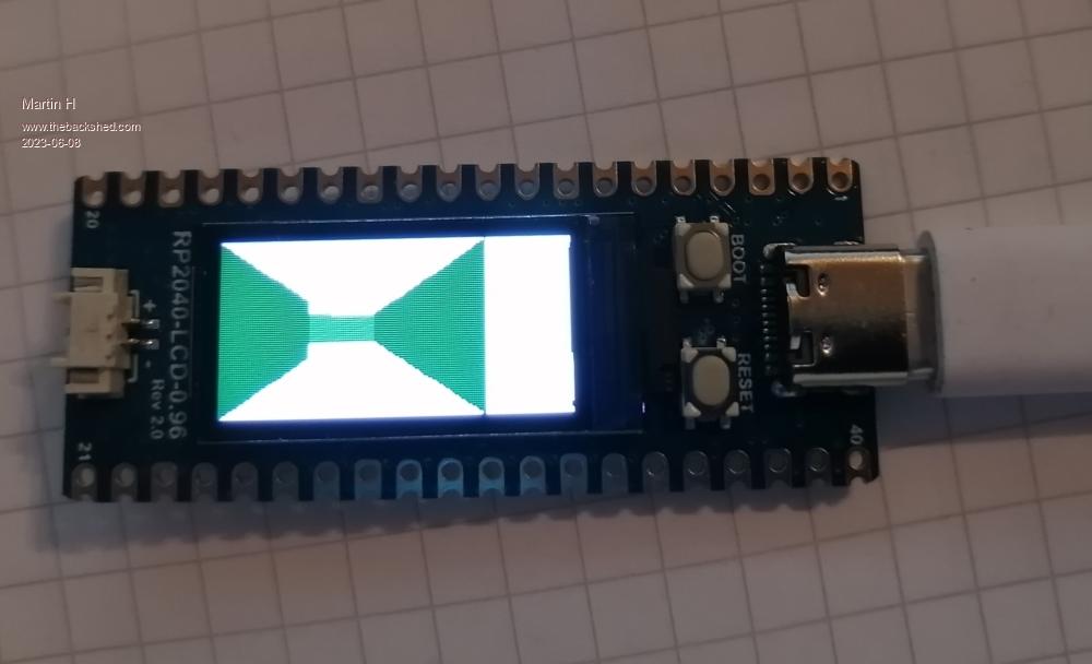

Andreas,
Mine has just been delivered. With the settings you posted it worked immediately.
Thank you
(my old eyes just have trouble reading the small display)

  Mixtel90 said
Like the mini-maze! :)
for the 160x80 Display

     'Blocker
      Triangle x1%,y1%,120-x1%,y1%,120-x1%,y2%,WallC2%,WallC2%
      Triangle x1%,y1%,120-x1%,y2%,x1%,y2%,WallC2%,WallC2%
Sub show_maze
For y% = 0 To MazeH%
  For x% = 0 To MazeW%
      If Maze$(x%,y%)="#" Then Box 122+x%*1.5,3+y%,1,1,,0,0
  Next x%
Next y%
' --- 2D Maze generator ---
' algorithmen based on
' https://rosettacode.org/wiki/Maze_generation#BASIC256
Sub generator
Local done%,i%,CurX%,CurY%,OldX%,OldY%,x%,y%
' initial start location
CurX%=Int(Rnd * (MazeW% - 1))
CurY%=Int(Rnd * (MazeH% - 1))
' value must be odd
If CurX% Mod 2=0 Then Inc CurX%
If CurY% Mod 2=0 Then Inc CurY%
Maze$(CurX%, CurY%) = " "
' generate maze
done%=0
Do While done%=0
    For i% = 0 To 99
      OldX%=CurX%
      OldY%=CurY%
      ' move in random direction
      Select Case Int(Rnd*4)
          Case 0
              If CurX%+2<MazeW% Then Inc CurX%,2
          Case 1
              If CurY%+2<MazeH% Then Inc CurY%,2
          Case 2
              If CurX%-2>0 Then Inc CurX%,-2
          Case 3
              If CurY%-2>0 Then Inc CurY%,-2
      End Select
      ' if cell is unvisited then connect it
      If Maze$(CurX%,CurY%)="#" Then
          Maze$(CurX%,CurY%)=" "
          Maze$(Int((CurX%+OldX%)/2),((CurY%+OldY%)/2))=" "
  Next i%
  ' check if all cells are visited
  done%=1
  For x%=1 To MazeW%-1 Step 2
      For y%=1 To MazeH%-1 Step 2
          If Maze$(x%,y%)="#" Then done%=0
      Next y%
  Next x%
' --- WallData (160x80)---
Data  0, 0, 0, 80, 5, 3, 5, 76
Data  6, 4, 6, 76, 25, 17, 25, 63
Data  26, 17, 26, 63, 40, 27, 40, 53
Data  41, 27, 41, 53, 50, 33, 50, 46
Data  51, 34, 51, 46, 55, 37, 55, 43
Data  56, 37, 56, 43, 60, 40, 60, 40
"Cursor" to move
"M" Shows the Maze (not so usefull)
'no comment
