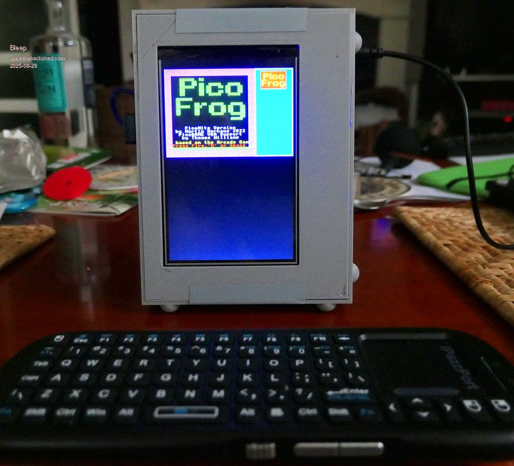

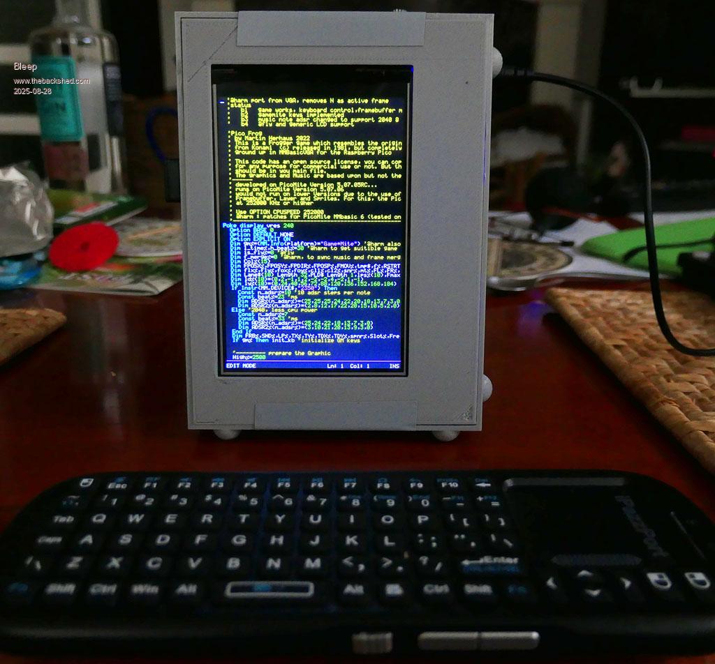

Posted: 06:37pm 27 Aug 2025
Hi Harm,
I've got my new portable MMBasic console running and with the tip that Peter gave me about limiting resolution, it's running Pico Frog, with music at the correct speed, it would almost do it, at full screen, but once I limited it, it's now looking and sounding good.
The box is 3D printed, poorly :-( and the mini keyboard is wireless USB, obviously I'll use a proper keyboard for editing....
Internally it's based on Peters original V1.0 HDMIUSB board, but I've modified it to drive a ST7796S LCD, and incorporated a Lithium Battery charger/monitor, with 2X 18650 3Ahr batteries, as ballast down the bottom, so it'll run for quite a long time :-)
Anyway, as long as the resolution bodge continues to works ok, I should be able to test 240x320 or 480x320 games reasonably easily, plus I get a lot of lines in the editor, ;-) and now I can view lines longer than a screen width easily, it's very functional. :-)
Regards Kevin.
Next job is to swap the 2040 to a 2350 on my game*mite, easier said than done :-(
Edited 2025-08-28 05:14 by Bleep

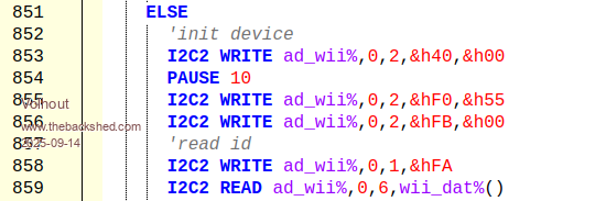

Posts: 6195
Posted: 06:20am 14 Sep 2025
Kevin,
Could you please do a test for me ? In below section of the code:
Could you comment out lines 855 and 856, and increase the PAUSE to 100ms ?
Lines 855 and 856 are turning off encryption on the nunchuck, and in my case (with the clone classic controller I have) that works.
The classic controller encryption is turned off by line 835. But it may get confused by 855 and 856, -or- it needs another delay before requesting the ID.
P.S. just OPEN WII is sufficient for your test. When there is no controller identified it is shown in the error message. I tried using OPEN WII and OPEN NUNCHUCK WII but could not make it work automatic and transparent, hence I wrote a clumsy work around. That is not working for you yet.
Edited 2025-09-14 16:23 by Volhout

Bleep
Joined: 09/01/2022
Posts: 864
Posted: 09:34am 14 Sep 2025
Hi Harm,
Thanks for the pointers, with a bit of playing around I have got it to work, by removing the 2 lines you sugested, increasing the pause to 100 didn't make any difference, however adding an extra Pause 10 just after the second I2C2 Write, fixed it, as per the code below. I did try putting the 2 lines back, after I had added the  extra Pause, but that stopped it working again. As far as I know my controler is a genuine Wii controler, not a clone.
   Else
     'init device
     I2C2 write ad_wii%,0,2,&h40,&h00
     Pause 10
'      I2C2 write ad_wii%,0,2,&hF0,&h55
'      I2C2 write ad_wii%,0,2,&hFB,&h00
     'read id
     I2C2 write ad_wii%,0,1,&hFA
     Pause 10
     I2C2 read ad_wii%,0,6,wii_dat%()
   End If
I also noticed in this piece of code, in Case "I2C", you then do I2C2 Read, is this a copy and past error, or correct? the iic_wii% is being correctly set to 1 or 2.
 'find I2C port
 Select Case MM.Info(system i2c)
   Case "I2C2"
     iic_wii%=2 : I2C2 read ad_wii%,0,1,dummy%
     If MM.I2C=0 Then is_wii%=1  'we have a device at wii address
   Case "I2C"
     iic_wii%=1 : I2C2 read ad_wii%,0,1,dummy%
 End Select
Regards, Kevin.

Posted: 01:02pm 14 Sep 2025
The
Case "I2C" with I2C2 read ...
does look like a typo.
dddns

Posts: 6195
Posted: 06:15am 15 Sep 2025
Thanks Kevin, that is very helpfull.
I will make related changes.
