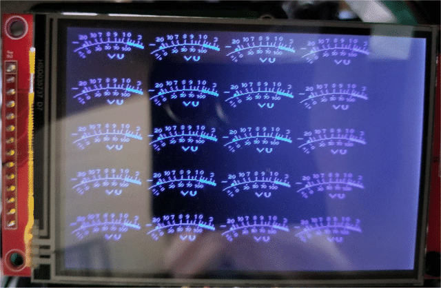

@asknik2022 your code works perfectly on my LCD. The blue VU sprite can be quickly "blitted" to anywhere on the screen.
So it seems you are still not able to read back pixels from the screen.
@vegipete's "fontified" version also works perfectly.
Here is a test program for the LCD

Thanks for the code. It works for me. Here it is on a ILI9488, BLITted 20 times. I replaced your BLIT READ and BLIT WRITE with this:
Blit read 1,0,0,100,60
Pause 1000
For i=0 To 3
 For j=0 To 4
   Blit write 1,i*100,j*60
 Next j
Next i
End

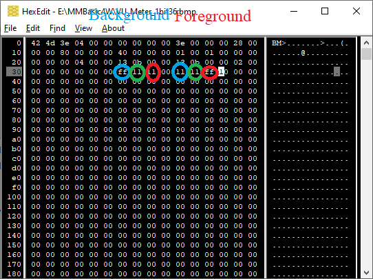

The BMP format supports 24 bit background and foreground colours for 1 bit / pixel images. Most viewers, including MMBasic will display them correctly however most editors only allow black and white.
You can use a hex editor to change the relevant bytes to get any colours.
Hex Byte numbers (starting from &H00)
              Blue     Green     Red
Background      36       37       38
Foreground      3A       3B       3C
Values can be 00 to FF
Edited 2023-04-24 11:25 by phil99
