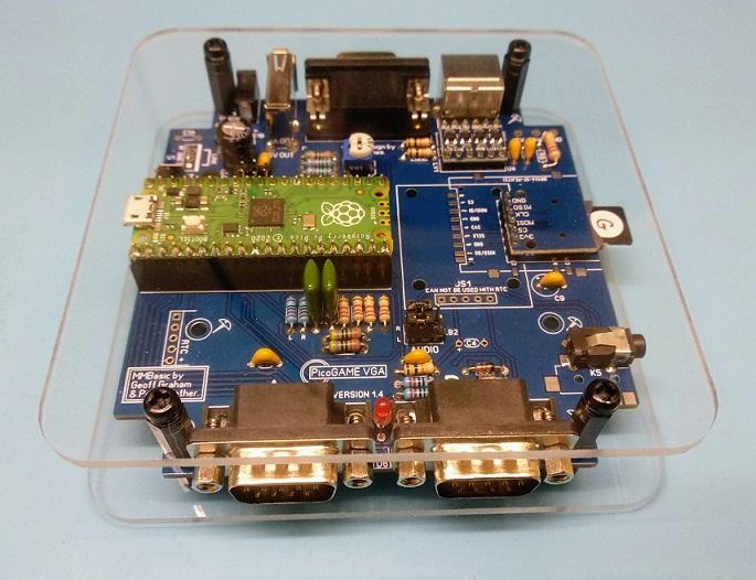

I'd like to say that I think @Mixtel90's PicoGAME VGA (in an acrylic enclosure by @bigmik) is a thing of beauty. It can take two NES/SNES/Atari controllers without any additional dongles, soldering, cutting, criming, biting or mauling and with 4 rubber feet is pretty mechanically stable too.
If future PicoMite VGA PCB designers (other than one-offs) want game controller support and want to show compassion for the poor programmers then I would suggest a minimal arrangement of one or two NES compatible ports:

  Mixtel90 said  I really must build up this PicoGAME 2.0.
Same here, the picture is a 1.4.

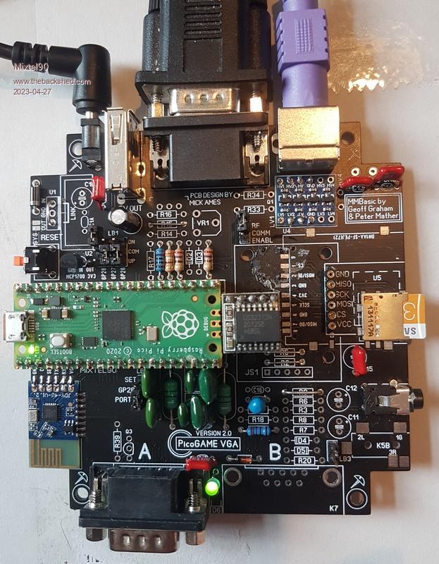

I've been digging out bits and soldering. :)
The audio capacitors are still elusive, but I've not searched for those yet.
VGA connector missing
2off DB9 connectors missing
5off push-on links missing
This build is going to be a bit special (at the moment anyway)
Port A is standard, but GP26 and GP27 will be used for the RTC, so no analogues.
Port B has no joystick socket or other components fitted. Up/down/left/right/fire GP pins all connected directly to  the GPIO pins of the JDY-40. These inputs are active high.
A simple joystick will produce active low inputs to another JPY-40, battery operated. This gives an Atari-type input. Unfortunately the JDY-40 inverts the signal and there's no way to make the inputs to the PicoMite active low without introducing inverters, but never mind. The transmit end is in low power standby until an input goes low, then the input is transmitted. 8 inputs are available (or 7 if you want a transmit LED) but not enough pins on the PicoGAME. Should be interesting. :) This is using the bit IO function of the JPY-40 as otherwise there is a significant constant current drain (40mA) by the transmitter.
I tried another YD-RP2040 today. That wouldn't run at 252MHz either. :(  Not recommended for VGA builds, I don't think.

I've got most of the bits on the V2.0 board now. I have a RTC with a dead battery so I'm going to superglue a battery holder onto the PCB. :) Not sure whether to put it on the top or the bottom... In the meantime I've nicked the PicoMite & RTC off the 1.4 board.
The V2.0 powers up and no smoke. :) VGA & PS2 keyboard working.
Need to get things set up now.

Here's the V2.0 before I start rigging up the wireless. The audio output caps are still missing as I need to get some from the shed. The power LED will eventually be changed for a red/blue LED (on order) so that green one is just pushed into the holes.
