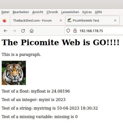

last easter days I played with WebMite and wanted to see the web-demo running showing the tiger, but I did'n succeed. I saw the webpage and the values, but not the tiger. The firefox browser was constantly spinning as if the transfer had not finished.
I modified the demo a little and found that the lion picture "small" needs a "/" as prefix to show up correctly, stop the transfer etc. Now it runs as expected.
And here is the modified program:

Many thanks for WebMite!!! Hope to get the manual soon
-andreas

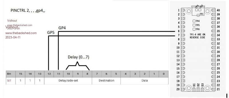

Something is not Okay with the PIO assemble when using a mix of DELAY and SIDE SET (unless I am mistaken).
PIO assemble 1,".program NES"
PIO assemble 1,".side_set 2 opt"
PIO assemble 1,".line 0"
PIO assemble 1,"PUSH [&b01,7]" -> 2 side set pins should be &b01 and delay 7 (&b111)
PIO assemble 1,".end program list"
This should assemble to 100 01111 0000 0000 = &h8F00
                           ssddd
                     s=side set, d=delay
But it assembles to     100 00001 0000 0000 = &h8100
                           ???ss
(delay field is filled with side set information, and side set field is empty)
This seems also valid for other instructions that use side set. I also tried without the "opt" parameter, but that does not change.

Your syntax is wrong twice
First you can't have "opt" and 2 sideset and 3 delay = 6 bits!
Without the opt the syntax as per the RP2040 datasheet should be:
PUSH side 1 [7]
At the moment side does not accept & construct - will add in next beta

You cannot use &h or &b in side set.
Not a major issue...
Posts: 12081
Posted: 11:57am 11 Apr 2023
  Quote  You cannot use &h or &b in side set
You will be able to in RC4/relese
