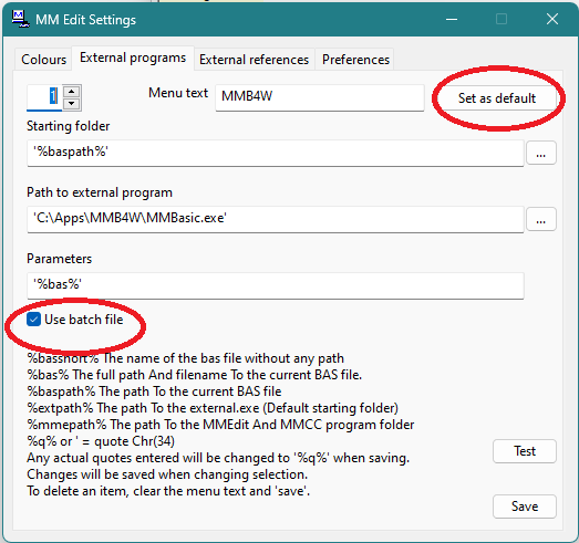

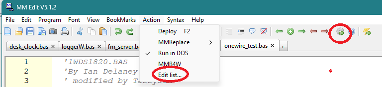

Setting up MMB4W in MMEdit is the same as any other external program.
From the "Action" menu, select "Edit"
This opens up the preferences window at the correct tab.
Using the spinwheel, select the first empty entry. This will usually be "1" as "0" is used for the DOS version of MMBasic.
Fill out the fields as shown with the path to your copy of MMB4W (The exe is named MMBasic.exe, the same as the DOS version)
Check the "Use Batch" tick box.
If you want this to be the default external program, select "set as default"
Select "Save"
To run your program in MMB4W, use the Action menu or, if it is set as default, the "Run Icon" (third from right) is more convenient.

Unless I've missed it somehow, there doesn't seem to be an explanation of the "Use batch file" option. I remember that with the previous version a batch file was used to associate the BASIC files with. Is that what this is for?
Posts: 6631
Posted: 05:21am 24 Apr 2023
  Turbo46 said  Hi Jim,
As usual, I have been slack with the documentation.
There is a batch file called runhere.bat in the program folder.
Depending on the mood of Windows and the program being called, using this instead of calling the external program directly sets the startup folder correctly.
ruhere.bat
rem run external program.
cd %1
%2 %3
rem alternative option
rem start "" %2 %3
All it does is change directories before running.
Supplying the batch file makes taming external programs less prone to throwing things at the computer.
File association works properly without the need for any funny business with V5.
