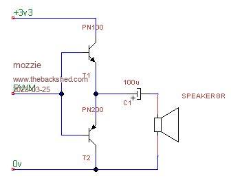

If the original question is the simplest / low cost / minimal approach to driving a small low cost / quality speaker from a Pico then a simple push / pull emitter follower with output cap works fine here
Yes its LO-FI
Yes there is a little hiss
Yes it may be outputting 44khz (but I cant hear it)
Yes the output is only about 2v p-p @ 40khz and the audio is below that
But it is simple
Lyle.
P.S. Just found Phil99's original post and that is an elegant solution:
https://www.thebackshed.com/forum/ViewTopic.php?TID=15362&P=3#194596#194596
with only a couple of extra components.

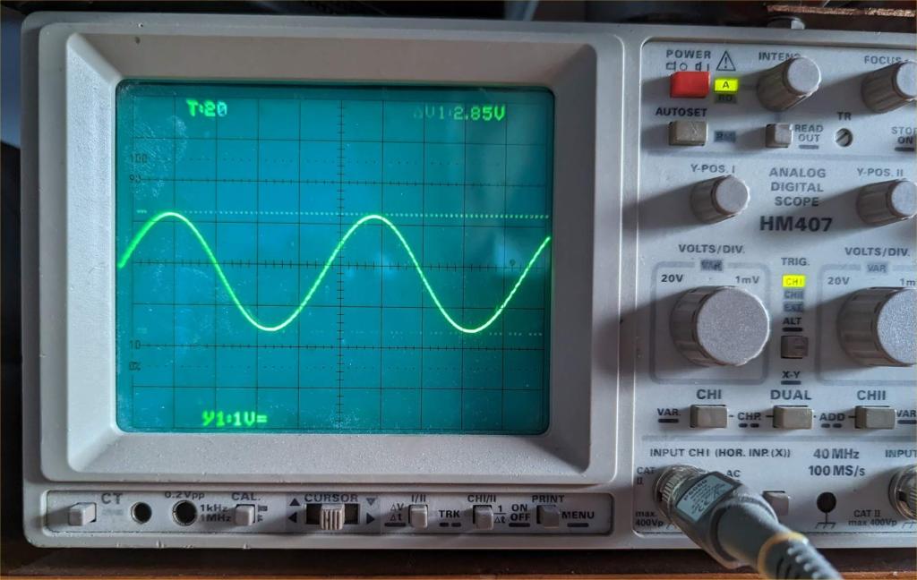

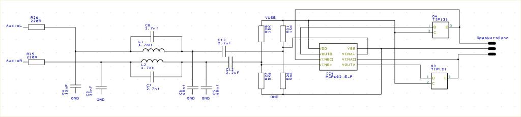

Posts: 12080
Posted: 01:19pm 25 Mar 2023
Here is a circuit tested in the silicon - none of this LT spice nonsense. Measurement is across an 8ohm load
No clipping.
Nice sinewave
Tested from 30Hz to 10000Hz
Edited 2023-03-25 23:22 by matherp

I'm not very knowledgeable on analogue electronics. However, the one thing I do know is that audio amplifier modules are likely to be unsuitable. We need amplification of current not voltage. Most audio amplifiers have voltage gains of 20 or even greater whereas we need a gain of not more than 5V/3.3V to avoid clipping and a horrible sound.
Posted: 02:14pm 25 Mar 2023
  matherp said  I'm not very knowledgeable on analogue electronics. However, the one thing I do know is that audio amplifier modules are likely to be unsuitable. We need amplification of current not voltage. Most audio amplifiers have voltage gains of 20 or even greater whereas we need a gain of not more than 5V/3.3V to avoid clipping and a horrible sound.
many amps are bridged like car amps so 4 times the power for same supply.

Posted: 02:24pm 25 Mar 2023
G'day Peter,
That scope shot certainly proves the filter circuit is doing a great job, I think I might need to order some 4.7mH inductors...
As you suggest, we need current gain rather than voltage gain, the emitter follower provides exactly that.
Did you measure the output into a speaker or a resistor? the 1.4v offset in the output is probably not going to go well with a speaker voice coil, they normally don't like anything more than a few mV, hence the reason for coupling capacitors in single supply amps (unless BTL)
A little off topic, are you planning to include the "p" and "n" (white noise) options for the play sound function in the next release of PicoMite MMbasic? they are handy for things like steam sound generators

Peter's circuit has the same problem that simple ones tend to do - they put the output current through the speaker. What that does is pull (or push) the cone away from its centre position so that it will start to bang against the pole piece (or come out of the pole piece) on peaks in the music. Those peaks will be a lot lower than its normal power handling rating. It's never a good idea to have this sort of thing happening. The answer is to use a power resistor as the load and then couple the speaker across it via a capacitor. Unfortunately that also brings problems. Half the power is lost in the resistor (so it runs hot) and there is less available for the speaker. Also, the value of the capacitor restricts the lowest frequencies that can be delivered.
Some headphones simply won't handle any amount of DC through their coils and distort horribly if there is more than a mA or two. That's because the diaphragm moves such a short distance anyway.
mozzie's PNP/NPN circuit may be a better bet. Something similar, with a biasing arrangement anyway. It might be better to run it from 5V and use a third transistor (common emitter) to drive the output pair. It does start to get a bit bulky though, as do heatsinks for class A. :)

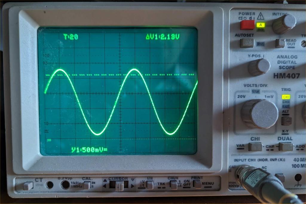

Posts: 12080
Posted: 04:52pm 25 Mar 2023
  Quote  Nice analog scope….
Thanks. Hameg HM407 Analog with digital storage as well
  Quote  are you planning to include the "p" and "n" (white noise) options for the play sound function in the next release of PicoMite MMbasic?
Yes
  Quote  Did you measure the output into a speaker or a resistor? the 1.4v offset in the output is probably not going to go well with a speaker voice coil, they normally don't like anything more than a few mV, hence the reason for coupling capacitors in single supply amps (unless BTL)
Now fixed as per Mixtel's change so no more DC offset and waveform across speaker just as good (1000Hz)
Note change of bias resistors - now 12K to GND and 15K to 5V
Check out the recording in the post above
Edited 2023-03-26 02:53 by matherp

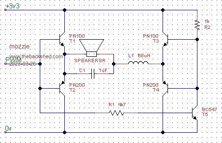

Posted: 05:07pm 25 Mar 2023
Sounds good Peter
Considering the audio output from the Pico is virtually identical to a Class "D" amplifier (at lower frequency) I still think for direct drive of a speaker we are better off simply buffering it for more current drive and applying a little filtering before the speaker, this means no biasing and the transistors are always on or off so no heat generation. This is ok for the LO-FI side anyway.
This is the bridge version of the one above, although its starting to get more complicated than an integrated amp
It does a very good job with steam sound effects and tones, I'll have to sort out some music to try to see how it does.

Posts: 9252
Posted: 05:21pm 25 Mar 2023
But the inductor alone is almost the size of the LM4871...
And I ordered 10off LM4871 for 3.04 UKP including postage.
